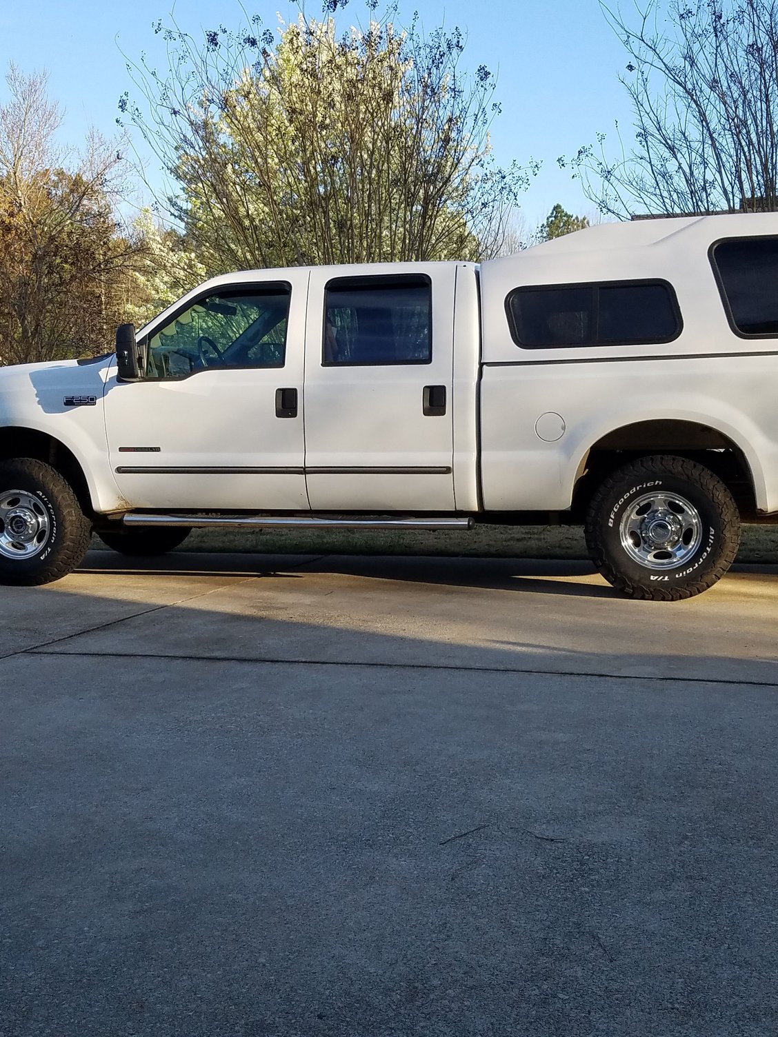

Originally Posted by KubotaOrange76
do superwinch/warn/MM require mod to stock center cap?
No mod required but with the shallower manual hubs you have to reach deep inside the cap to switch and there is a large gap that allows mud and junk easy access to the inside of the cap. I put a set of 06 caps on the front. Looks stupid if you're a 7.3 purist but looks aren't a big concern to me.

Thankyou!
beautiful truck!
Old Dec 14, 2019 | 09:15 AM
AllaboutMPG's Avatar
AllaboutMPG
Joined: Oct 2011
Posts: 3,953
Likes: 120
From: Mcdonough, GA
beautiful truck!
I was in real estate for a number of years and believe me when I tell you pictures can lie.
If you saw my truck up close you would not say beautiful.
It has a number of small dents and dings. Thanks to Ga DOT who was shaving concrete roads in the rain years ago I also have what looks like mud splash on the right side down low but is actually a layer of concrete that somehow reformed and attached to the paint.
I'm much more concerned with function than looks so these things only bother me a little but not enough to do anything about it. If she was in good shape when I got her I would work harder to keep her that way but she was already banged up when we met.
One good thing about driving a banged up Granpa truck is that the Super Duty thieves, of which we have quite a few in our area, don't seem to target mine.
