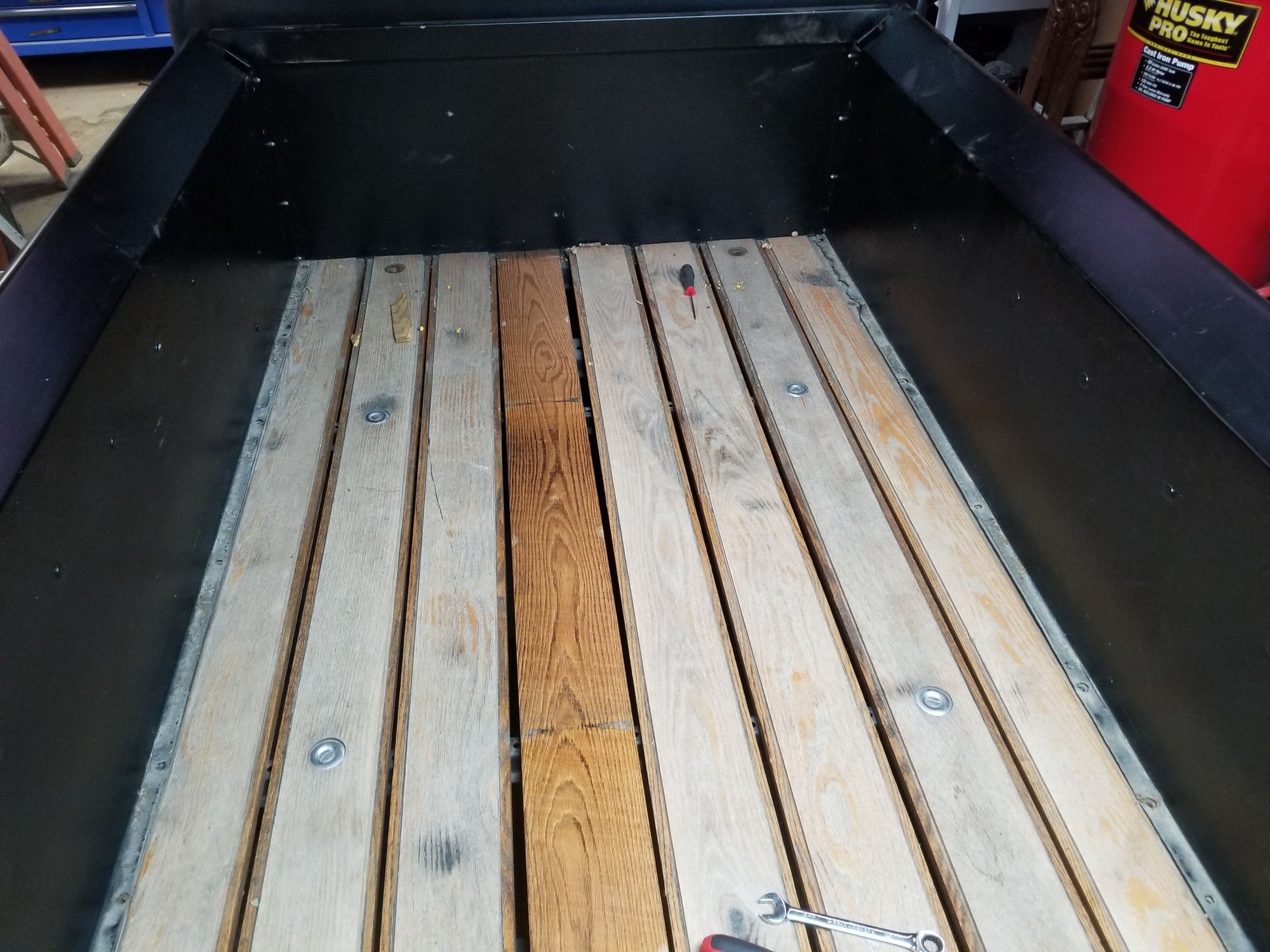

The before

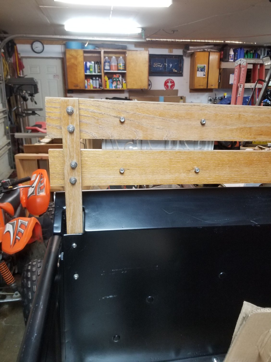

Side rails
The underside of the boards still look good

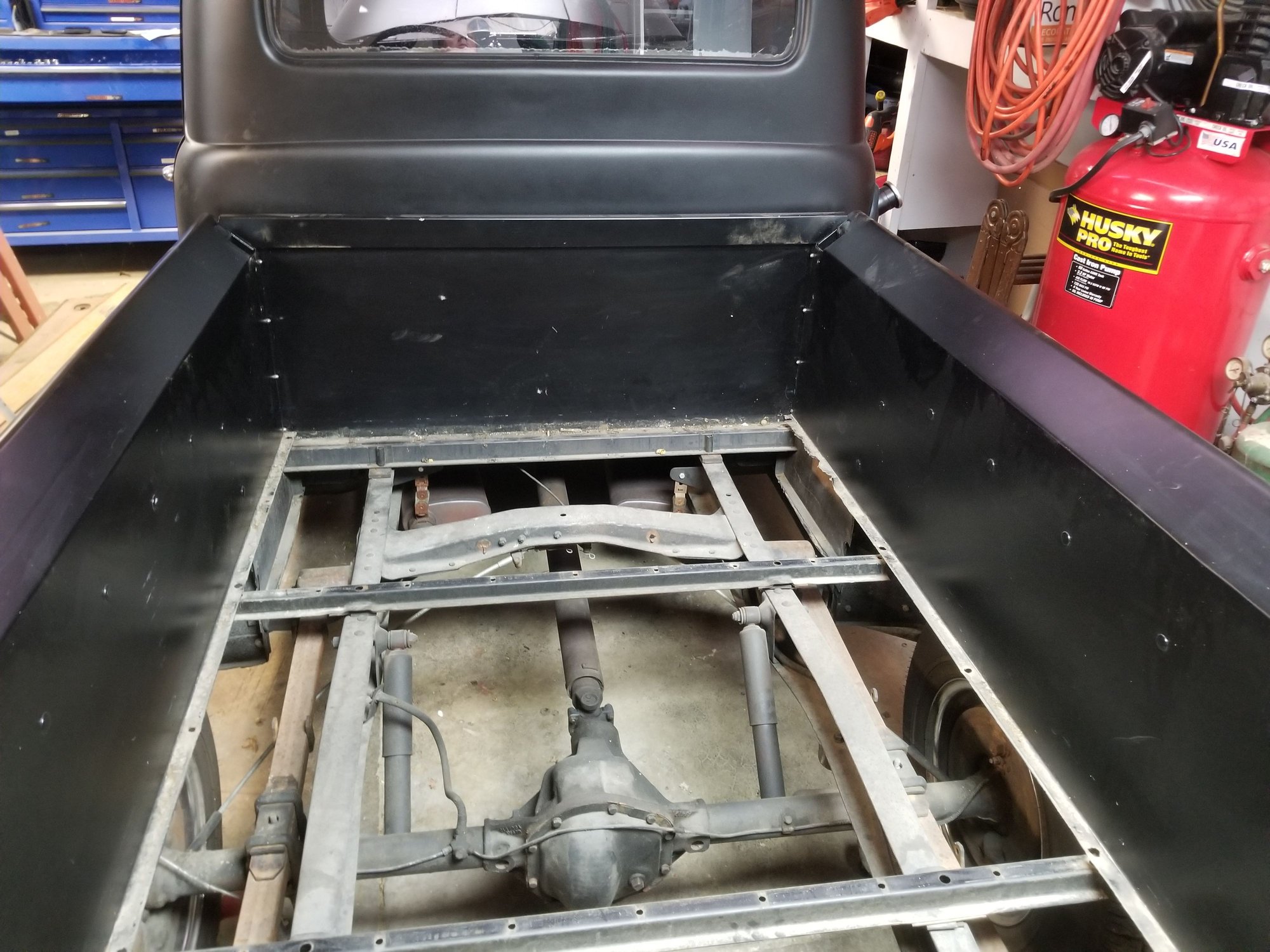

All boards out. Time to clean up and sand

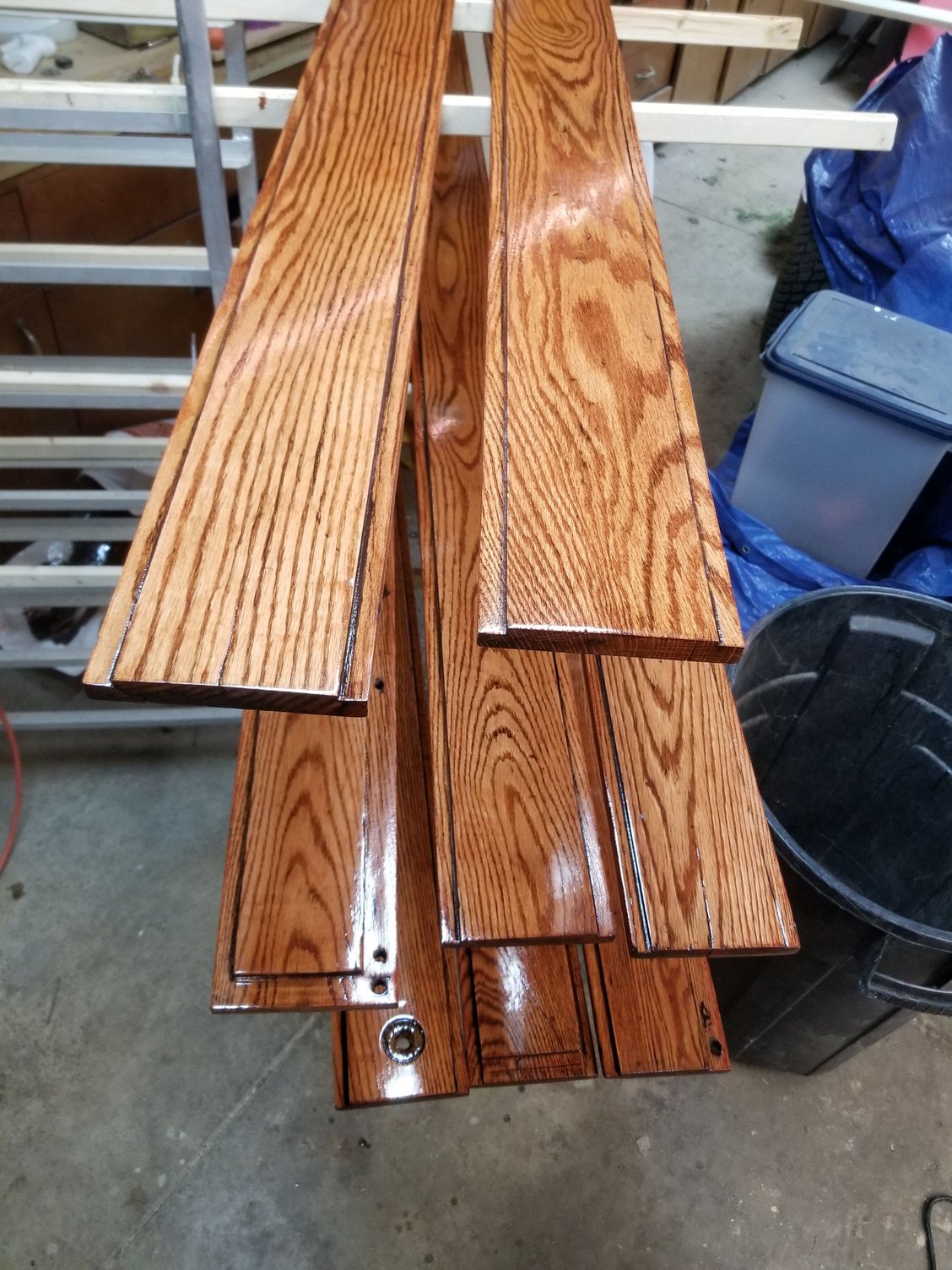

Side rails done and on my \"stain /varish rack" ready to be put back together.

What kind of finish are you using? Looks nice!

Are your stake pockets bolted in to the bedsides? I have thought about putting racks on my 54 but wasn't sure if the stakes should bottom out at the bottom of the stake pocket or should they fit tight and be wedged into the stake pocket.

1 coat. Let it set 15 minutes
4 coats on the side rails and 8 on the bed.

The first time around I used finish from by buddies woodworking shop.....not made for exterior. (I was not smart).
I spent about 8 hrs sanding with a belt sander and orbiting sander
the stake posts are only part way in and I have 2 screws in each that run 3/4 of the way thru the wood

We all make mistakes and shortcuts, don't we. No wonder your boards looked they way they did. Eight coats of Helmsman Urethane should last longer! LOL.
I sanded the Urethane off my boards before I painted them.

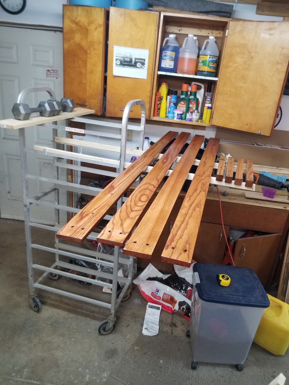

Has anyone sprayed on their spar finish? I used a brush on the rails. Now I have 2 coats sprayed on the back of the bed boards. It's looking ok

That spar really yellows the wood. Left 1 has 3 coats the right none

I used Tung Oil on my side rails as its a lot easier to maintain, never needs sanding, can be simply wiped or brushed on and wiped off with a rag. As soon as you jump into a built up "coating" it will have to maintained obviously and all that involves sanding tacking etc. The oil allows the maintenance of that process to go on easier in my opinion. Although oil doesn't last as long, except for the fact that the rails are vertical as opposed to laying flat out to the sun will make a big difference as they won't need the attention that the bed wood will need. I would have oiled the bed too except it doesn't produce the wow shiny factor that traditional varnish does. A good source for a better quality varnish is a marine supplier instead of the paint store. Epifanes is a superior varnish that I would highly recommend to anyone. A single component tranditional varnish should last years and year on a garage kept truck. Although a periodic maintenance of one coat per year would last just about indefinitely if done every year.
