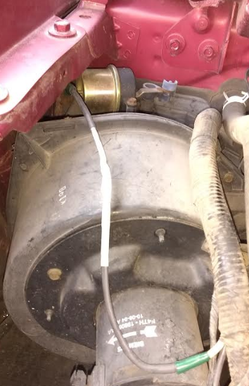

also check your white vacuum line under hood, it gets so brittle it will literally disintegrate in front of your eyes, next to passenger side hood hinge

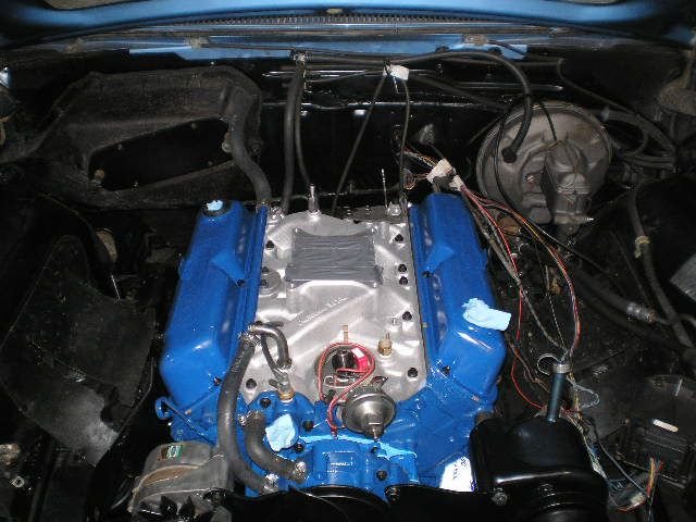

If the return hose from the heater core is not hot, then you will not get heat in cab. Blocking the rad shouldn't be necessary, I can get enough heat in mine at -40, so the system is capable of making heat, if it is working properly. The short hose from the water pump to the waterneck is for the return. There may be a metal elbow on the intake manifold that the return hose from the heater connects to. Here is a pic of a simpler engine bay that may show things better.
