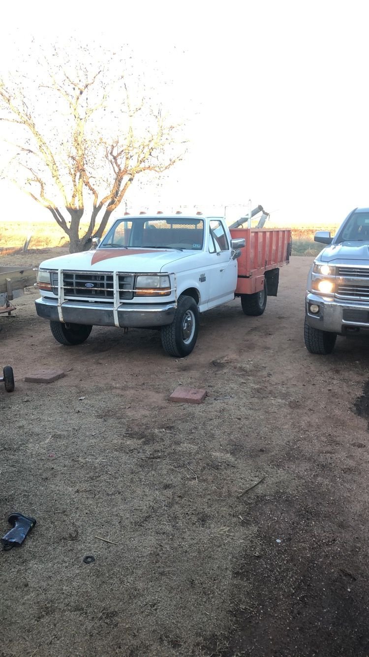

So I just got my hands on a 92 F350 cab and chassis. It has a PTO and dump bed on it (reason I bought it) it’s low miles, drives great, but I’m having some engine issues.
Its been sitting 3 years. It ran rough so I added Lucas injector cleaner and topped the tank off with super. So it has half bad gas half good in it. Seems to run better and better as I try to burn it all. Oils been changed and air filter.
So it idles at like 1500 or so If the IDle air control is plugged in. Unplug it and it idles a little lower than good but ok. So I cleaned it and it didn’t work, installed a new one and it hunts around some, but is still way high. Do I need to program it? Is there something that controls it I need to look into? Where do I go from here?
The truck is kinda a dog in general. I assume that’s just the little engine in a big truck. I’m used to diesels. It does run 75 (eventually) on the highway. Gets around good in 1-2-3 gear and becomes a dog in 4th and 5th.
it is a dually, but currently has “super singles” 33x12.5 mid grips. I’ll be putting duals back on the rear. Probably some 265’s.
