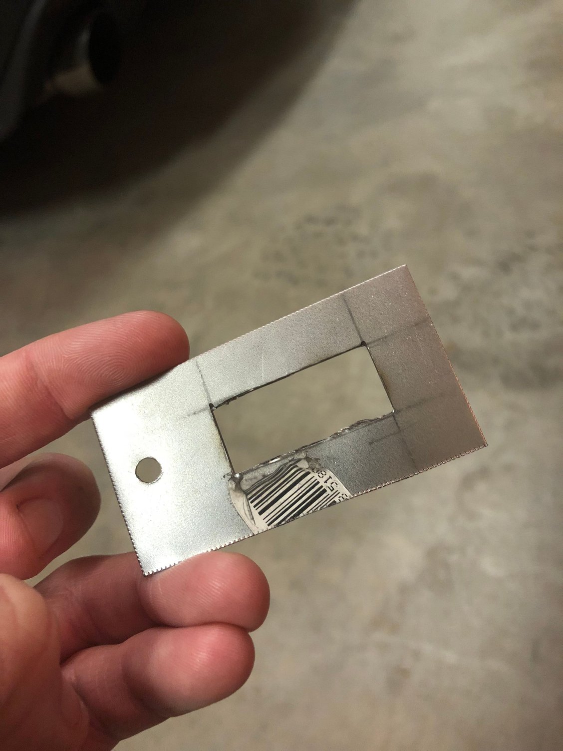

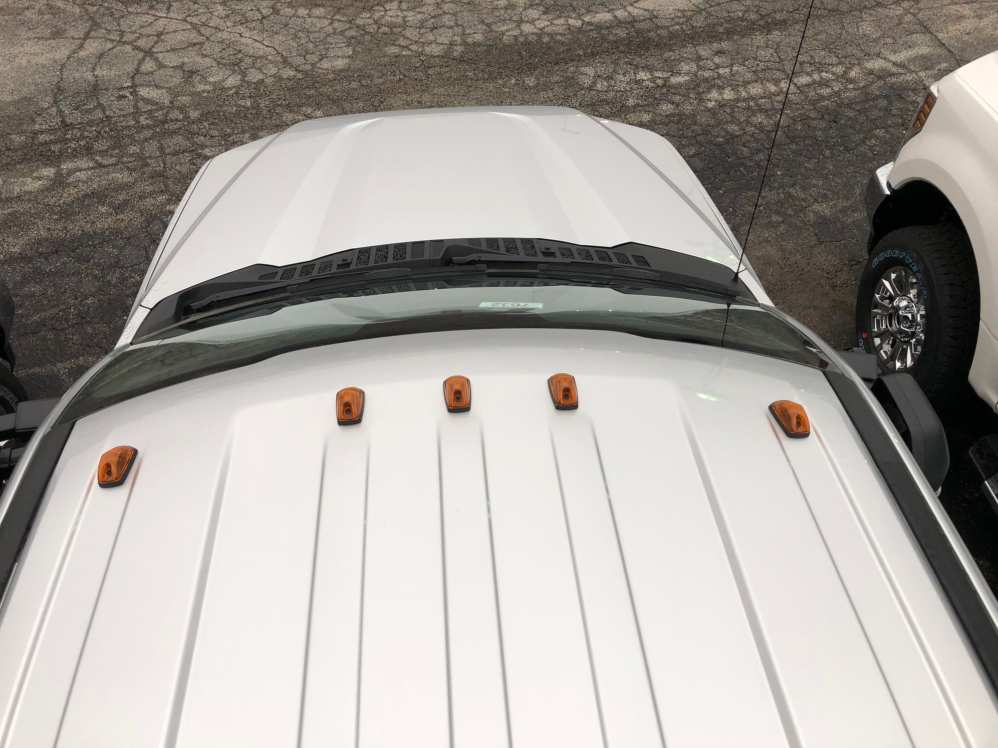

Hi, I added the OEM roof marker lights from a Super Duty on my 17 F150. The cabs are the same in every way except the roof panel is slightly thicker on a SD.
I just took pics of a SD roof at a dealership and then measured them evenly and as close to the pic i could. Turned out perfect.
Cover the entire front section of the roof in white masking tape. Then you have a good surface to draw or make pencil mark on for measurements. I used a dremel to cut the holes.
If your using or need screws that make contact with the aluminum roof be sure the material the screw is made out of is compatible with aluminum to prevent corrosion.
i will post some pics.

new SD at dealership for reference.
Front of the lights basically line up with where the roof starts to turn down towards the windshield.
17+ OEM SD light.
Sheet metal template
Sheet metal template fitment check on the light.
Masking taped roof for measurement markings.
Finished product
Finished product. Turned out pretty good. I think one of the lights was just a tad bit crooked but could not tell unless looking straight down on the lights from the bed. Never had a leak.
