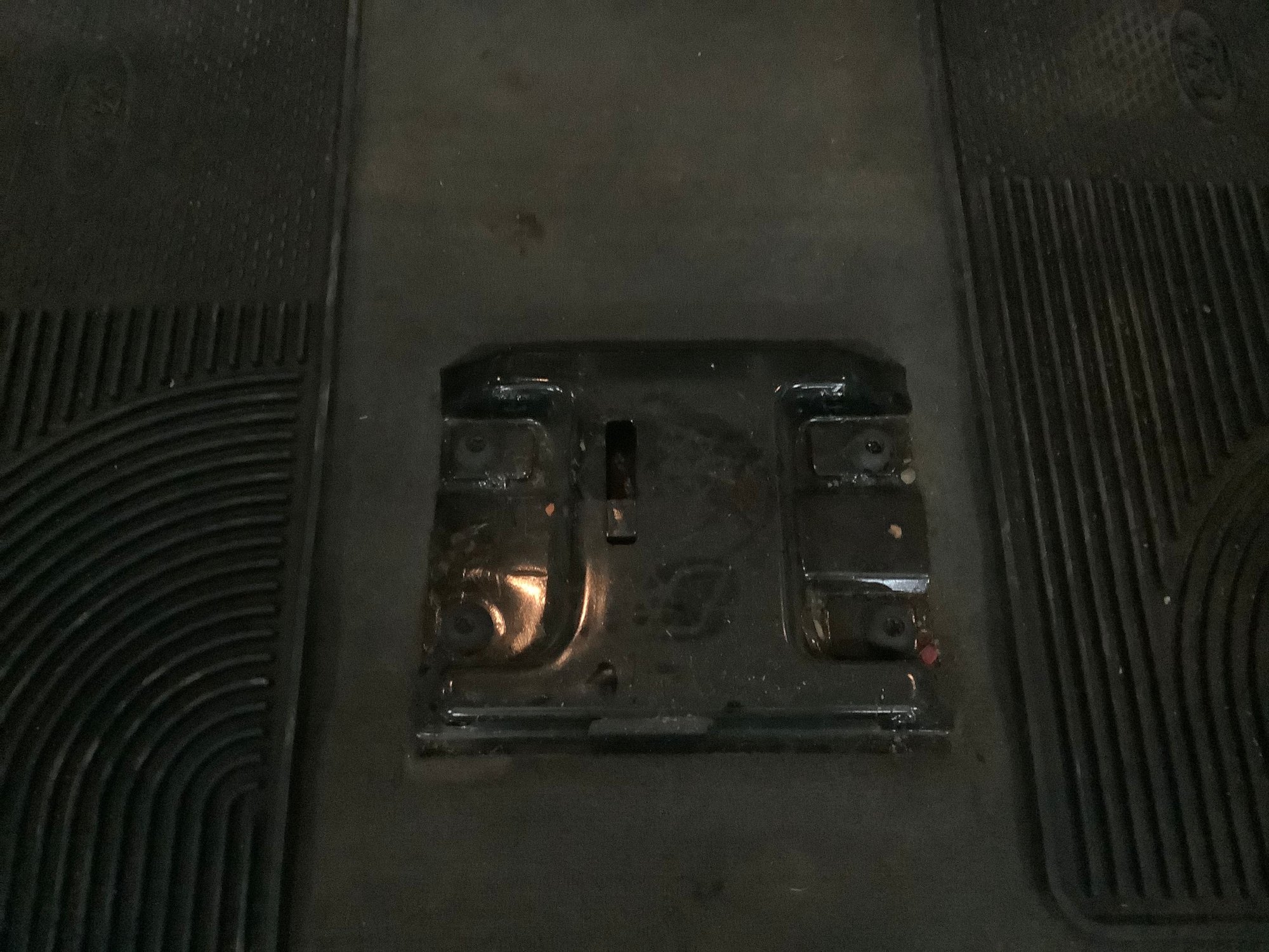

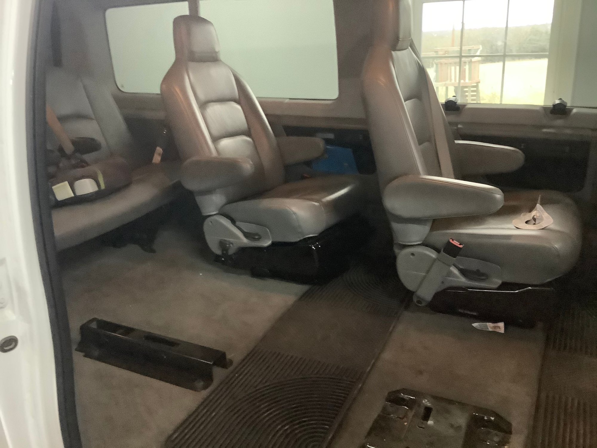

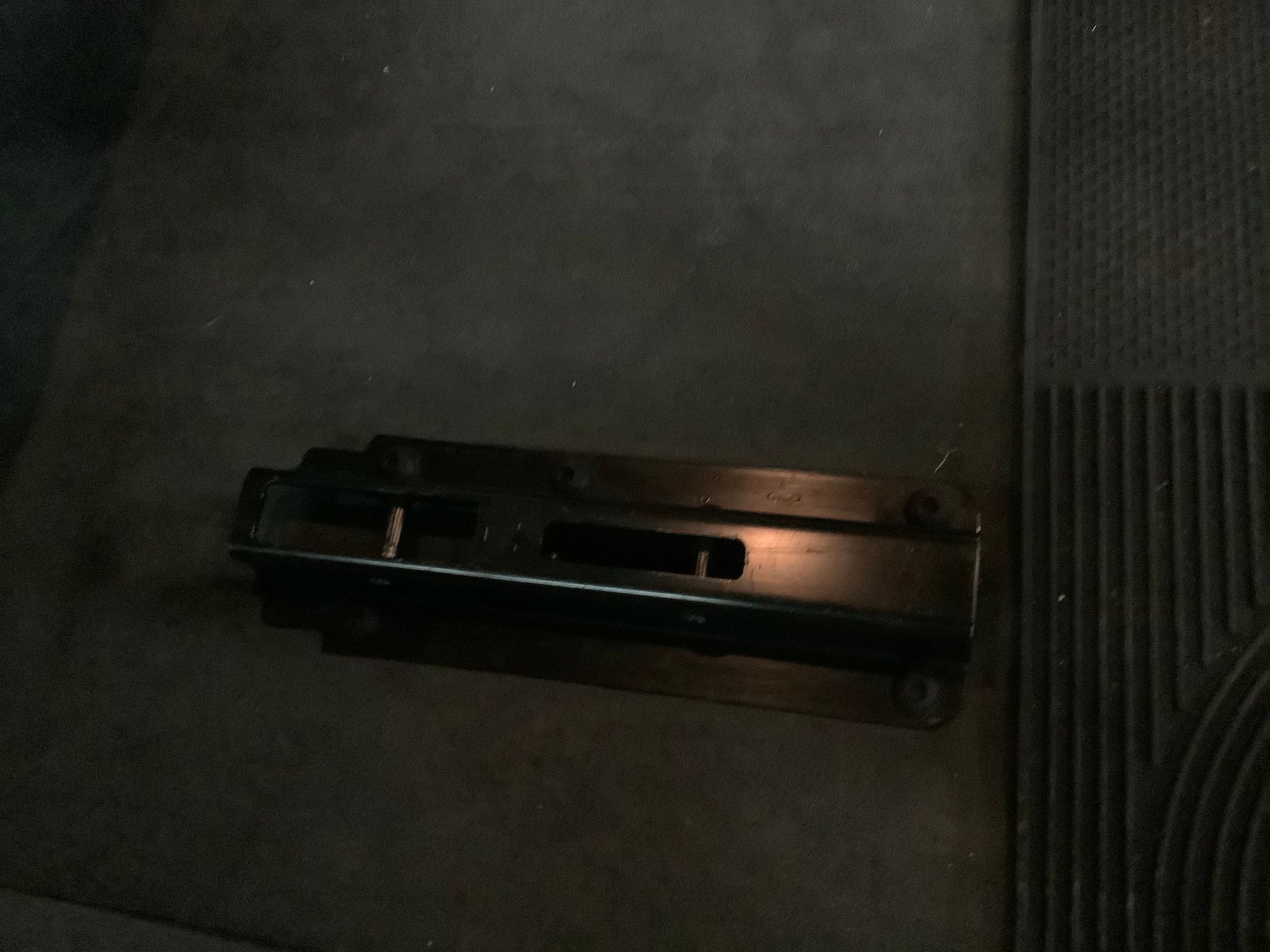

Here are some pictures of what I have. My two new captain chairs on order have not arrived yet but they are mocked up in the approximate position they will be after install. you can see that the second row captains chairs have four bolts holding them down. Each of these bolts attach to a crossmember running across the body. The third row bench has five bolts, three of which are in the same location as the captains chair. It looks like I will have to drill the fourth one.
what is interesting is that the bench seat bracket does not appear to be the same as the ones use in the fourth row of the bigger vans. I don’t understand why. Adding the seatbelt looks to be an easy job. The crossmember for the fourth row is missing underneath the back to match what’s in front. I can’t figure out if I would need to buy the crossmember and install and drill into it or just get a flat plate to attach
to, but the rear holes for the fourth row don’t line up with a crossmember that is present on mine.

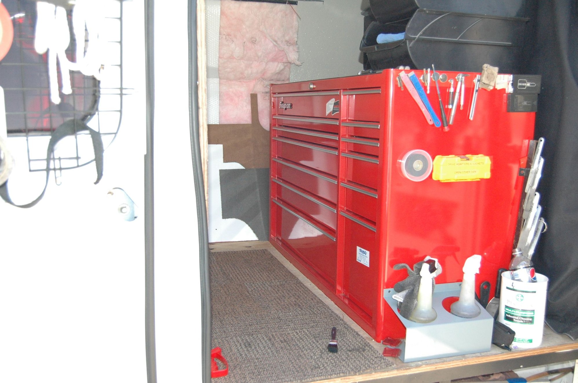

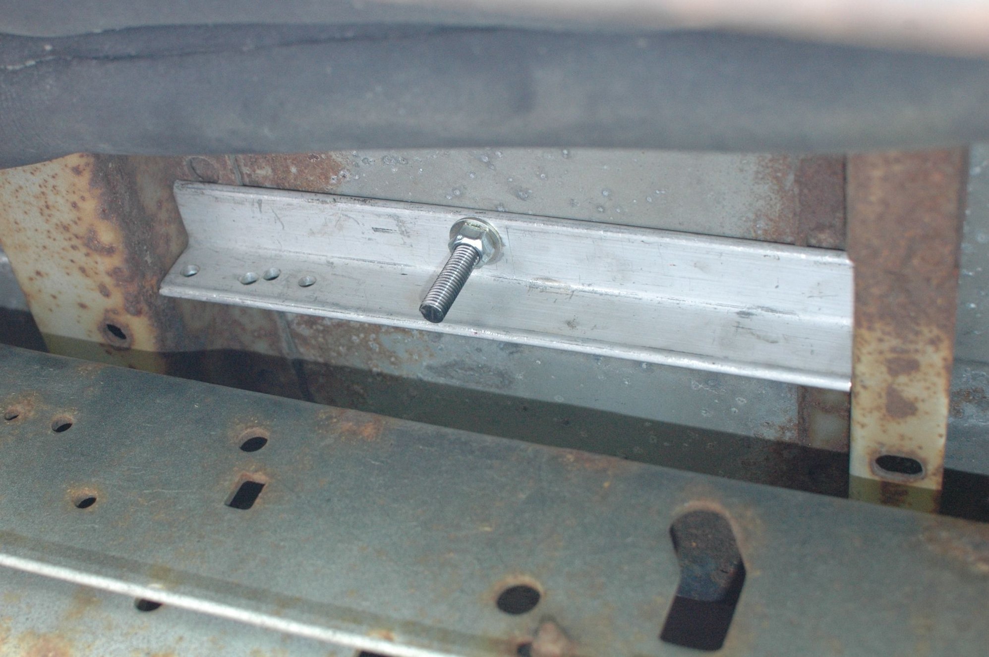

Something I've found helpful when installing anything that's to be bolted to the floor is this scheme:
Showing is how I secured a fully loaded Snap On double bay tool box that's about 39" tall, located just behind the front seats like this:
To achieve the most secure and stable mounting the box sits just about in the middle of a cross member so using the aluminum angle shown I drilled holes through the floor that are on either side of that cross member. Fitting the aluminum channel on each side I capture three different cross members spreading any load over them, nothing is attached only to the floor sheet metal.
FWIW this tool box recently suffered a rear end collision that was significant but the box didn't move a bit. Long story short you're on the right track mounting the seats to the most solid points available whether they're factory parts or of your own creation.
Good luck on your project---you seem to have it well thought out and proceeding nicely.
