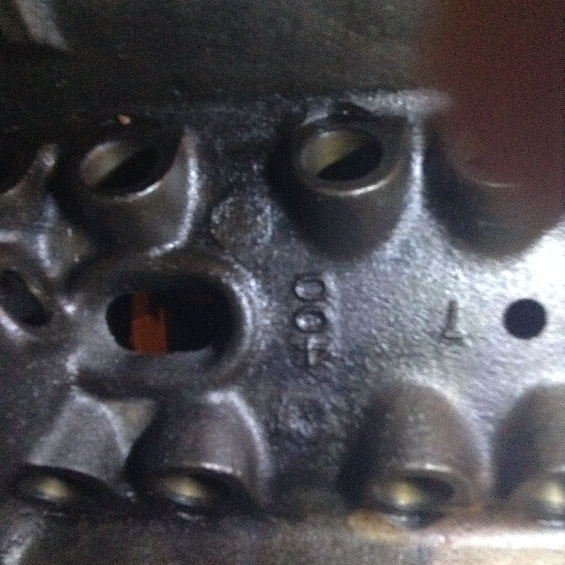

One more thing: it really IS a 400M. If you don't include "M" behind it at the parts counter, they hand you Windsor parts, 390 parts or Pontiac 400 parts. Always include "M" when you are describing your engine, unless it's another Ford guy, whose first sentence will be: ''Theres no goshdang thing as 400M!" And his second sentence will be: "They doggone junk anyway. Boat anchor!"......both statements of which, are WRONG.

I'm not seeing an "M" there...
