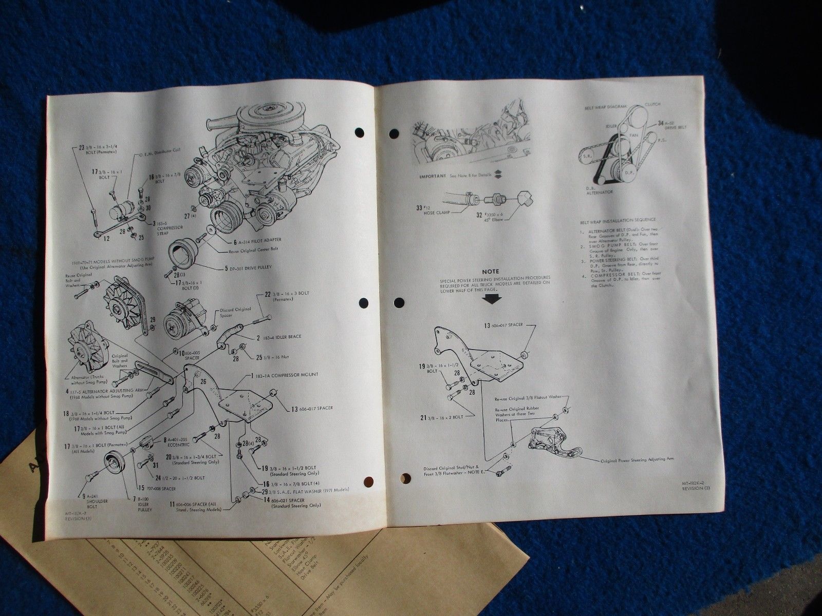

Pulleys, compressor, compressor clutch, compressor bracket, condenser, dryer, A/C hoses.
The dealer installed A/C engine kits (C6TZ-19B969-E for the 352) used Mapco kits (183 for the 352), also sold by Sears. These dealer A/C kits were available for trucks through the '71 model year. The compressor mounting bracket was made from steel and welded together. Although the kit included the A/C pulley, it did not include the compressor. I was fortunate enough to find an NOS D1TZ version of the V8 kit which included the instructions. The condenser/receiver drier assembly was part of the companion Master A/C kit that included the hoses and evaporator (C6TZ 19B968-?) The truck Master Parts Catalog instructs the dealer that both kits are required to install A/C. Having said that, there was nothing to prevent a dealer from deviating from the kits and installing parts from another car line.
Instructions for the Mapco V8 engine kit.
