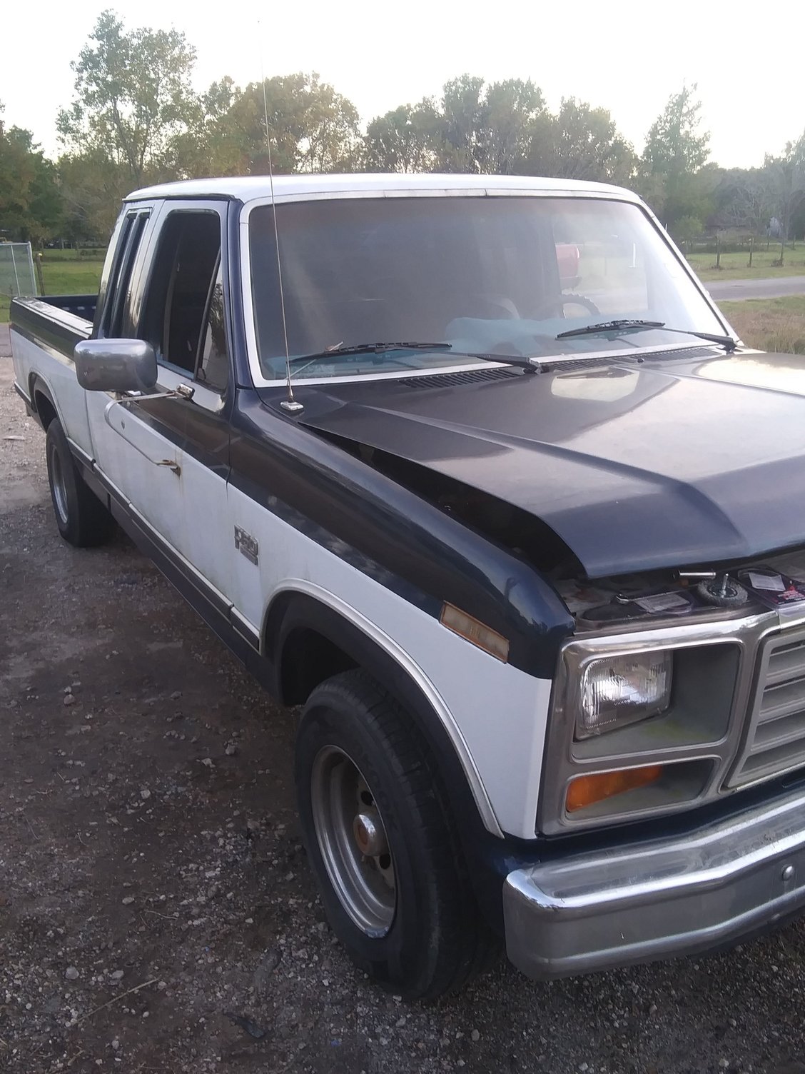

I just bought this 86 Ford F150 300I6 4 speed standard truck for 1000 bucks. It has the feedback carb and ignition system. Well the ignition system is fried and ive asked around and everyone says to convert to DSII but no information really on the swap! They say i can keep the Feedback carb (its brand new) with the DSII. I can but the box, distributor and coil for less than a hundred bucks. Just need some information on wiring up the box. The rest i can do without a problem.
