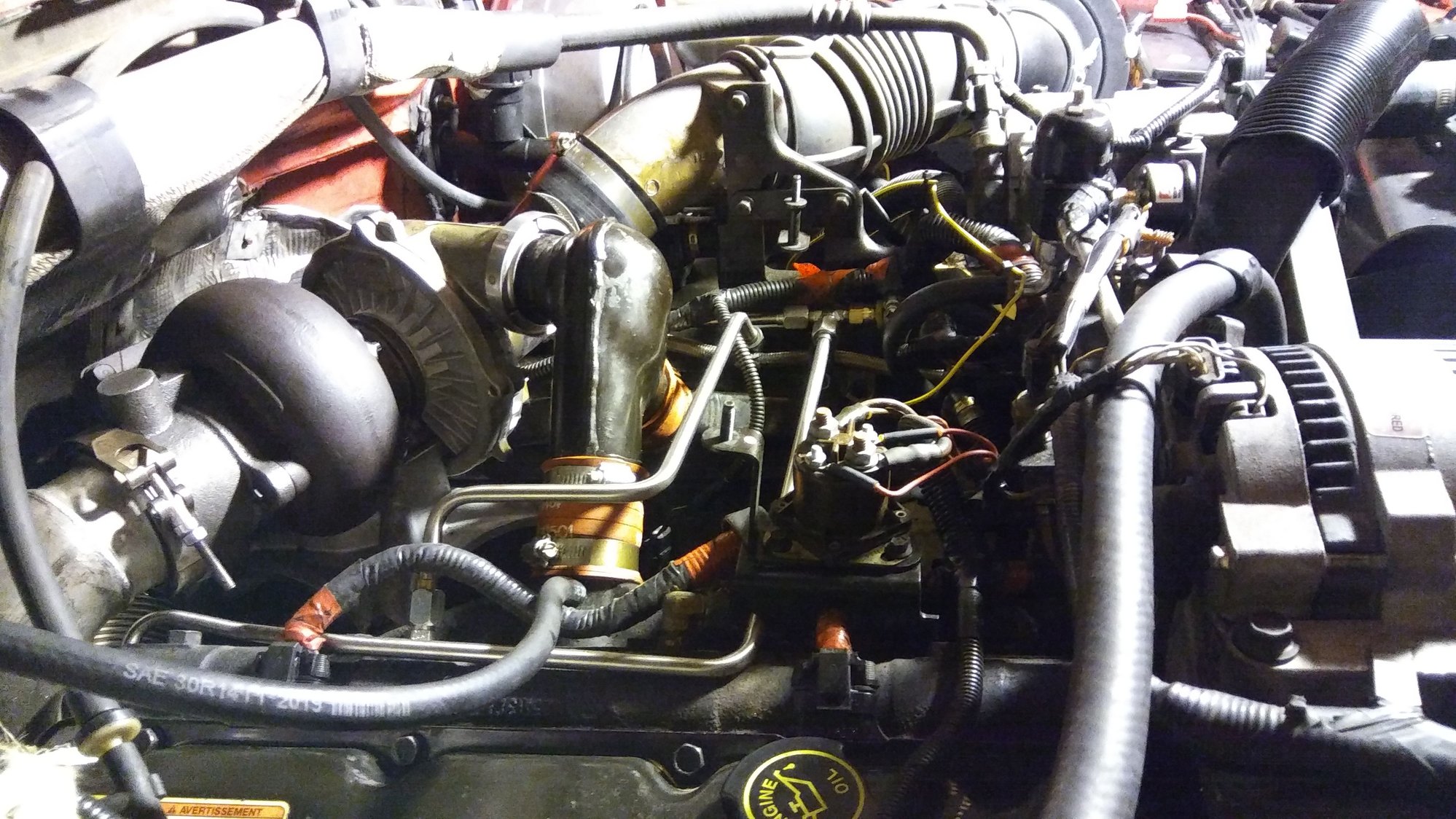

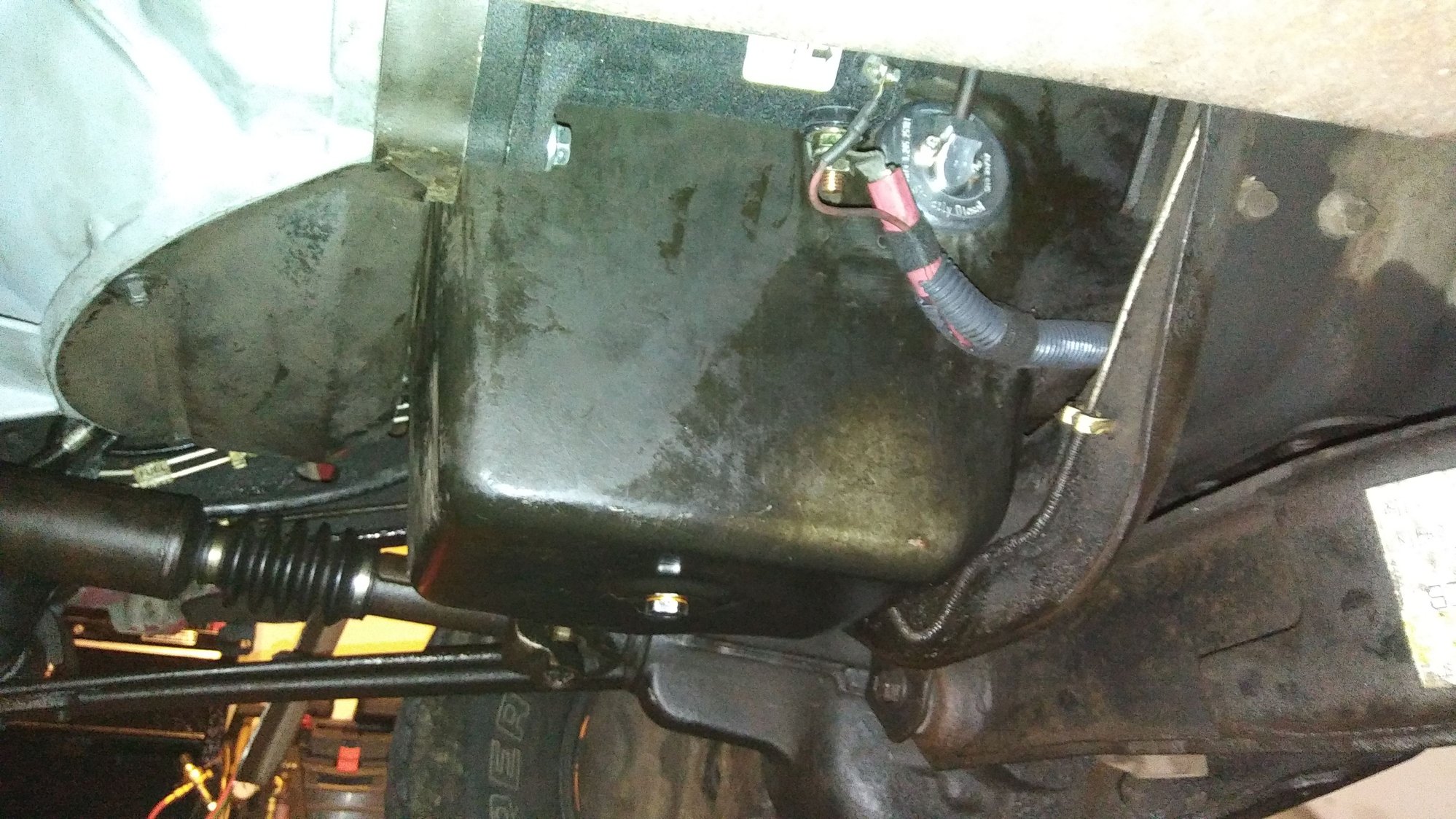

Changed the transmission, clutch, drive shaft u-joints, power steering pump, injectors, glow plugs, installed an efuel system, deleted EBPV pedestal, new turbo cartridge, new under valve cover injector harnesses,down pipe and bellowed up pipes. I tried to just use a new O ring to fix the dip stick oil pan leak but it failed 100% I ordered a Strictly Diesel adapter and that worked awesome. It took a while to start up but when it did she was much more quiet. As of right now I have a leak free 7.3. I have new covercraft door panels to install along with door pins and bushings and a new rear bumper. I got the truck from a guy and it belonged to his twin brother that died. He didn't want to get rid of the truck but he couldn't afford to have it fixed and he couldn't do it himself and he was watching it fall apart. I promised him I would bring it by when it was fixed so he could see it. In a few more weeks I'll take it over and show it to him.

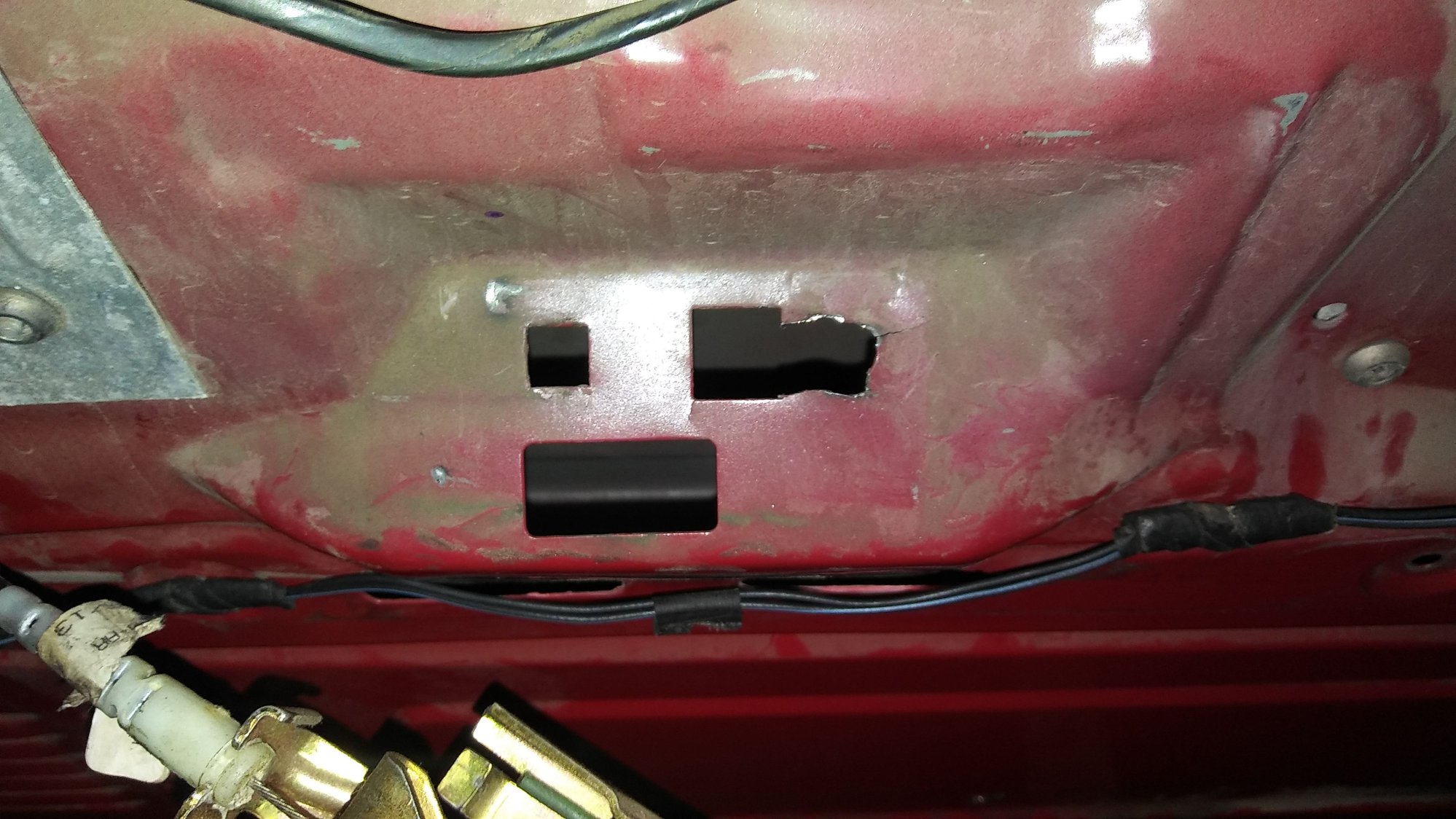

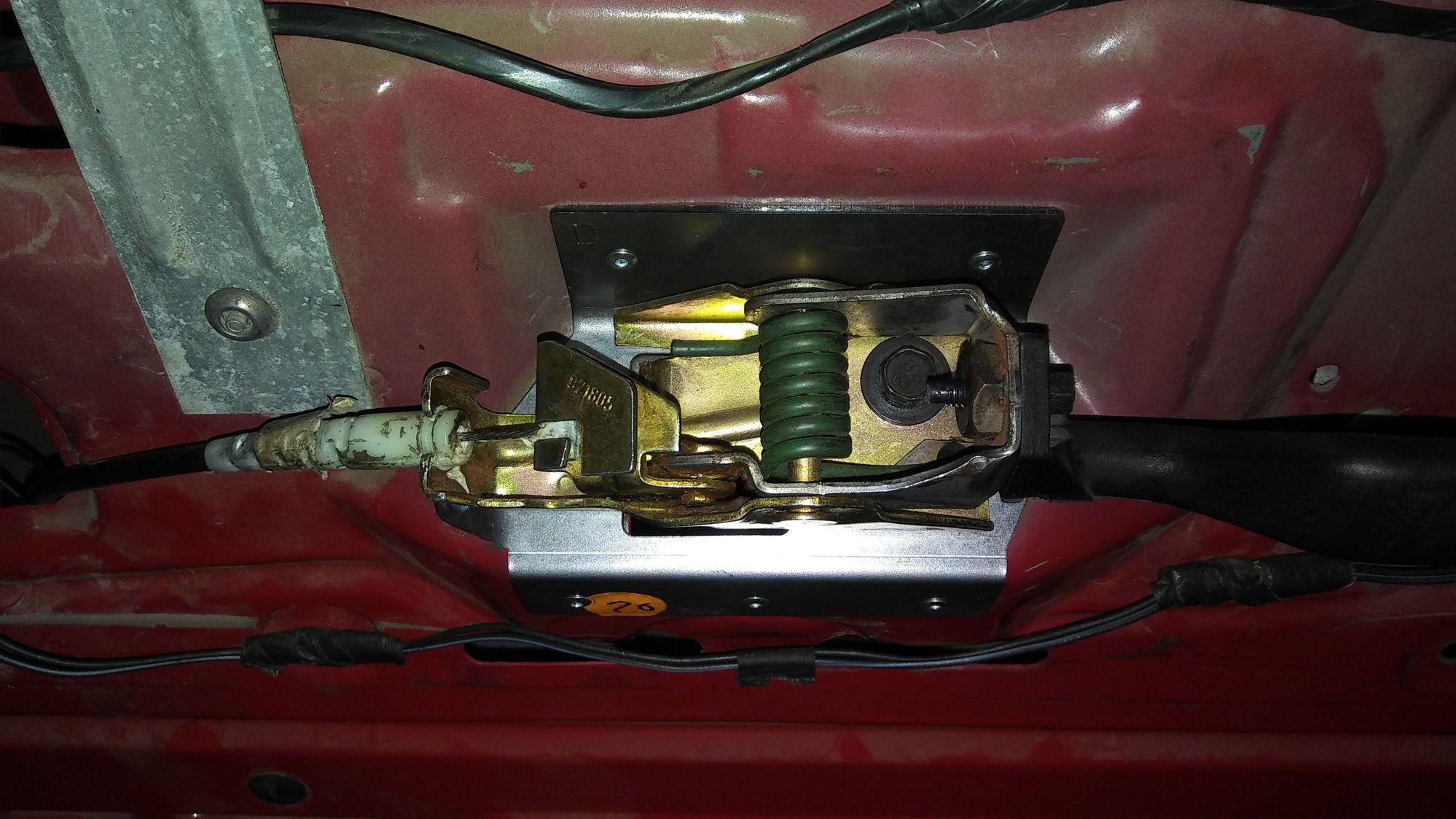

Here are some pictures.

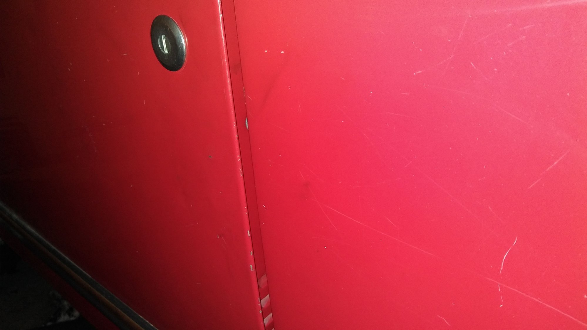

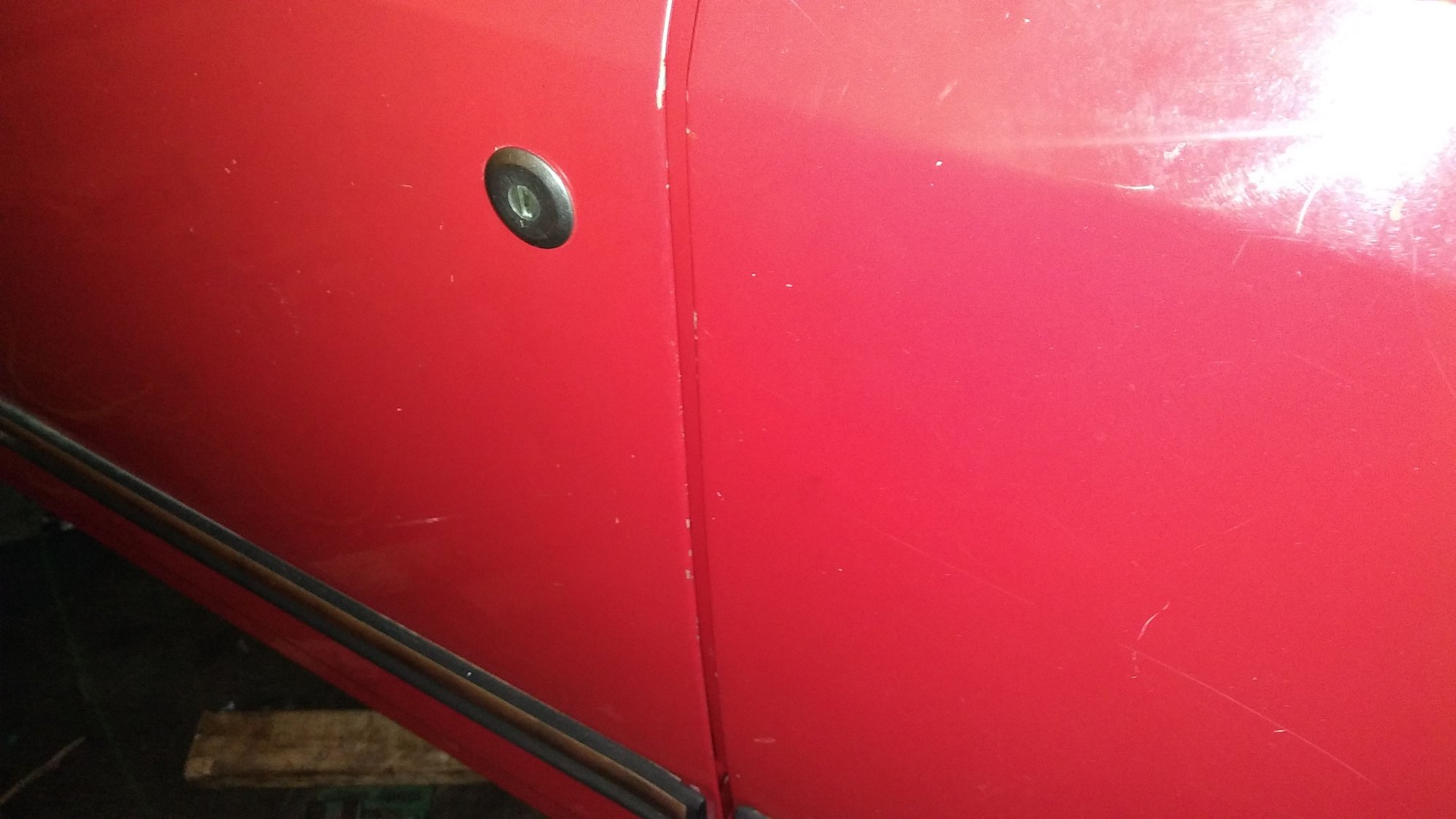

I replaced the door pins and strikers today. I'm working by myself so progress is slow. The doors open and close 90% better I am having an issue with the drivers door. It closes and latches but it needs about another 1/4 inch to fully seat. I have moved the striker as far back as possible. If I could move it another 1/4 inch the door would be perfect. The PO had glued weather stripping all around the door. Like I said the new hardware improved the situation greatly but didnt totally fix it.

I was able to get a good portion of the gap in the door corrected. The door was sagging slightly so i loosened up the hinge bolts and straightened out the body lines I'm assuming there is a significant amount of wear on the locking mechanism so I think this is as good as it will get as of right now. I installed the handle reinforcements from CPaddict. It is a very nice kit at a affordable price and it works beautiful.

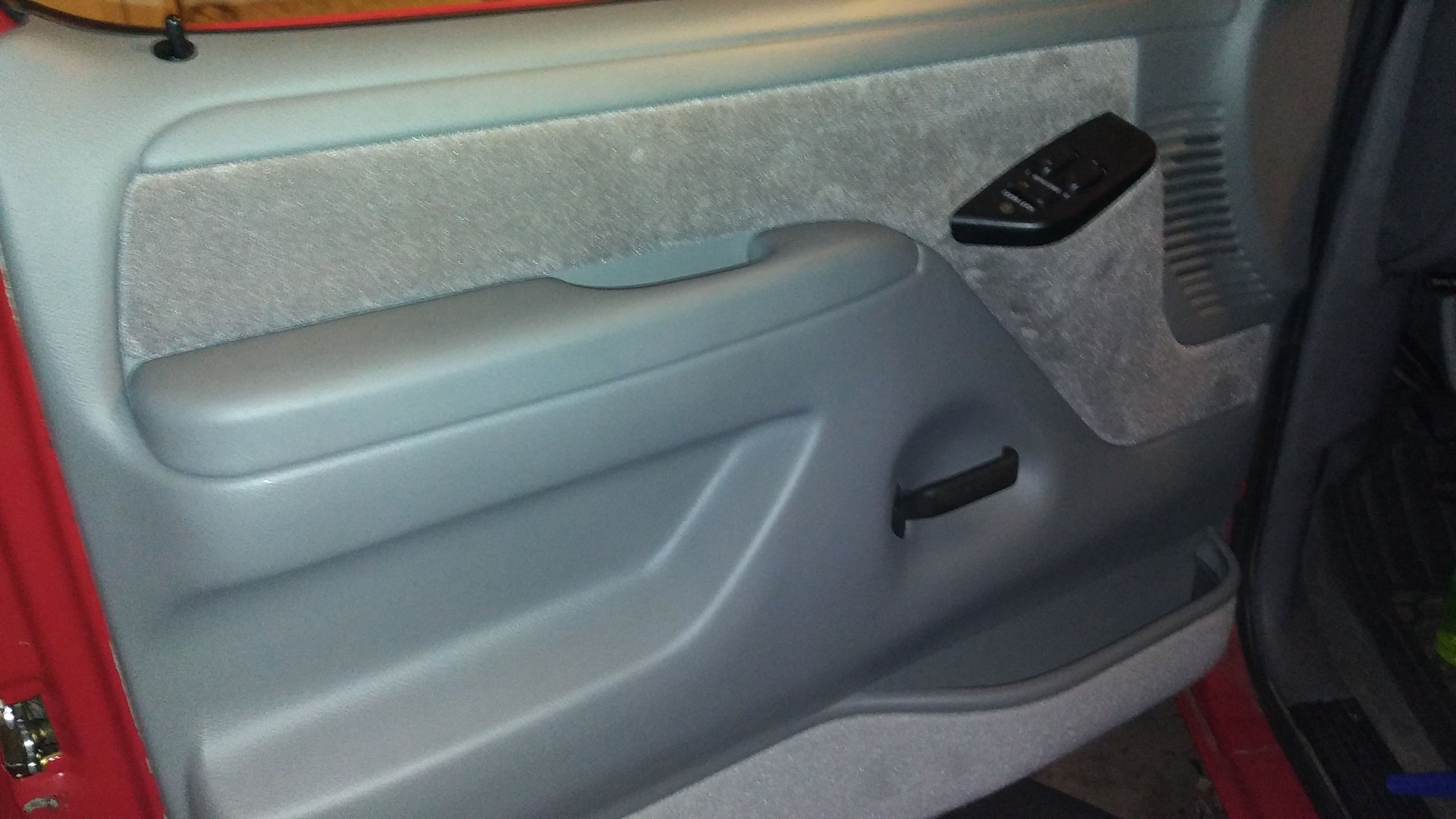

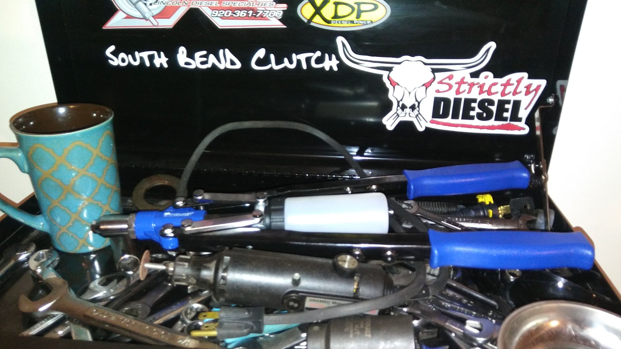

Installed the drivers side door panel today. I put in new door speakers, Ford window motor and Ford door lock actuator. I had to go to Harbor Freight to get their big rivet gun to do the lock actuator rivet, 20% off coupon and it came to $17 and it came with a bunch of rivets so I didn't even have to buy any. The 1/4 inch that comes with the kit works perfect.
