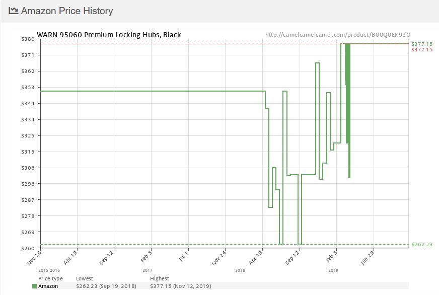

Old Nov 11, 2019 | 06:49 PM

95060 is black and 95070 is chrome. Can someone confirm this? I've had the -60 in my cart for a while waiting for a price drop ($380 currently), but it wasn't until this thread that I knew about the -70 part number.
