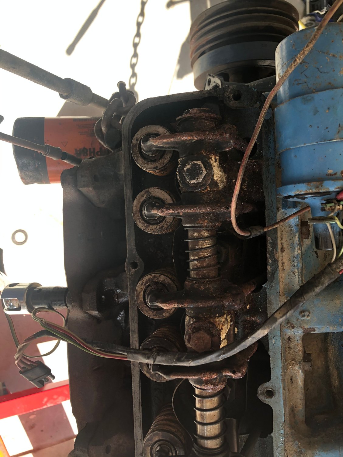

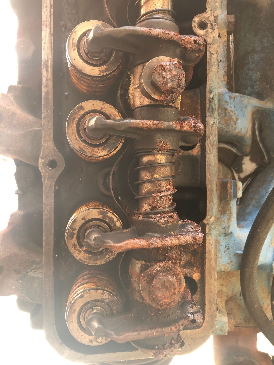

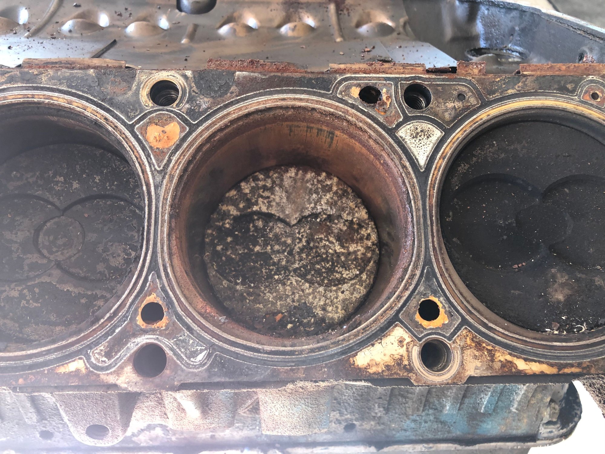

I started my truck about 3 months ago with intent of putting a fuel injected motor in it. The truck started as a long bed camper special with a 390. It is now a short bed with Crown Vic swap and coils in the rear. I started to think about rebuilding my 390, so I started to disassemble the motor. This is what I found, sludgy oil, surface rust under valve covers, and motor would only turn over 3/4. I was able free the motor with little work. If I started a full rebuild is it worth it or start with a new motor.

390 is a good motor. It will definitely still be here another 45 years long after any plastic/aluminum/computer controlled engine.
These motors are directly related to (read: FAST, powerful) musclecar engines of the 60s and 70s (427, 428cj/scj 390gt etc) so parts are cheap and interchangable) Install is a breeze compared to wiring/tuning etc late model stuff. They are heavy though.
I'd say take it to a machine shop, if it's still a standard bore, (not previously rebuilt) that cylinder {and heads) should clean up nicely.
I'd be stoked as hell to have a 390. Lots of dependable power and so much you can do to them.

For what it's worth, I've unseized, started and ran these motors after they'd sat for decades without issues. That doesn't look too bad at all.

Betcha it'd run as is with some fresh oil. I'd say totally worth rebuilding. FE's are stout and powerful/.
