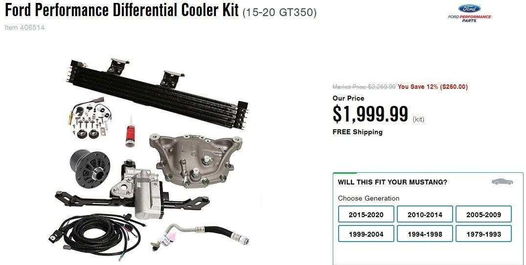

Just a thought......a diff cooler was made for Mustangs. Nobody considered a diff cooler for a truck?
