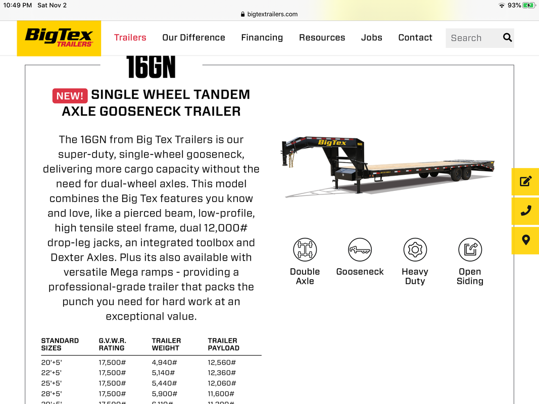

Your Ford gooseneck rating is 14,400-16,700, depending on axle ratio and cabin. The problem with F-250’s, especially diesels, is they run out of payload long before pulling power. A gooseneck generally puts 20-25% of its weight on the tow vehicle. If you take your truck’s GVWR of 10k, minus actual weight with occupants, what do you get? That number is your payload.
For arguments’ sake, let’s say you have 3k in payload left. That will hold a gooseneck of 12k (25%) to 15k (20%). If you can find a triple axle or a trailer with axles closer to the front of the trailer, you’ll take some of the tongue weight away.
For example, look at your typical RV trailer:
Here’s a quick pull, from the internet, just for example.
See how far forward the axles are? They carry more of the weight in the trailer, relieving tongue weight. However, the typical flatbed used to haul things like a tiny house are set up with axles further back.
No plug for Big Tex, but they have a good website, shows trailer sizes including weights and payload.
Finding flatbeds with axles much further forward than these, even in triples, is hard to find. They are designed for the truck to hold a lot of the weight.
