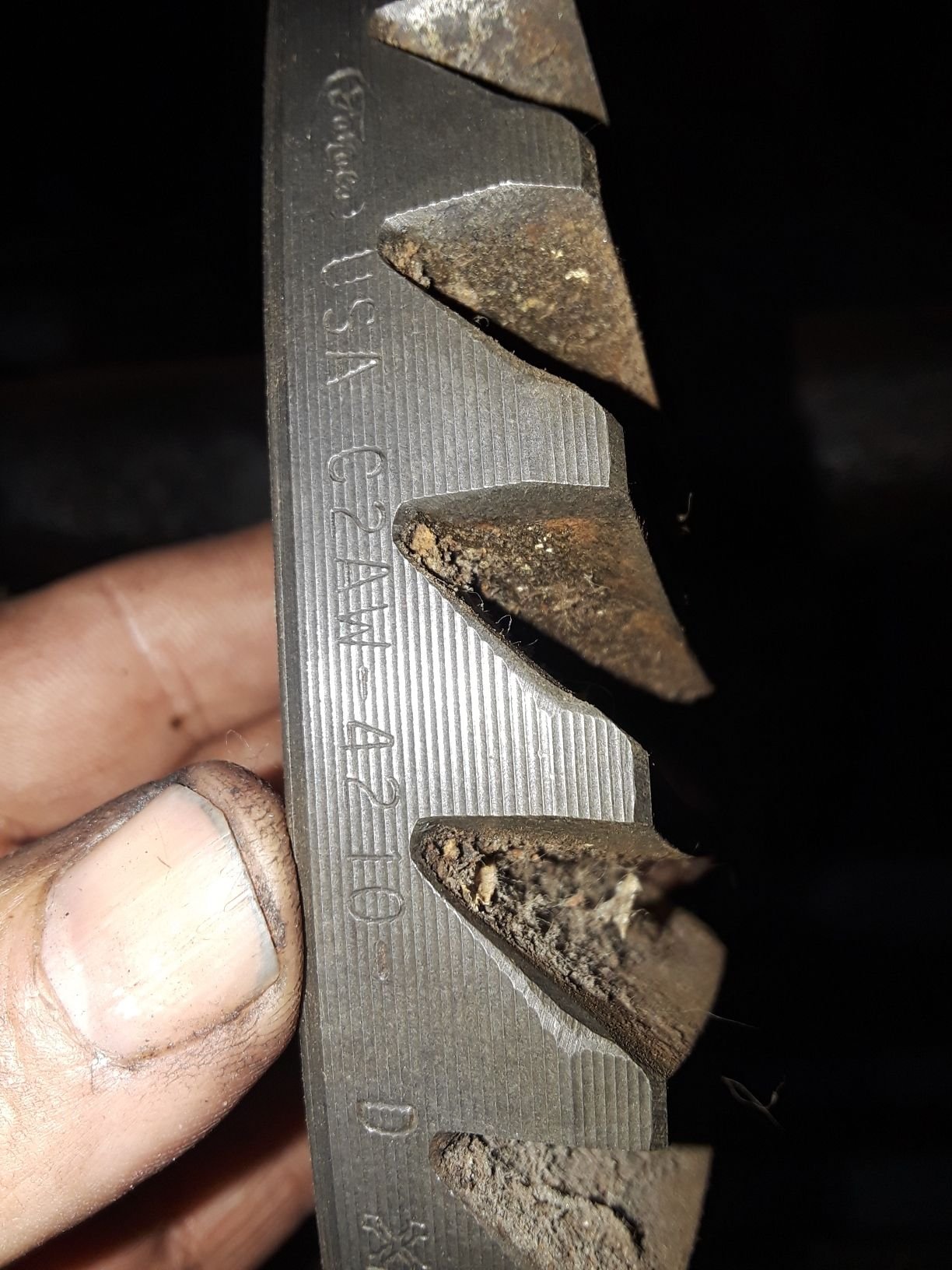

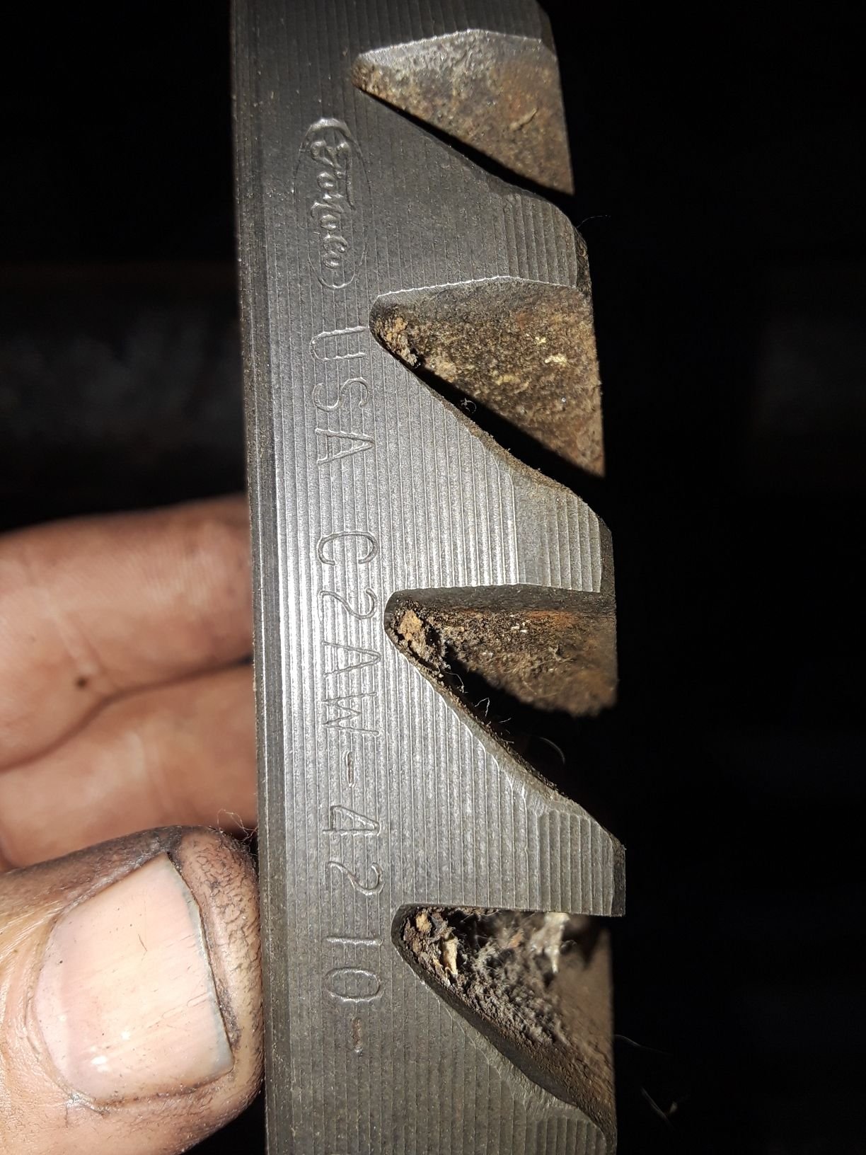

I had this center chunk gave to me and was told it came from a 67 or 69 mustang and was positive track 300 gear ratio which I have the ring gear but no pinion so will have to get new gears , but I know nothing about a ford rear end and was wondering how to tell if this will swap into a 79 f100 9 inch rear very easily or not , any input would be appreciated and if its really a posi trac or not and if the axels would need changed ? ?

Ring gear: C2AW-4210-D // Without the number of the pinion gear, C2AW-4210-D could apply to either 3.00-1 or 3.50-1
There is no way to know what this is from, because C2AW was used for myriad different 9's.
btw: No Ford has posi trac or positraction, because these are GM terms. Ford = Limited Slip - could be Equa Lock or Traction Lock.
