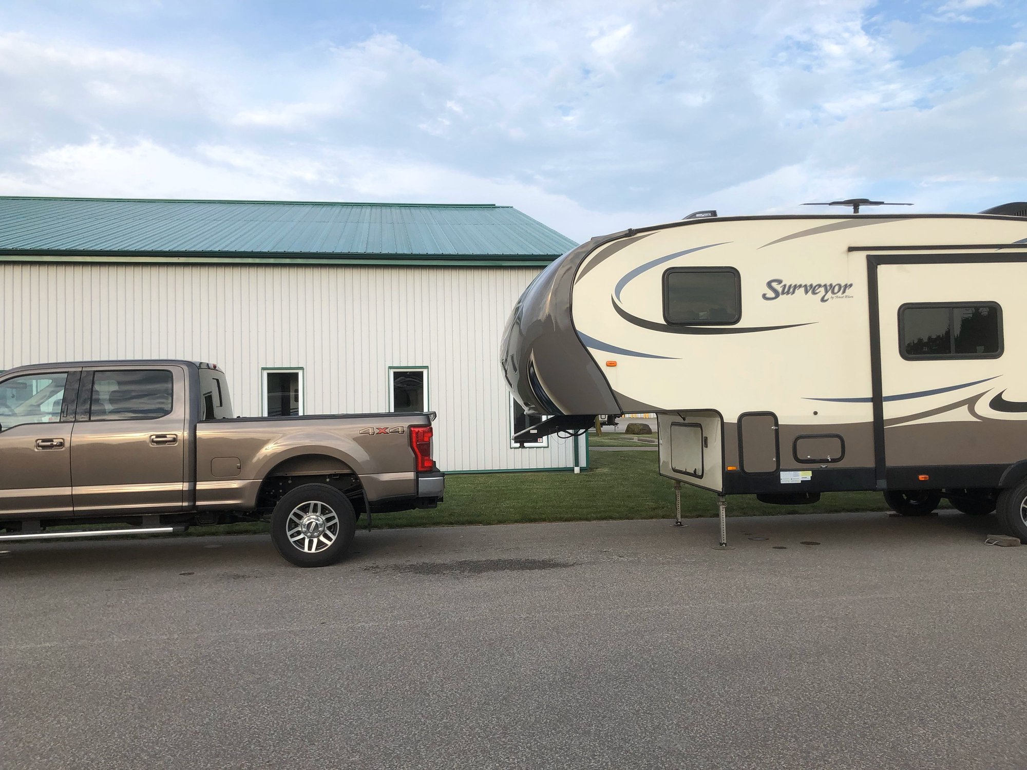

Originally Posted by Brother_Bluto
Does it work, will it work... yes. Reviews are good, especially on the 2nd generation. I'd be a bit concerned with your 4" lift tho - will likely be fairly nose high on the 5er. May also be limited on turn deg if a SB as well.
Whole heartily agree with this. I'm already nose high with a completely stock truck. If my truck had a 4" lift I don't think I'd be able to hook up the fiver. No way it's fitting under the nose at that height. Here's a couple of photos showing how the bed is already too tall for the nose. Now, imagine if the truck was an extra 4" higher!
And yes, that's not a Goosebox, just a standard fiver hitch. But I don't think the type of hitch makes a difference in this case.
