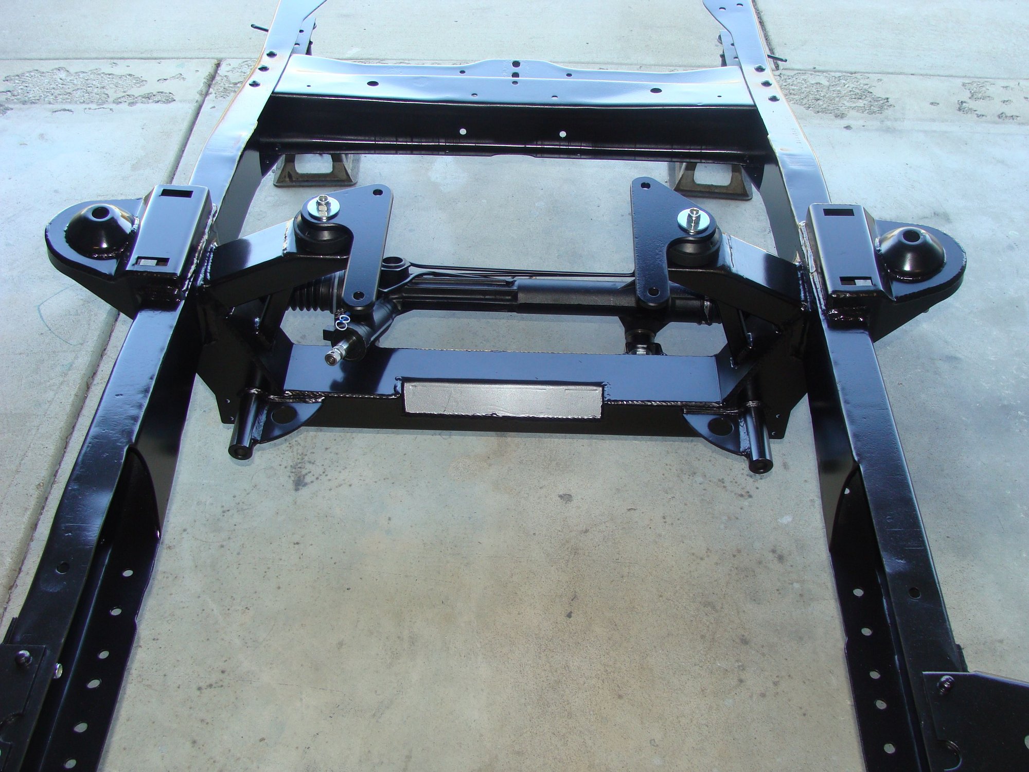

I think my regret on the M2 is that I would have been just as happy with rebuilt stock stuff or even a jag front end. For a design that has been around for a while, the aftermarket M2 I have just seems not really well thought out. For instance, the boots on my rack rub the lower control arm bolts. And the upper ball joints seem to be at too much of an angle that the boots don’t seal or seat right. I know they say it will settle after a few drives, so we’ll see. Haven’t driven it more than a block so far.

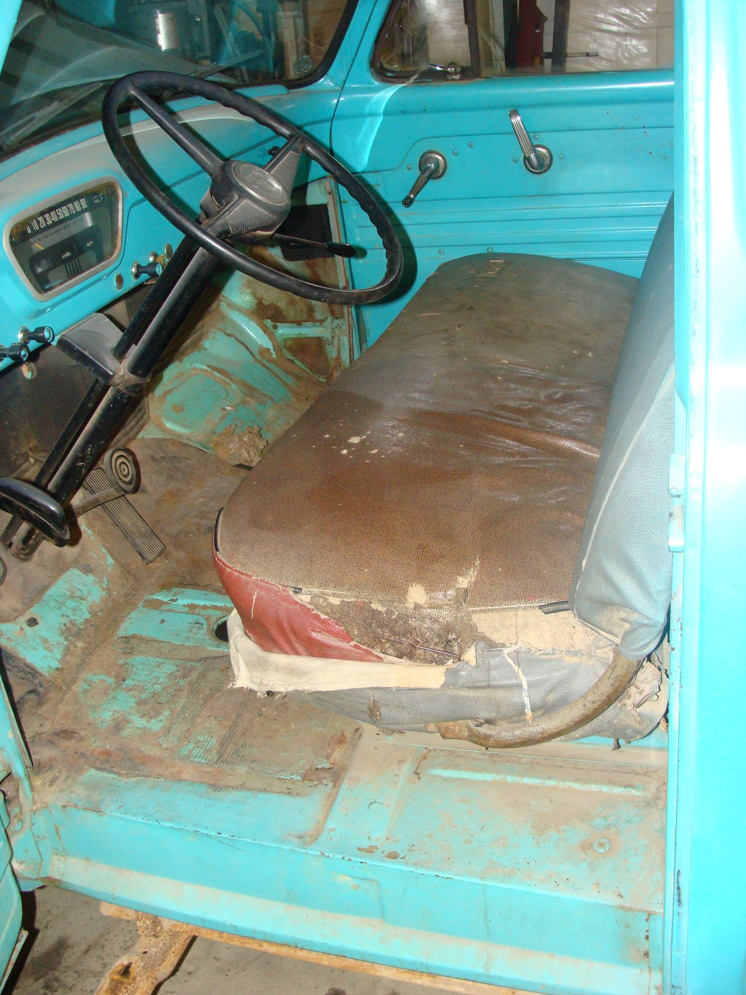

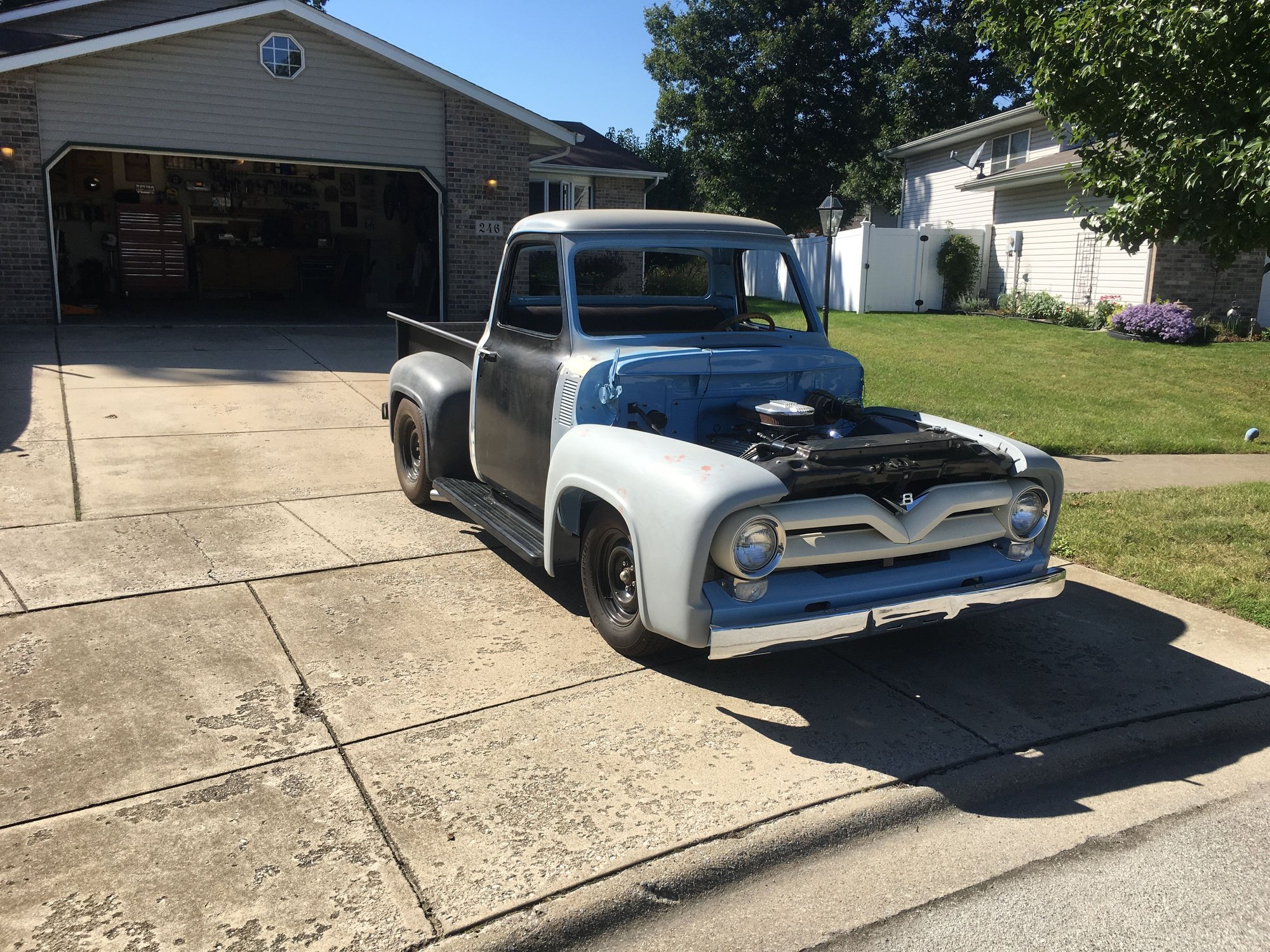

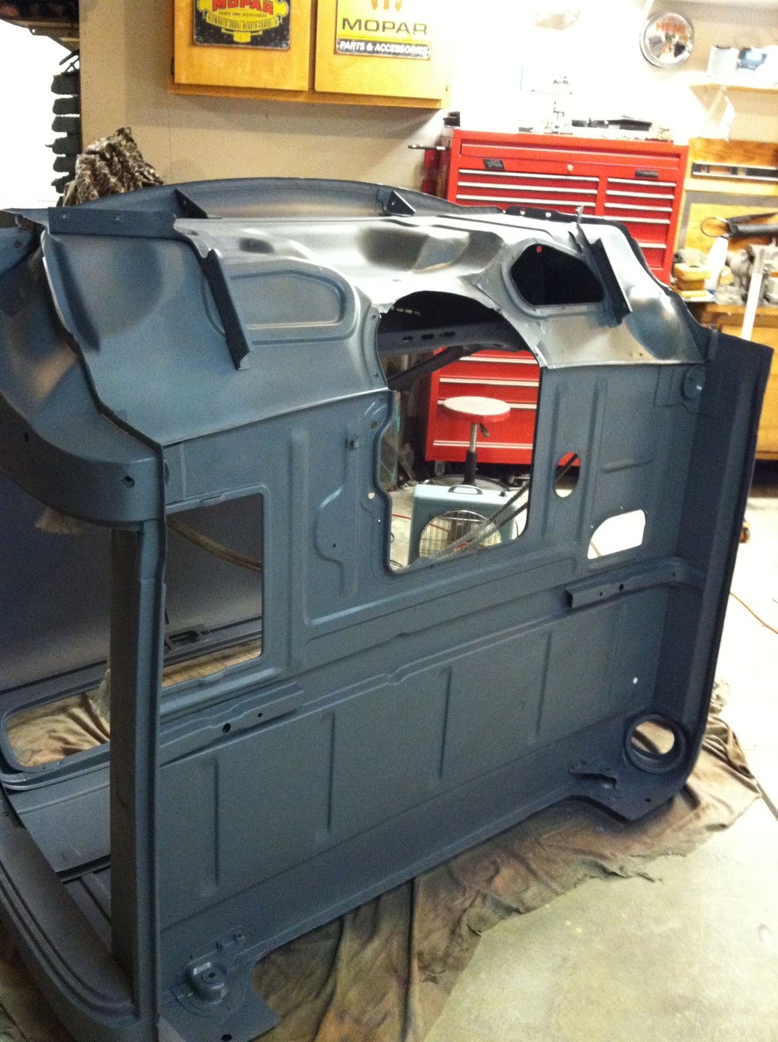

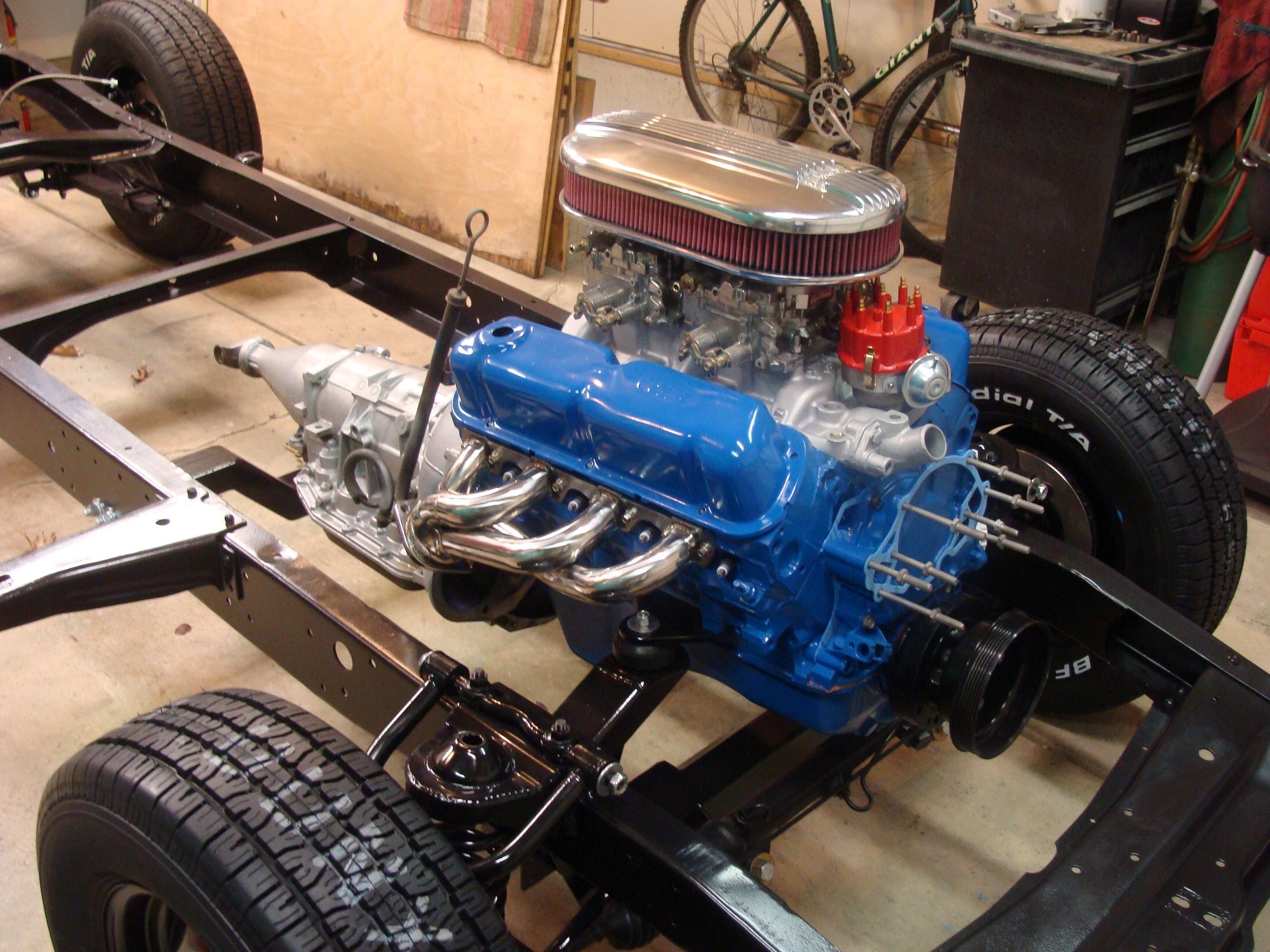

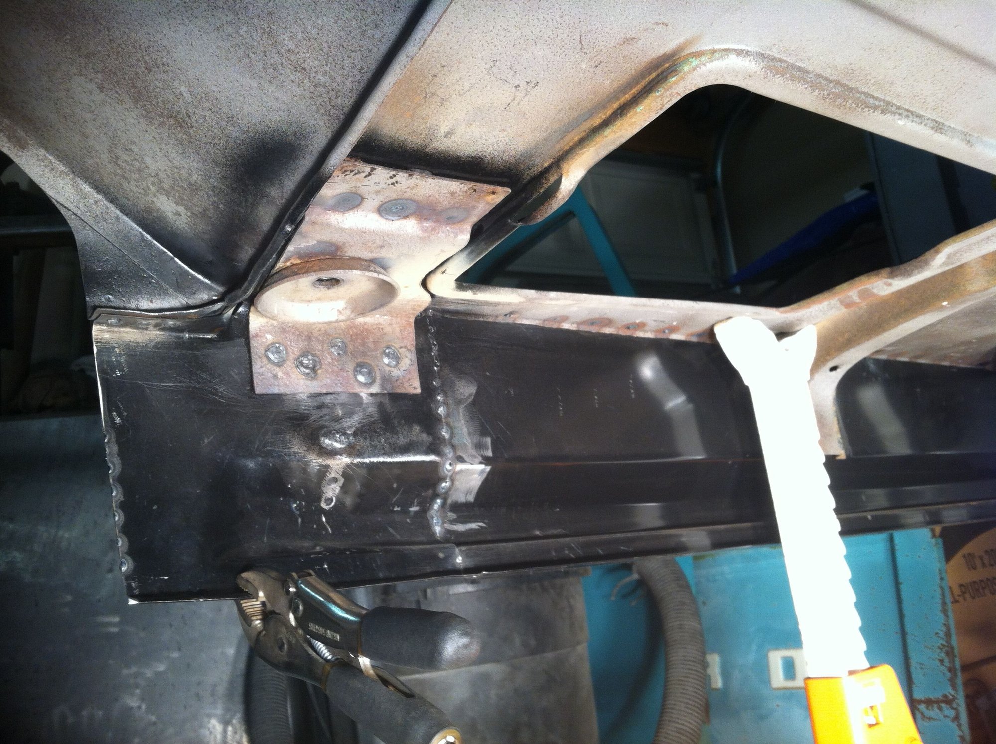

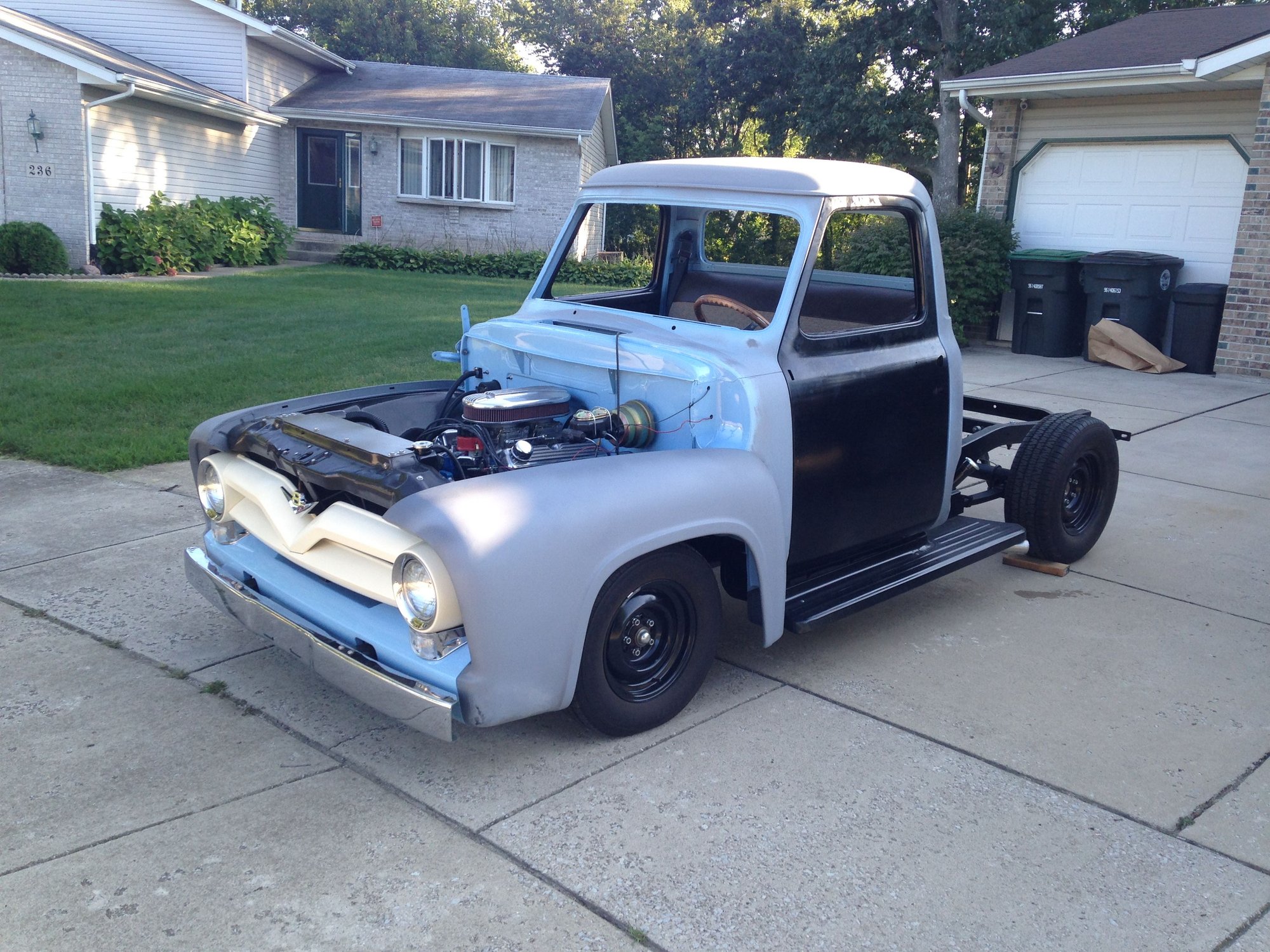

you guys said you like pics...
beginning disassembly
as i got it
frame sandblasted
M2 and painted
9 inch and new rear suspension
engine and trans

Thanks for putting those pictures up. We can all appreciate the work that goes on between each of them! My cab is sitting like your last pic right now ready for cutting/welding. It was good to hear your views on the M2. I went IFS and wondered if M2 would have saved me time over Toyota. But you are right - rebuilt original gets you on the road faster and that is the most important thing after all.

You say the boots on your rack are rubbing the lower control arms . Do you have the thick spacer between the rack and the cross member..? They are about 1 inch thick and solves that problem..

Yes, I have the spacers. They are at least an inch thick- might even be more. The rub is not horrible, but they are rubbing. I’ll live with it, but as I had said just seems not fully thought out. It’s from a well known company- they could have seen it was a problem by just bolting it all together where they make it. Aftermarket stuff isn’t always what it’s made out to be.

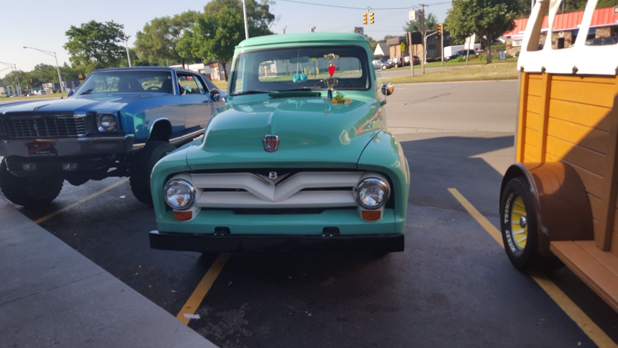

Restored my 55 to original except clear coat paint.
All myself except body & paint.
And I love it. It looks awesome! Except for those amber turnsignal lenses! Haha.
You need to post more often so we can see more pics of your awesome truck. What is the name of the paint color?

We bought our Mustang II set up from No Limit Engineering - it's had it's issues. Can't get the alignment perfect
and it does rub a bit - but we've got 35K miles on it. I think it's hard to get these front ends welded in there perfectly.

Originally Posted by 55f100guy
Fking1,
that is beautiful! Looks like the same color mine was originally- sea sprite green. I’m green with envy myself...
Sea Sprite Green it is, clear coat enamel which was not factory.
Believe white is Snow Shoe White.
