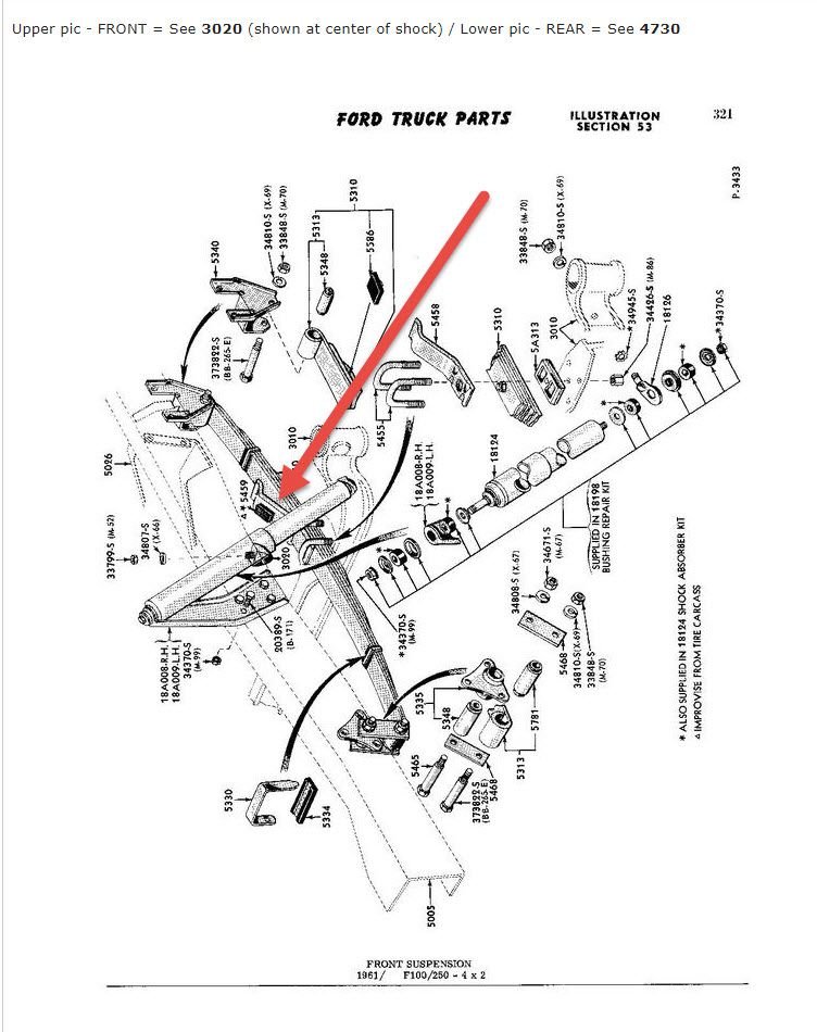

Bump Stop (rebound bumper) Install
Originally Posted by oldracerjones
Anyone have a bump stop installed on their truck suspension to keep the truck from going lower than a set amount? If you do, could you post a picture of it and where it is?
1961 F100 2WD:
Upper pic - FRONT = See 3020 (shown at center of shock) / Lower pic - REAR = See 4730

Hello
I have a 1962 Ford F100 . It came with a 6cyl and was swapped out to a 292 Y block - I'm going to change out the front leaf springs- The springs that are on it now have a a bump stop as shown in the image of this thread for a 1961 = specifically part number 4* 5459. Its a short bent piece with a stop on it-
I copied the diagram and put a red arrow on the part I'm talking about - The new leaf springs do not have these- Should I put these bump style ones back on with the new springs or use the rubber ones that are for a 1962 that look like they bolt onto the frame instead -
Appreciate it -
Art

If your new springs have the slot for those rubber pieces you pointed to I would install them. But I also would install the bump stops on the frame... You can probably find something to work even if it is not the original ones.
Old Aug 16, 2021 | 07:15 PM
BobbyFord's Avatar
BobbyFord
Joined: Jun 2003
Posts: 3,919
Likes: 271
E5TZ-5A636-A fits into those slots, you just have to trim the sides a bit.

Guys, he has a Mustang II front suspension, nothing stock F100 will work!!
