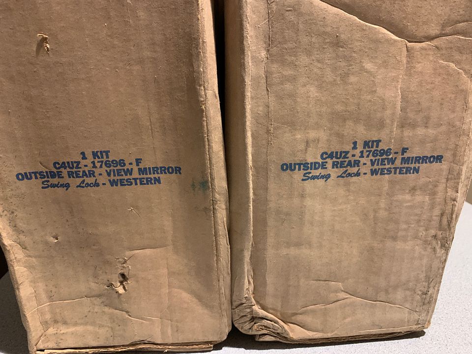

I think Steve is referring to the stainless bolt kits - they are actually put together for the 1967-1972 mirrors, but almost everything is useable for the older swing-lok mirrors.
1967-1972 Ford F100 F250 F350 West Coast Jr. Mirror Stainless Hardware Kit | eBay
I have a new set of the Econoline mirrors. Same as the stainless ones for our era of trucks. The swing-lok style from Ford uses one large spring washer that allows the pivot and then lock into place at the two positions, folded in and extended out. They call it the "Spring Pivot". There was a guy also making replacements for those pivots out of stainless steel that I bought some from.
C4UZ-17696-F - MIRROR KIT - REAR VIEW OUTSIDE - Western Jr. - swing lock - painted - R.H. or L.H.
