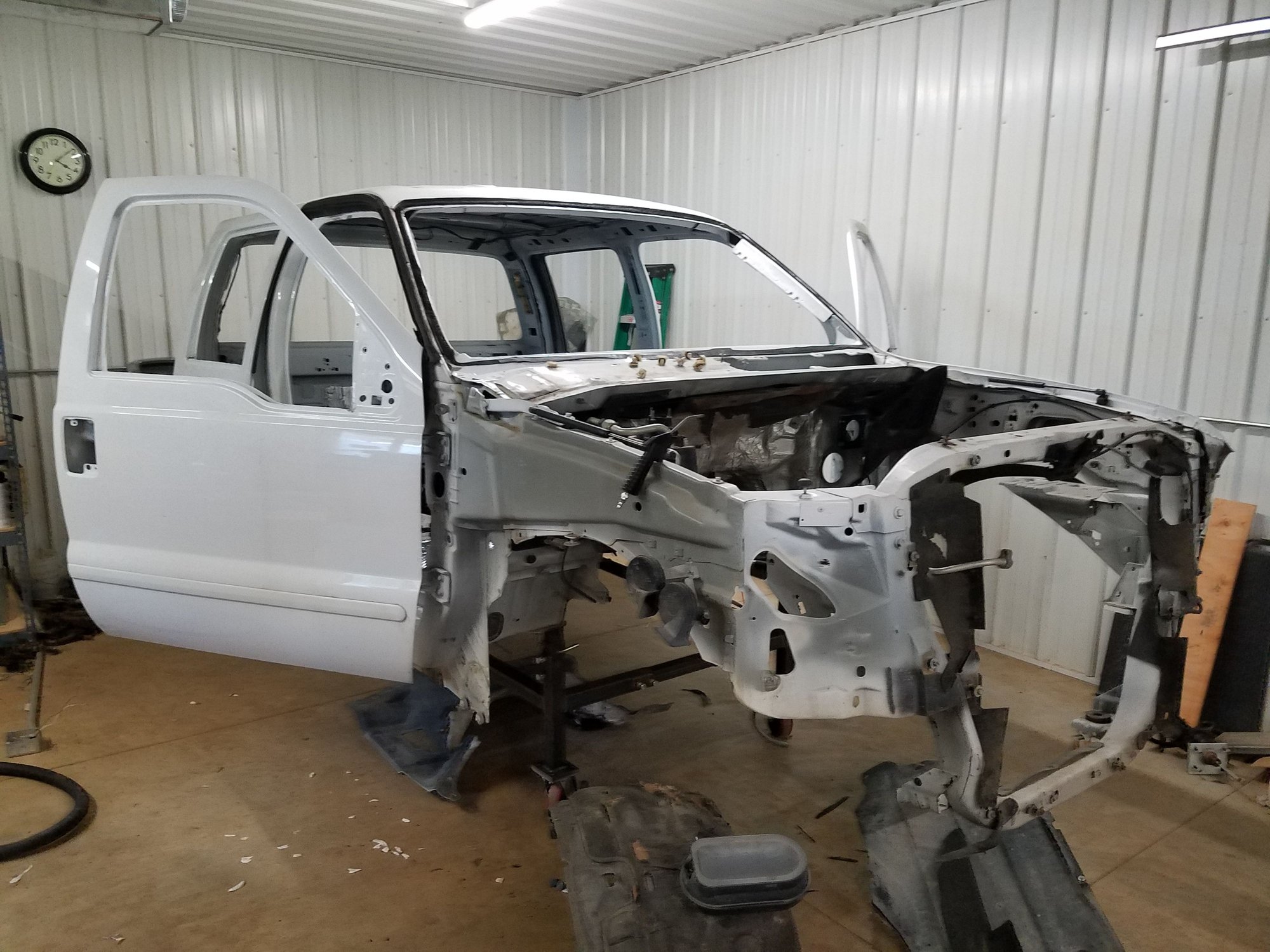

I have a crew cab on a body cart right now. I could not recommend going about it how you are thinking.
