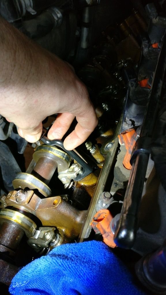

Well I finally got around to getting started on this. It was a pretty big pain to get that valve cover off. I had to drain the coolant as there were several heater hoses that had to be disconnected and that rear bolt closest to the fender was a real challenge to get to. I had to remove the rearmost cop to make room for the cover to come up and out. I also ended up breaking one of the plastic vacuum lines. I did find that the valve spring tool designed for the 3v engine will not work on the 2v. The legs aren't long enough to go under the cam and reach the edge of the head for support. It's also too fat to fit between the lobes and the cam supports. The 2v tool was real awkward to use so I used the pry method. I saw where a lot of guys used a screwdriver but I found the 3v tool made a perfect pry tool without the risk of hitting a cam lobe. Actually changing the lash adjusters and followers was much easier than the valve cover removal.
This is at just over 213k. Not sure if it looks good for that mileage or not.
Here's the 3v tool positioned to pry and pop the follower off.

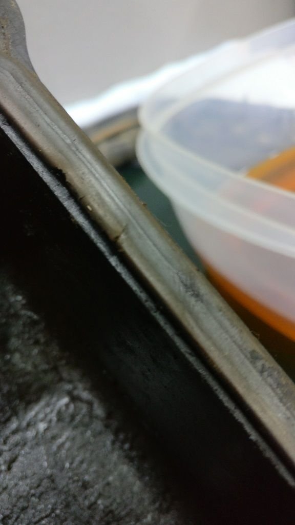

I must've somehow nicked the valve cover gasket while removing it. I think it might have snagged a cam bolt in the back. Do you suppose this gasket is still re-usable? I hadn't really planned on replacing them.

I also ordered the 3v tool and confirm it does not fit. Returned it. I had to improvise a pry tool for the different areas. Balance shaft in head and cowl clearance in rear makes it very tight. Inner mist one is done blind, absolutely cannot see anything.

I think your valve cover gasket looks fine. Don’t forget the rtv dabs at front timing cover.

I hope it helps, and maybe helps someone in the future. I know I searched and searched for some info on removing the passenger side valve cover since it looks so tight in there. I found basically no info. It was a challenge for sure, I think I'll remove the remaining cops just to get a little more room to get the cover back in.
You are correct about having to do the follower in the back blind, there's no way to see back there. I thought about returning my 3v tool too but once I found it had another use it made it worth it, it was a cheap knock off anyway since I wasn't sure it would be useful at all.
