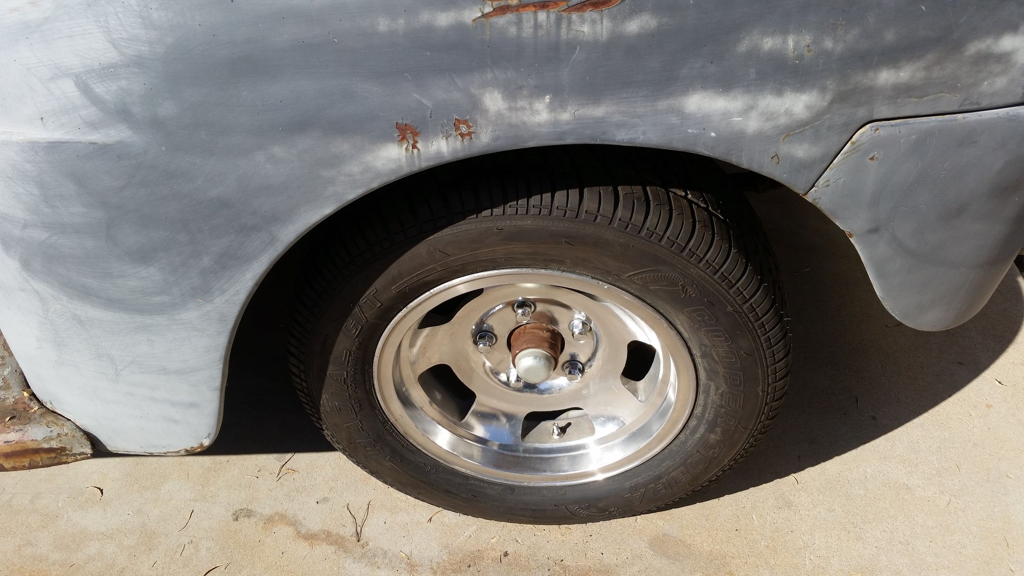

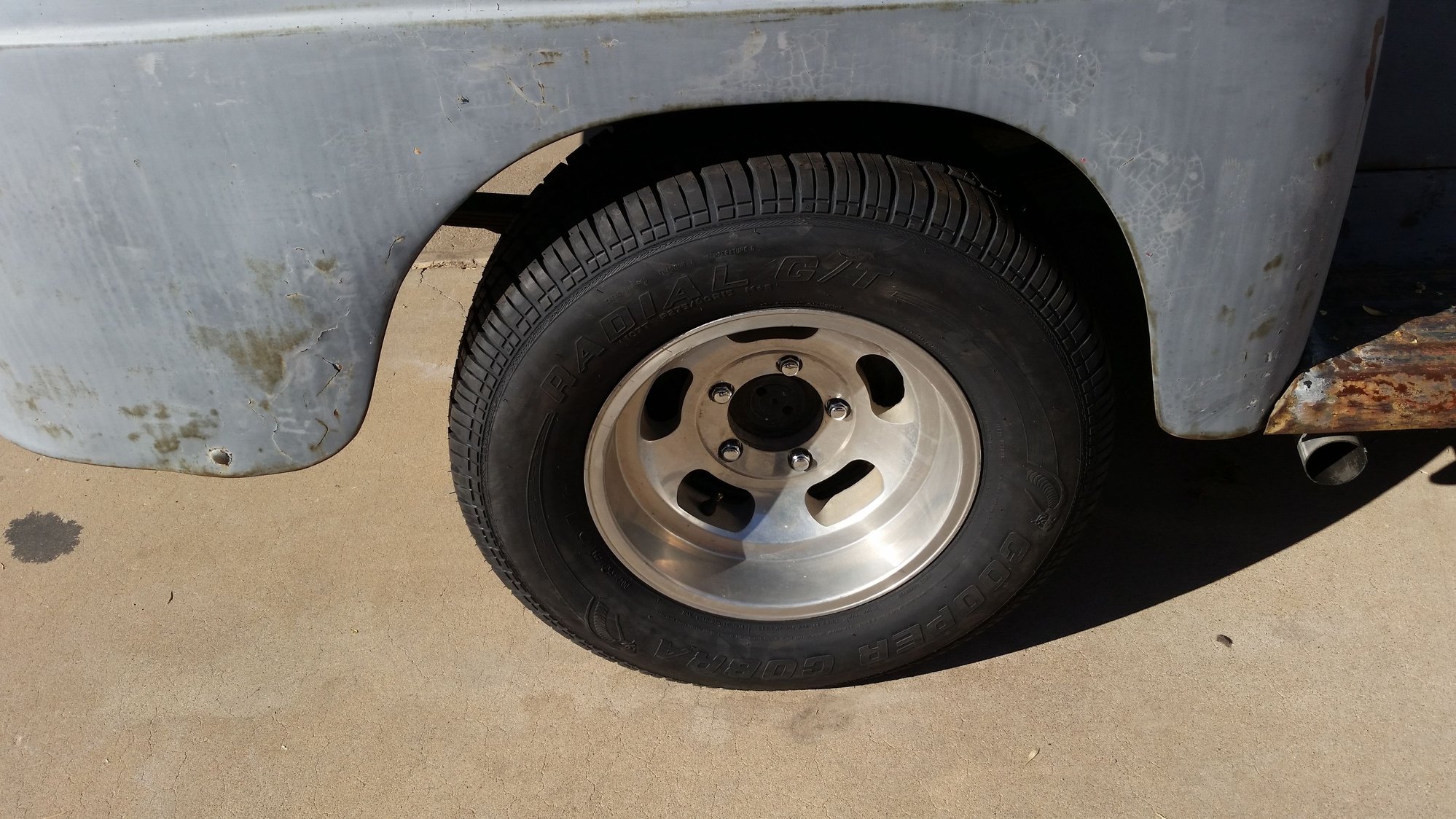

I like and running the Cooper Cobra Radial GT Tire on my '49 F1. What Brands are you unfamiliar with?
275/60R15 on rear
225/70R15 on front
