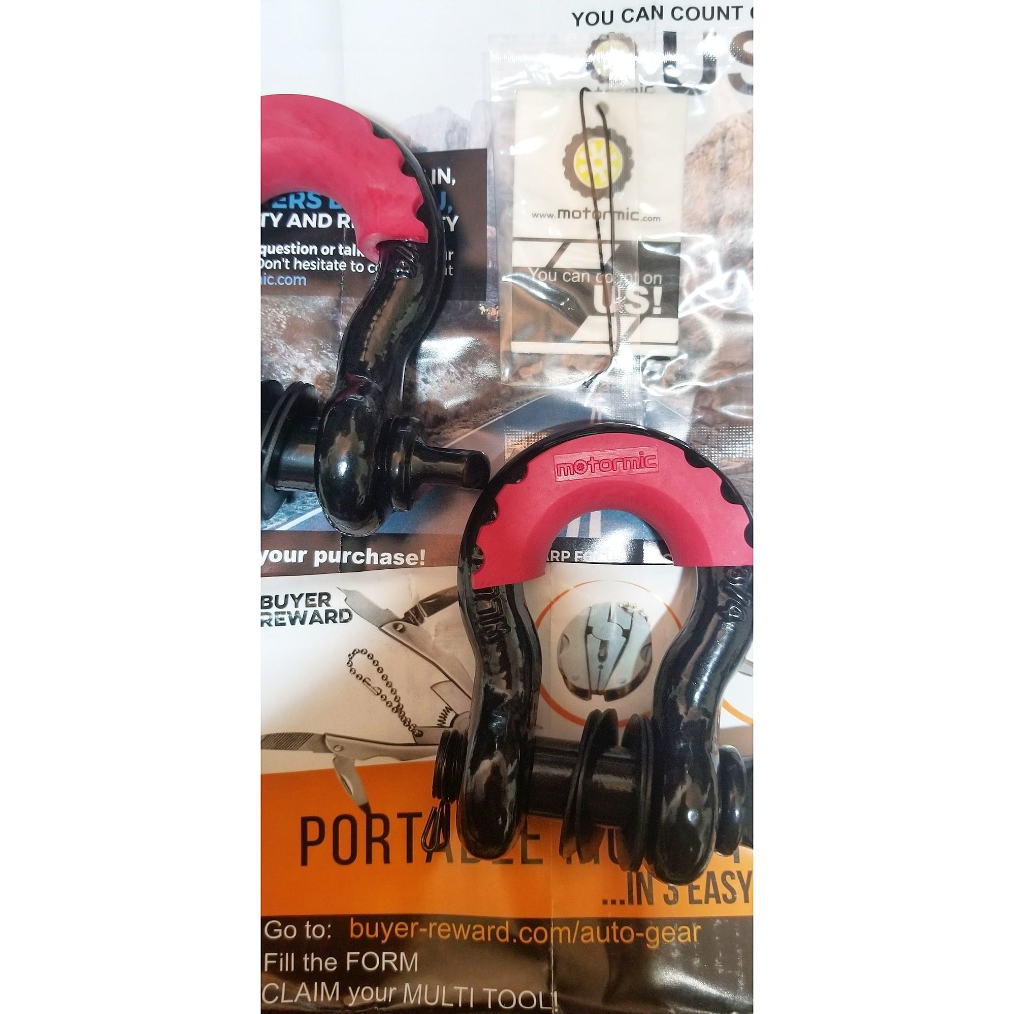

I bought these off of amazon, 3/4" shackle, seems to be the normal addition to the oem hitch to fit all the safety-chain hooks, you can probably go one smaller to fit smaller hooks.

A 5/8" shackle is what you need. 3/4" shackles are too big.

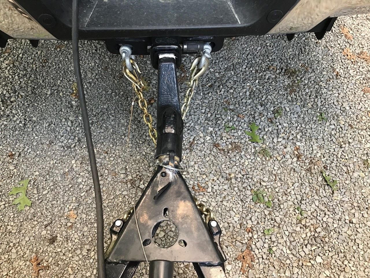

This is a good setup: Chains are crossed, hook opening facing in and to the rear. This is a proper hitch up, if you are NOT doing it this way you are doing it wrong. The only thing I would add to. this set up is the screw in pins in the shackles should be safety wired [either by wire or you can use nylon ties]. I use the nylon ties and pull them tight so as to not get pinched. You can also fold some threads on the screw in pin which makes it difficult to screw in/out, if you do it right it will provide enough resistance so as it will not work it way out or unscrew.
Down to 3 trailers from 5 [US Army issue, Tractor Supply, Big Tex, Northern Tool, Costco]. All of them had chains and all my chains fit my OEM 3 in hitch assembly. Would like to see some pics of chain hooks that don't fit, I have never had a problem.
I am amazed at some of the lash ups I have seen over the years.
