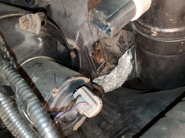

Subford called it on the trash. Had no idea it could get down that far.
Unfortunately I can't find any residual stink on the resistor pack or the fan.
Ran the fan & sniffed on the motor vent, nothing.
No distorted wires or connections
Coils on the resistor pack clean & silver. Thermal fuse MAY have some discoloration or it could be dirt.

Solved. A spark plug wire seperator had come apart.
It fell down on the header & since they are wrapped, it did not fully melt & burn.
While checking timing, saw a little wisp from tween 3 & 4, hit it with flash light & there it was down leaning from boot to header tube.
Thank you all who responded. Just thankful it wasn't a fire hazard & I got the trash off the resistor preventing another.
