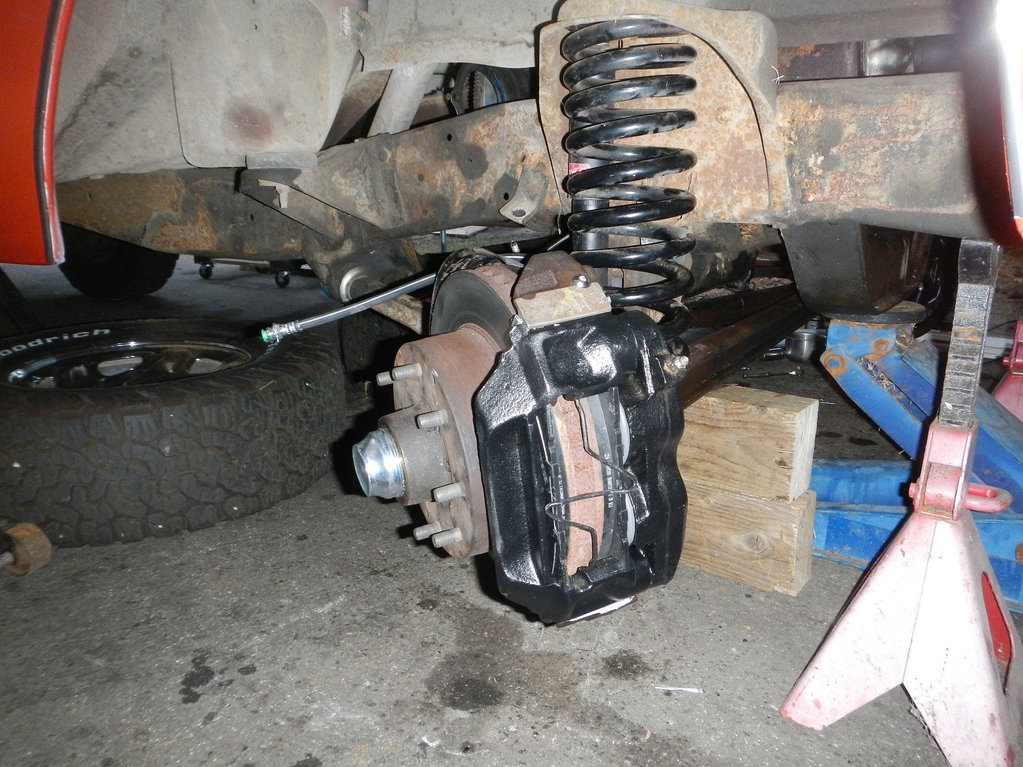

I have to do my radius arm bushing and wanted to check if you had enough brake hose to roll everything forward. Or did you disconnect the hos at the fram rail?
When I did mine I did everything in the front end but the brakes. I left those intact and pulled the backing plate and hung it from the frame on a wire. It seems like it would be a tight squeeze with the brake line on. If it needs to go, yes. Undo it at the frame.

Just to make some aware this method is not fool proof. I am now into the 2nd hour trying to put the first radius arm back in. Even with springs and shock out it was impossible to roll the wheel far enough forward using my arms and so I needed a tie down to ratchet it out. With the arm out in its out and down position it is impossible for anyone to manhandle back to the correct position to insert in the hole. Even with tie downs laterally and in the front one runs out of room before the front tire hits the lower corner of the fender. Someone else I told this about is having the exact same problem despite a sheet of the instructions. I learned I can't put the rubber bushing on first as the arm will not go straight in without damaging the bushing. So while the arm came out easy enough with the use of a tie down it isn't going back dead center when the bushing is on. So this 1 1/2 hour job could very easily be 8 hours. I'm sorry I told someone else this would be easy as he has learned.

Post pictures of what you're working with tbm3fan. I did those bushings last week and managed to manhandle them myself in about an hour, granted I was doing them along with kingpins and wheel bearings, so I had the whole front suspension apart at the time.

What I learned doing mine.
The first time I went at the radius arm bushings I actually used the winch on my other truck to pull the I beam forward ( spring and shock removed ) but that is what I was told what it would take. Don't do it! There is to much stress on the I beam pivot point.
Fast forward about a year.
Installing a 79 F250 set of beams and discs.
Take the time to drop the I beam pivot bolts and pull the I beam. From here there is no need for the winch and makes the whole process effortless. Good time to replace the pivot bushing to.

Yes, I wondered about the stress on that pivot bolt. I did drop the spring and eventually found that on the passenger side the wheel needed to be hard left. Even then there was 3/4" left in the bracket despite my legs on the tire. The tie down ratchet pulled the beam forward enough for the arm to pop out and it popped down and out. Slight damage to two threads that needed to be repaired. To get back in place needed a jack under the arm to raise, a tie down laterally to pull in to just center the threaded portion. Now the second tie down to pull backwards into the hole in order to get the back bushing on, the washer, and the bolt. Once the bolt was on I could use it to pull the last 1/2" in. This was a major process and there is a lot of tension on that arm. No way I could put it back without those tie downs and jack. Couldn't begin to move it up and in while moving the tire back.
For the moment I am going to leave the driver's side alone since the passenger side front bushing was smashed. At least I can move the truck to get the Cougar and Mustang out. I will no doubt do the pivot bushings but will I have to pull that one arm just done to now do the I beam pivot? Ugh! Driver's side no problem as all at once. Does Ford still make the pivot bushing??? Oh, and did you break the torque of the pivot bushing bolt with what??? In the meantime my spring housing looked like yours but not anymore.

The shop manual says to remove the spring, disconnect the steering and remove the bolt that holds the radius arm to the axle. Then remove the radius arm. With that bolt out the axle only has to move a short distance forward to clear.. If you ever plan on a front anti sway bar, while all that is apart it is a good time to source the radius arms and brackets from a newer truck or van. I got all that stuff from a 78 F350.
