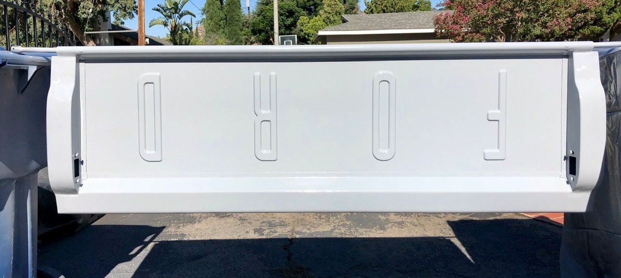

I am looking for a clean tailgate as well.
My tailgate is fixable but it has more rust than the overall truck, and the truck deserves a good one.
Has anyone purchased the aftermarket tailgate from Dennis Carpenter?
If so, can they describe the quality?
Here's my truck.
Thank you

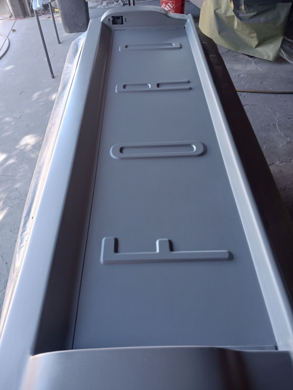

I primered it

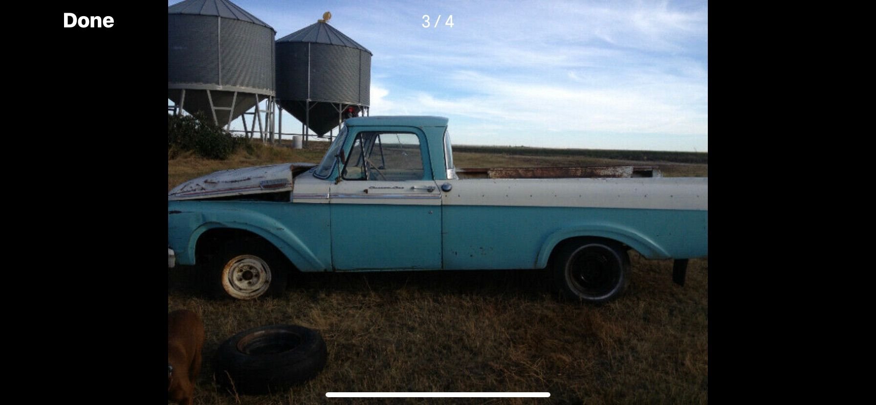

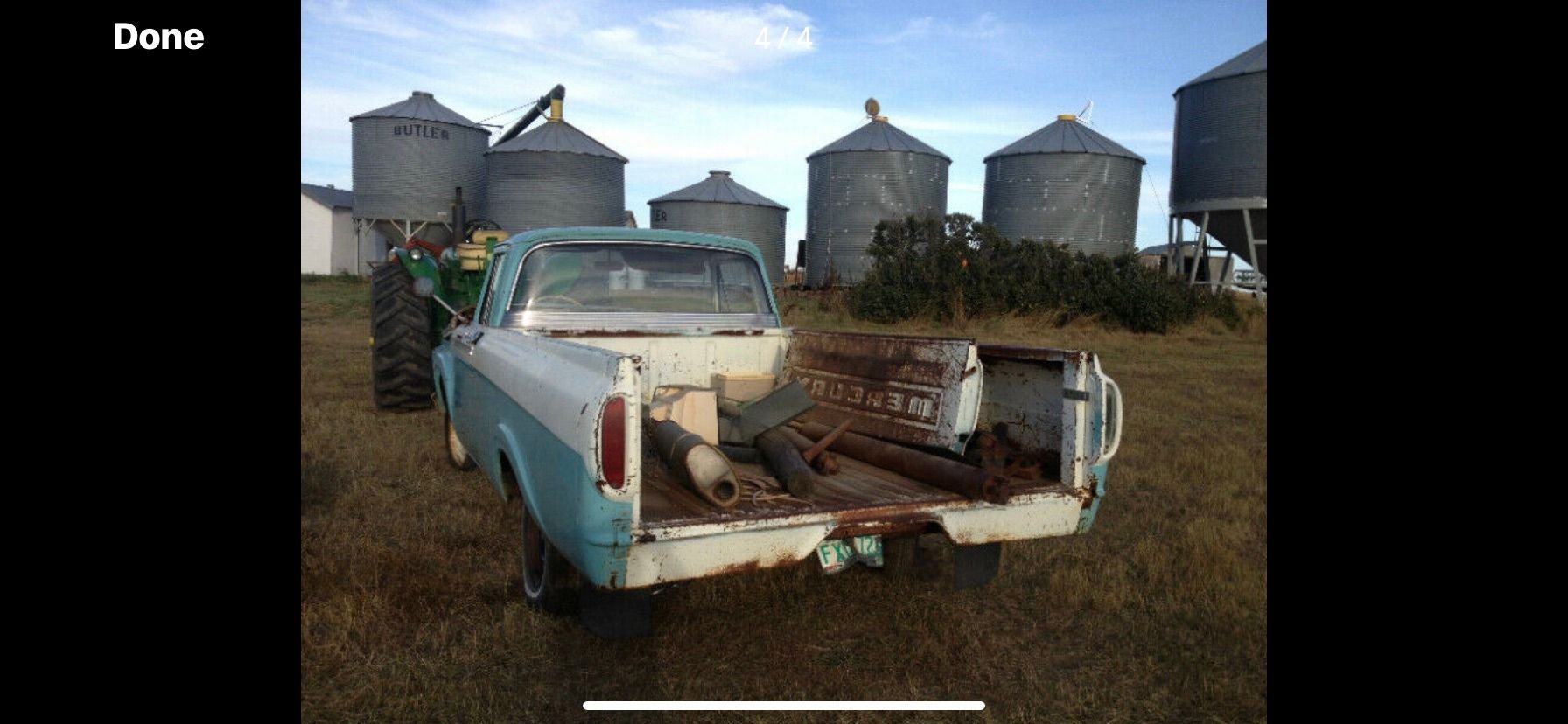

I just missed out on this unicorn by a few hours. 1963 Mercury unibody big back window. Doug.

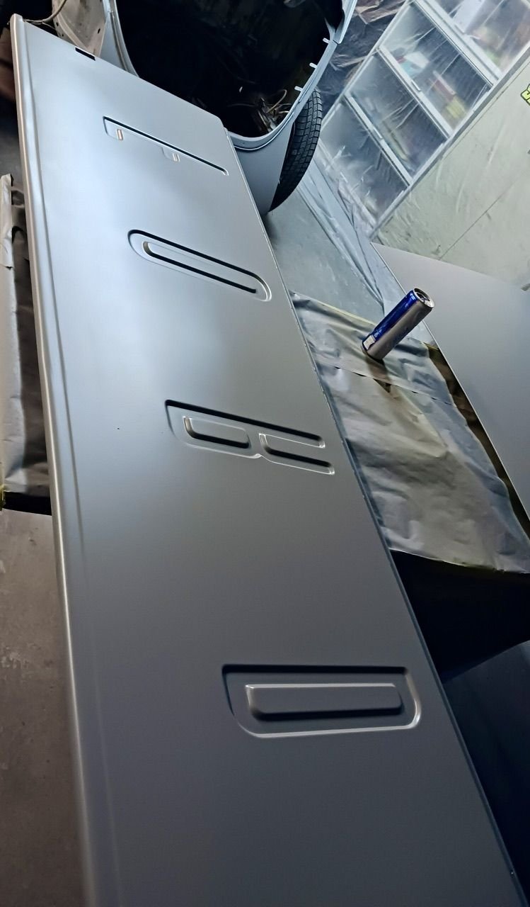

It’s been pampered a little.
