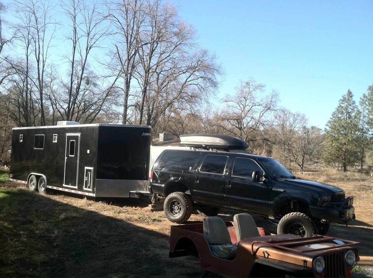

here maybe this will help.
i tow 14,000 lb 32 foot race trailer and i have a 8” 375 lb inch rear spring. works great and have towed it 10s of thousands of miles
