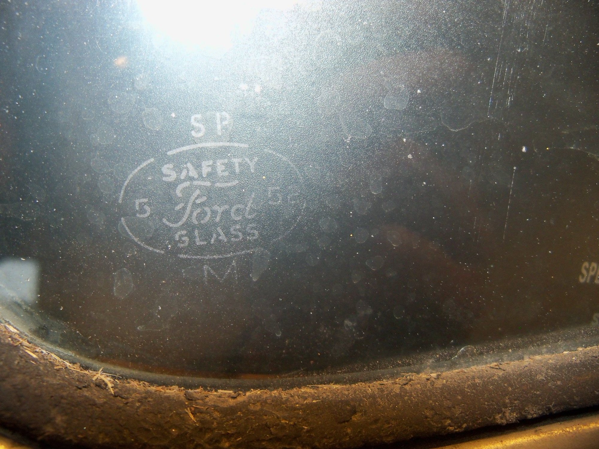

The letter P would indicate a 1952 model truck. With a low unit number, 8746, it is an early one. If your factory glass is still installed, you might look for a date code with the Ford script logo. Let us know what you find.

Ok where yours say SP mine all say SS and also with a M at the bottom the back window has a 1 52 drivers doors has a 12 51 and passenger door has 12 55 I would put up a pic but I have trouble enough doing this the windshield only has F&F safety glass on it so would it be a 51 or a 52 thank guys for your time .

The date code in the glass identifies when the glass was made. It was likely a month or so before the truck was built, factoring in manufacturing and delivery time to the assembly plant. Date codes of 12 51 and 1 52 would not be unusual for a truck built in late January or February, '52, which corresponds with your unit number. The right side door glass and windshield have obviously been replaced. The year code in your serial number is quite clear, P = your truck is a 1952 model. I'm not aware of any assembly date codes on Canadian trucks.
