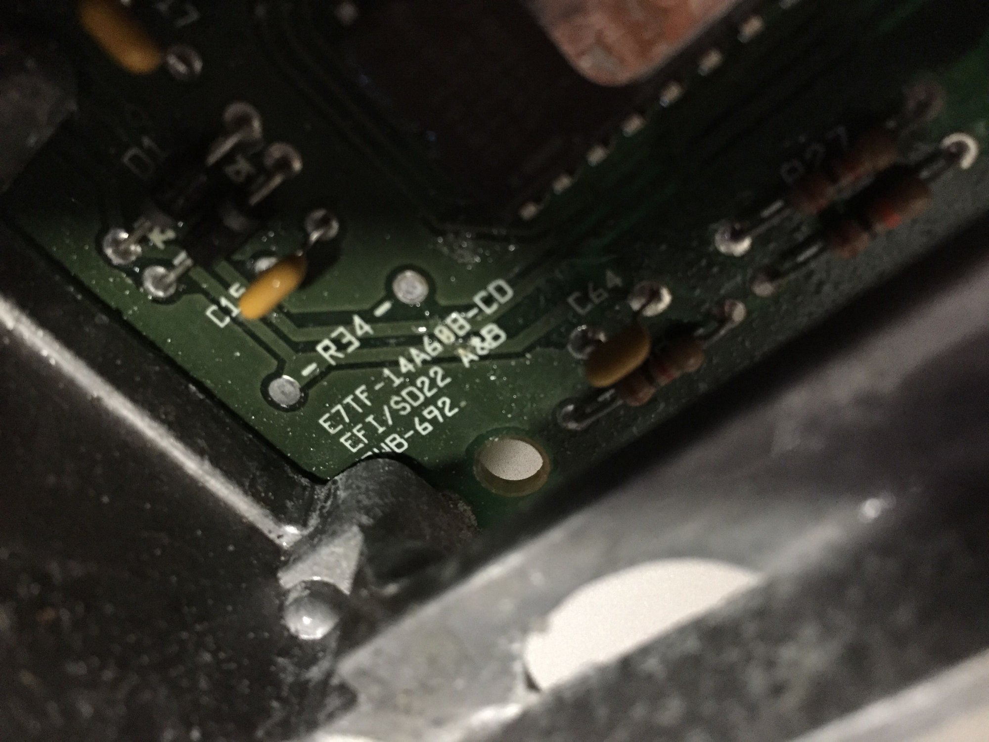

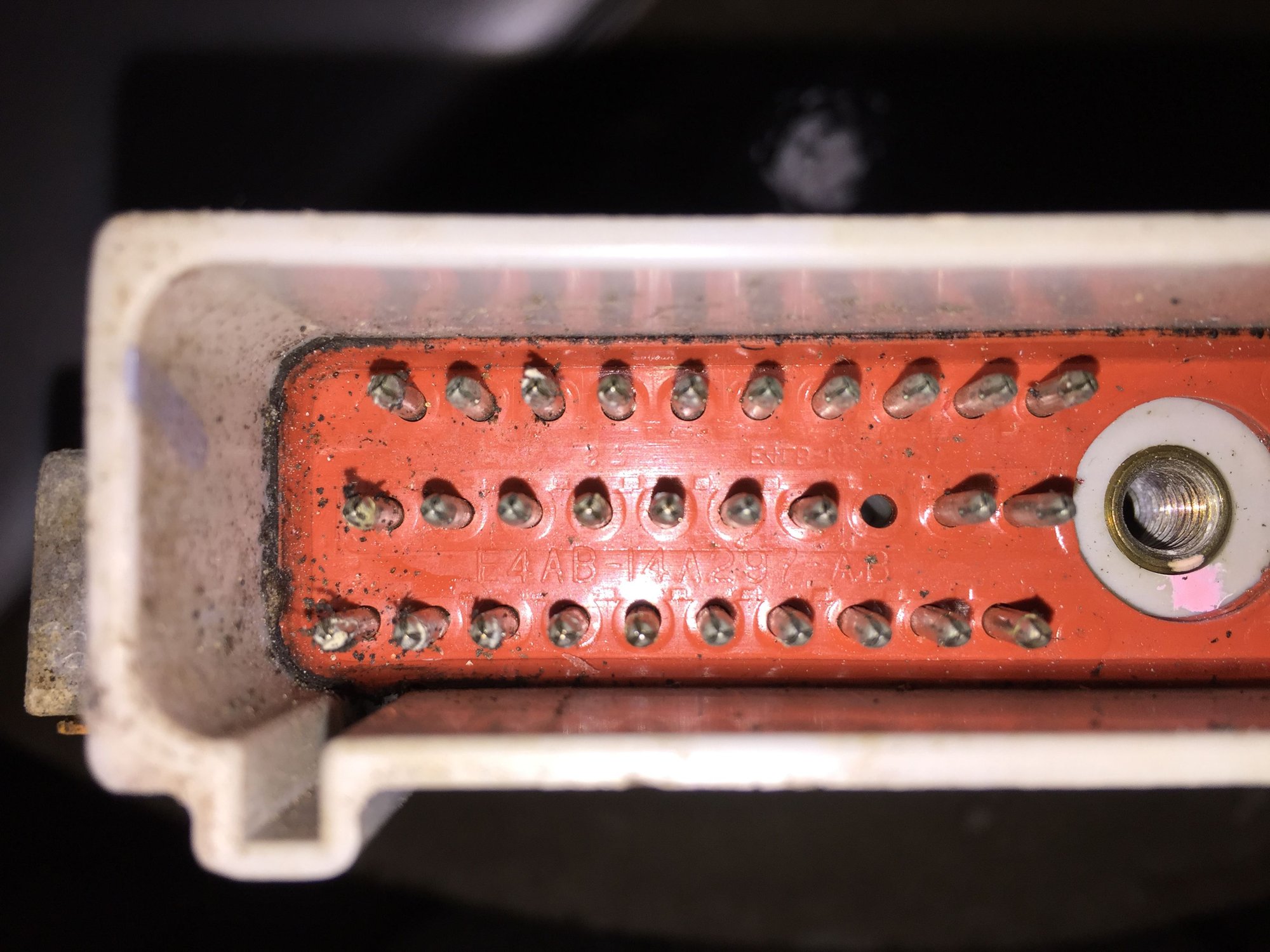

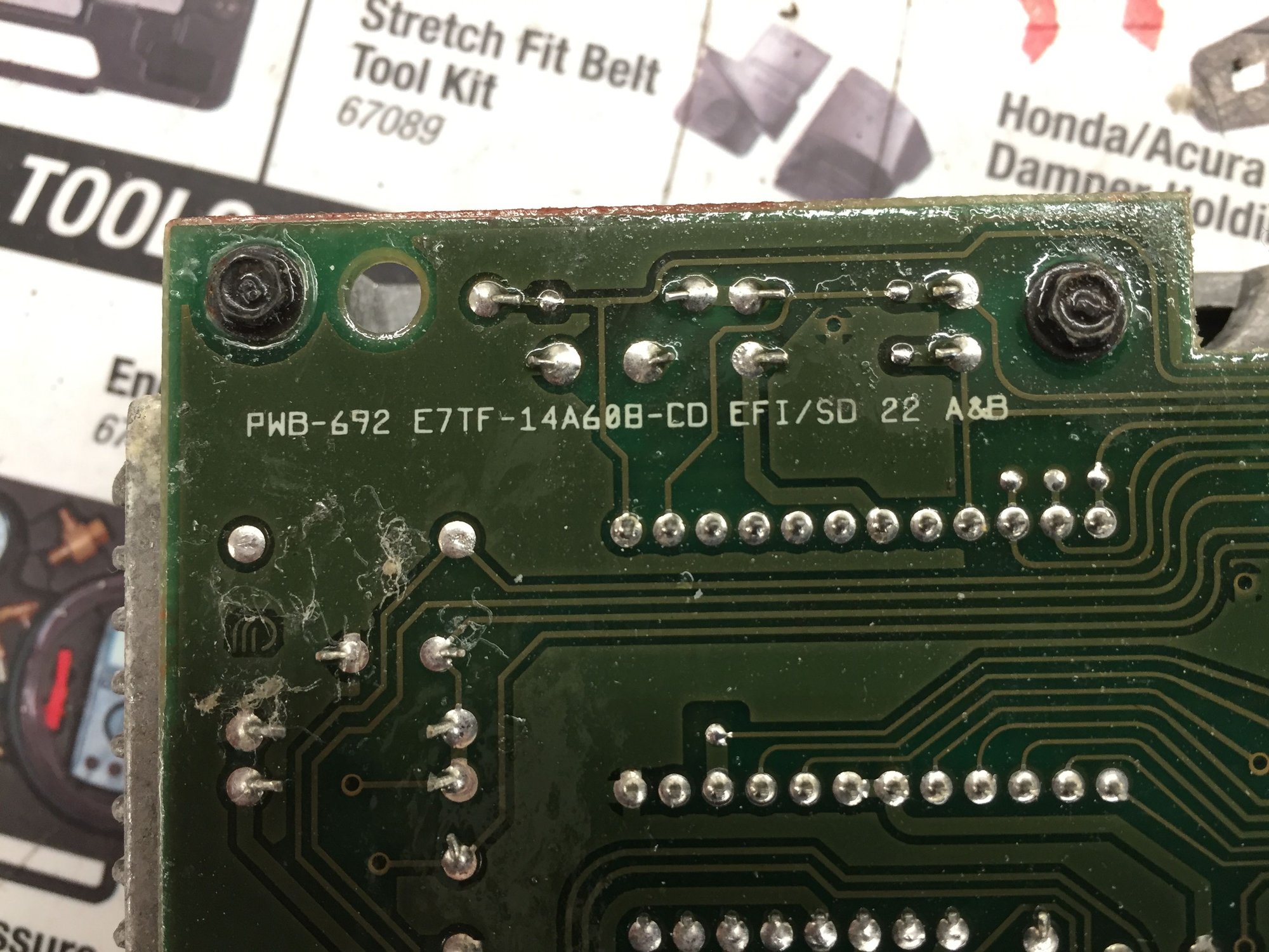

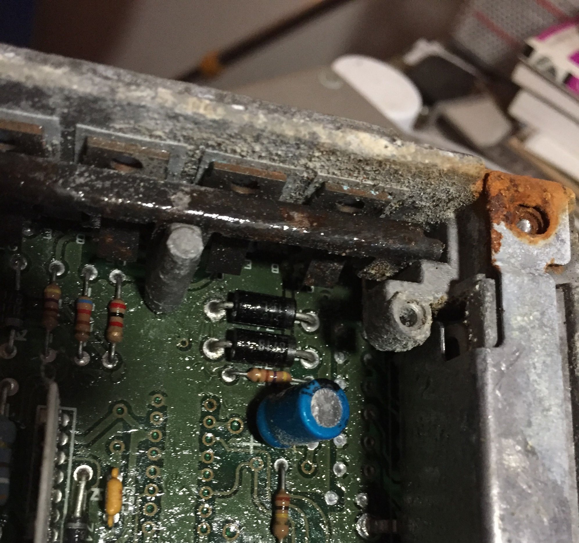

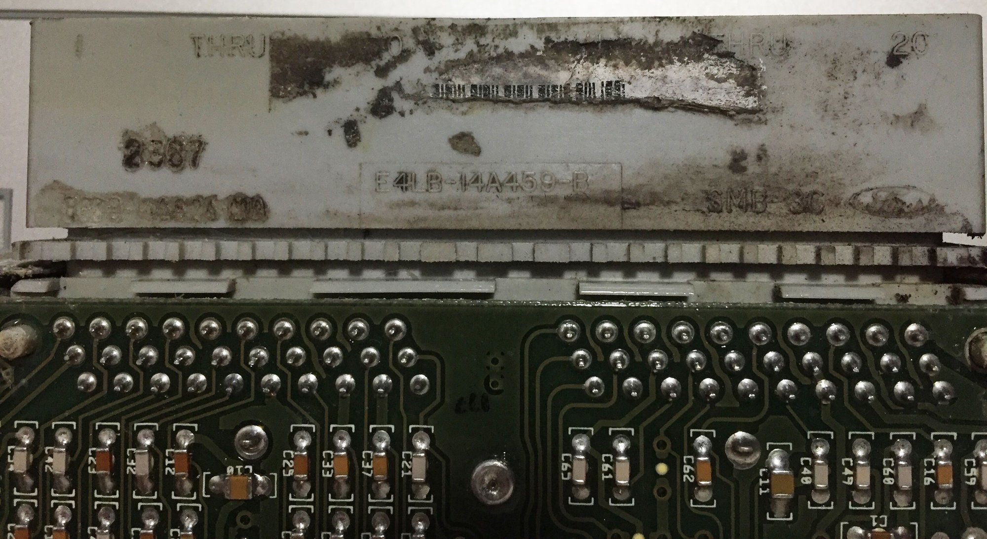

Pulled the ECM/Computer to check the capacitor. On removing the connector to the ECM, one of the pins came out, see photo. Tried to see about a new/refurbish on but ran into a problem finding the OM/OEM numbers. I did find numbers on the PC board, but can not find a match online or at the auto parts store. I have attached Photos of the module. Any help on finding the correct ECM to get (pre-programmed) or find the correct OM numbers.
The number on the board is E7TF-14A608-CD, only parts I can find for the year and engine (87m 5.0L/302) are E7TF-12xxxx-xx.
Thanks,

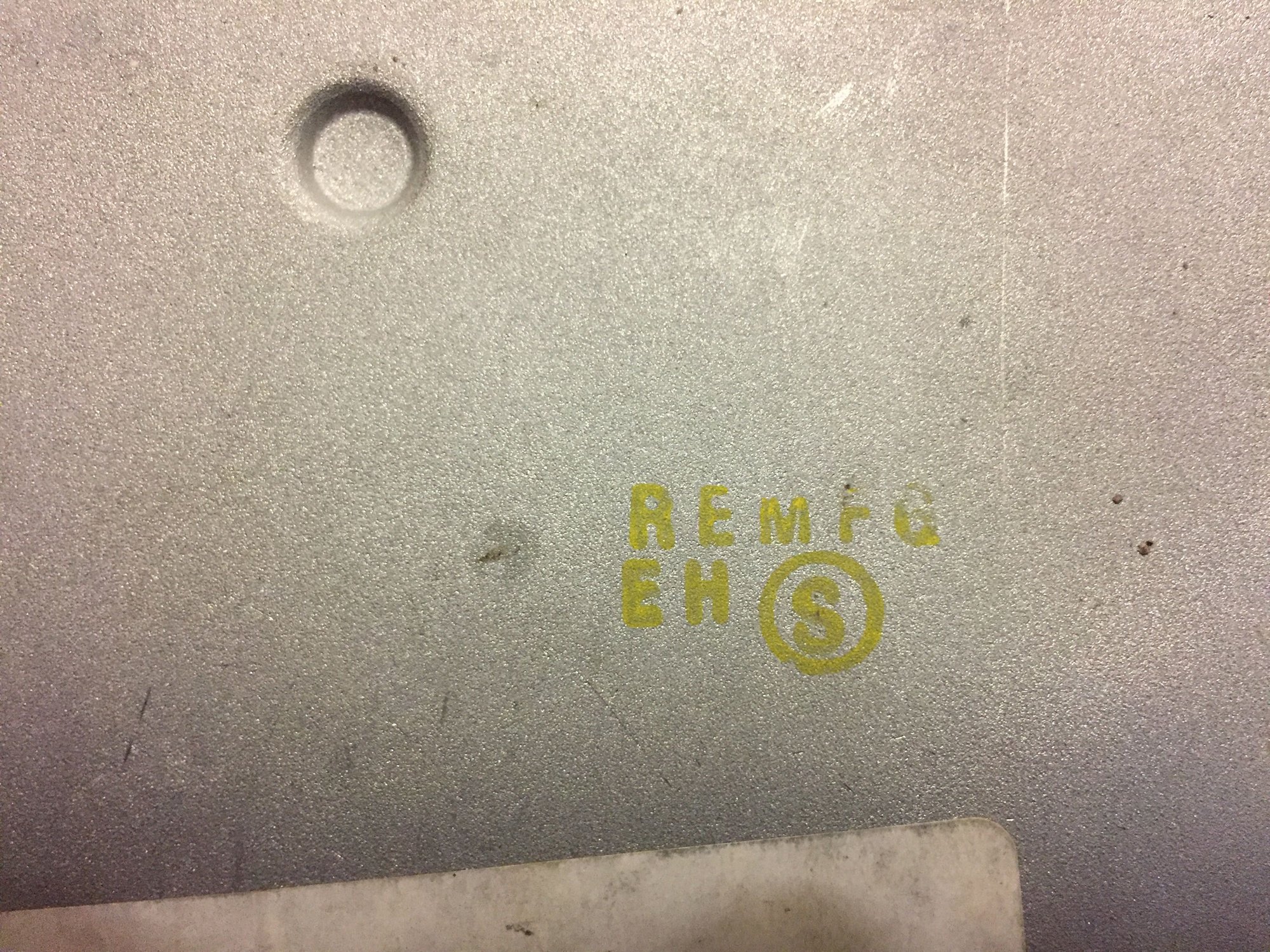

Those engineering numbers are generic for every PCM Ford manufactured for these trucks. You need the "catch codes" listed on the sticker attached to the case cover. I see "REMFG" in one of the photos which means someone previously has replaced the PCM. Another photo shows 4446 etched into the connector so I would guess you have a Cardone 78-4446 PCM installed, Ford Part# E7TF-AUA/AUB
I also see signs of water intrusion. Before installing a replacement check the cowl seals for signs of leaking.

As stated before your current PCM is a remanufactured Cardone brand with Part# 78-4446. It is listed to fit your 1987 F150 w/5L engine, auto transmission and Federal Emissions. Cardone 78-4446
Is it an exact fit? hard to tell without the calibration code from the door jamb. Is it compatible, yes it is.

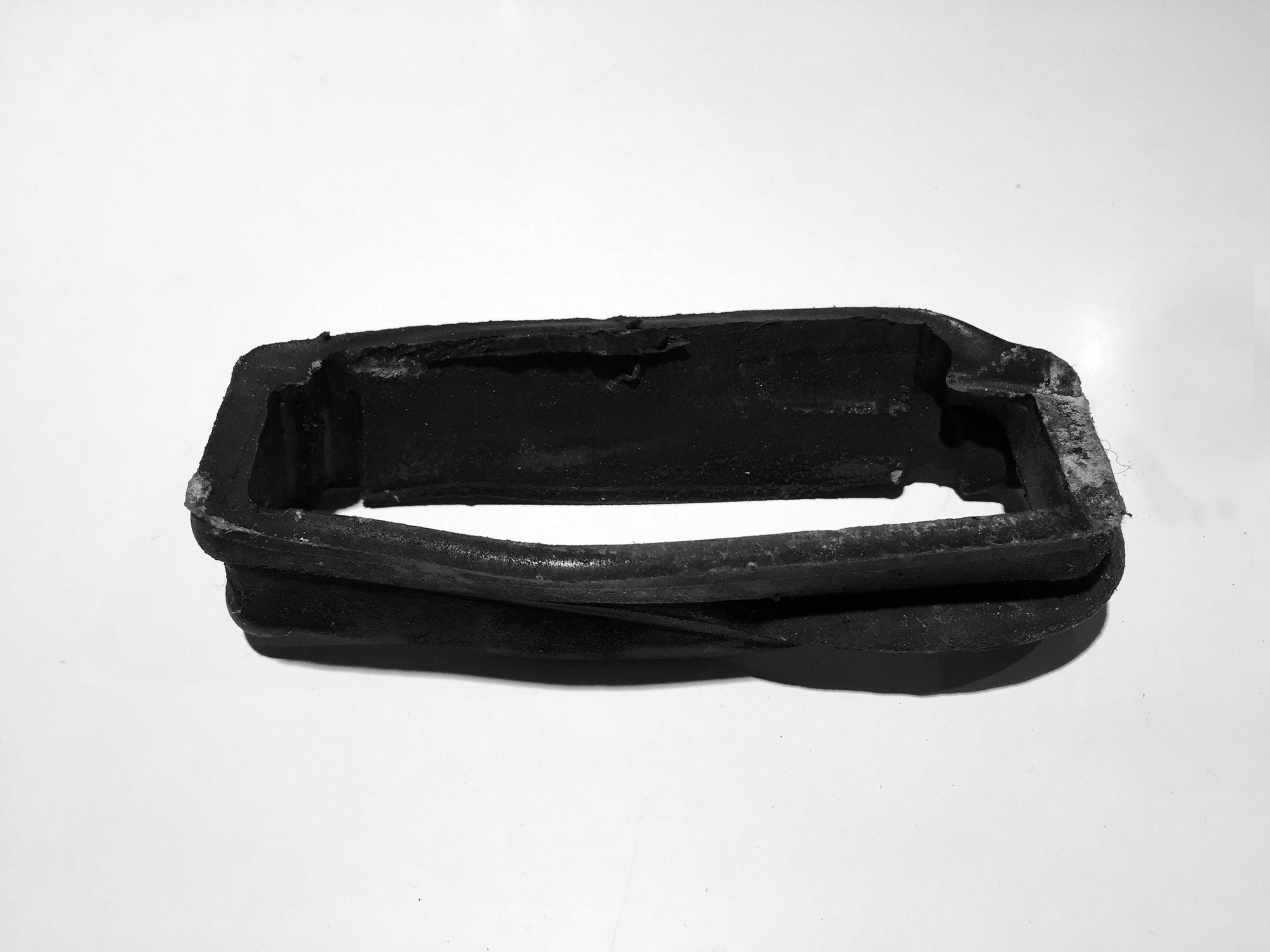

I have the ECM/PCM ordered. Need to find these two parts. One is the rubber seal that goes on the end of the ECM/PCM the other is the holding bracket. The bracket is is behind the driver kick guard. On my model, I pull the ECM/PCM out from the cab. Have seen where some are held in by two 10mm bolts and pull out from the engine compartment.
