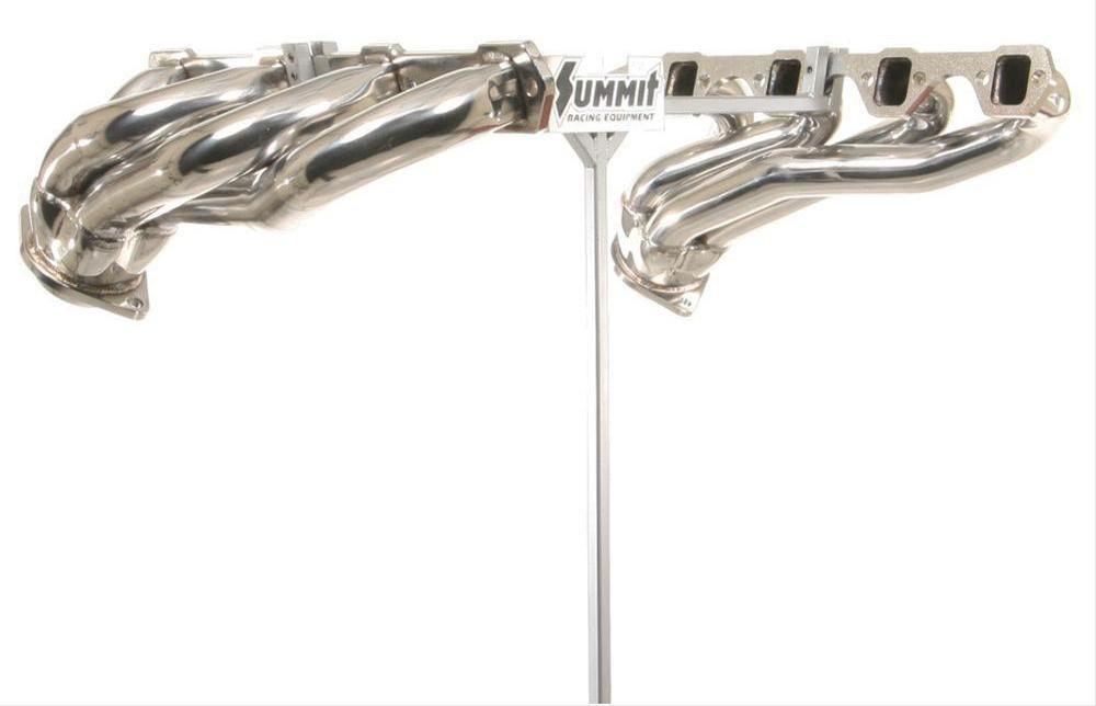

Yep.... I know..... this has been ask ad nausium but I have to get some NEW feedback.
I have been looking around for a decent set of headers. I am thinking about going with "shorties" since there is a better chance for fitting without hitting something (AND... I don't want to use a hammer to alter these guys). I also want a set of stainless steel tubes so they will last a little longer than just carbon steel.
SO.... I see these at Summit.....
https://www.summitracing.com/parts/s...view/make/ford
They are listed for a 302 V8 Mustang so I figured they should fit my truck. What fit-up problems could come from using a set of these headers?

I don't think the Fox Mustang shorties will work on a manual transmission truck, as I read that the driver side header runs into the clutch Z-bar.

Thanks for the advice.... I guess I just figured since they were short, I could run my straight pipe to miss everything.
Back to the drawing board!
