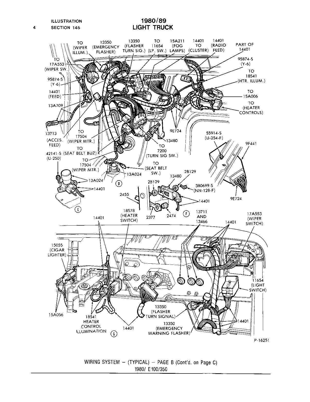

Where is the turn signal blinker at in my 1987 E350 460 cutaway (camper) ?? I can barely hear it, and it sounds like it's up in the dash somewhere behind the cluster...but damn if I can see it, or reach it.

Lower pic shows the location of both flashers. Both look the same and have 2 prongs, but the 4 way emergency flasher is a heavy duty flasher, as it has a louder CLICK
This heavy duty flasher (industry number SF-552-B) was also used as the T/S flasher with trailer tow, plus dealers installed it for people that were deaf.
I installed this H/D flasher on every 1960's/90's vehicle that I owned because I was deaf as a post before I got hearing aids in the late 1990's.
People asked me why I was so deaf at an early age, my response was "too many magnums" and I wasn't speaking of bottles of champagne.
Bill,
Thank you for your service, brother, and thank you for the reply. That diagram shows them about where I can hear them. I just can't see them. There is some kind of large, metal plate right there. Impossible to see, or get my hand in there. Guess I'll hae to figure out how to get it out. THANKS again !!!!!!
