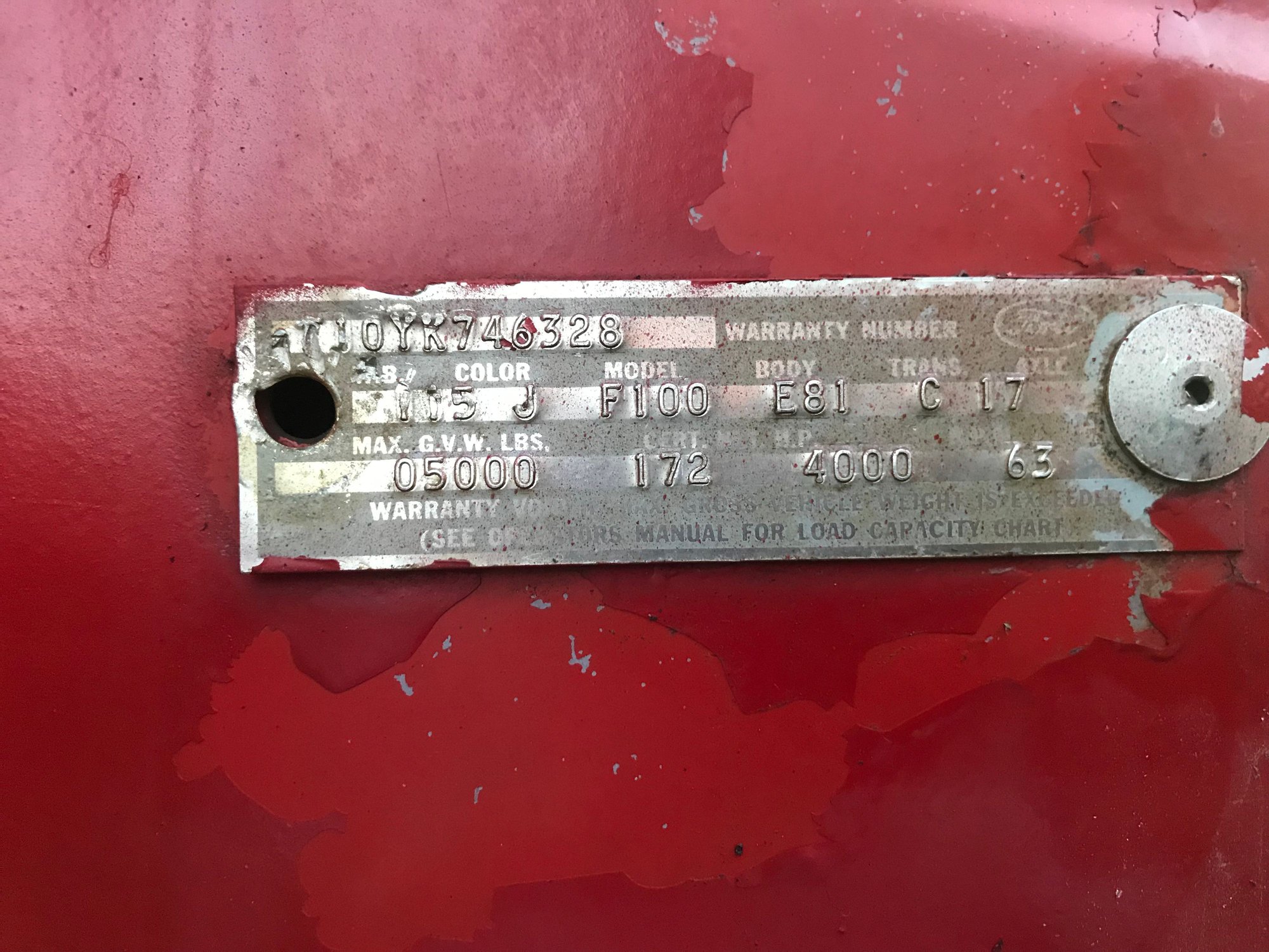

Originally Posted by ruger761
Its a short bed. Havent had a chance to de-code the VIN yet to see what all options it truly had from the beginning but will do that soon.
When you get a chance post a pic of the warranty plate and we can decode it pretty quick.

Hopefully you can read it. 115 is the first code

F10 Series code, F100
Y = 352 2V for '66
K= Kansas City MO, assembly plant
746328 = Consecutive unit number, built in September 1965
115 = Short wheel base
J = Rangoon red exterior color
E81 = Trim Code for Custom Cab with red crush vinyl and cody weave pattern
C = trans code, Ford 3 speed 3.03 fully synchronized
17 = axle code, 3.25 open 9"
63 = Memphis District Sales Office where it was ordered.

Awesome, thanks for the info on it. Sounds like it’s somewhat still in stock form, minus the trans as the biggest change.
