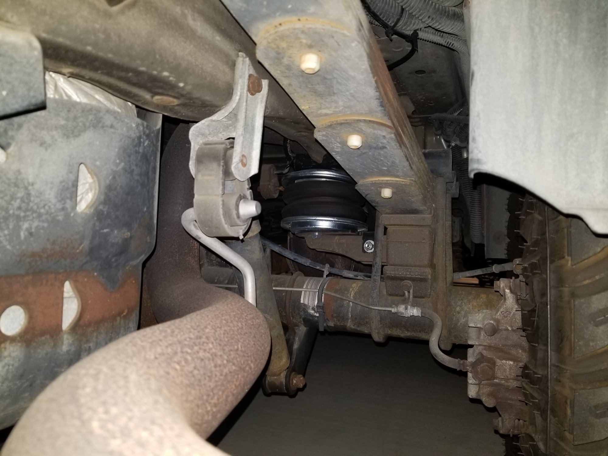

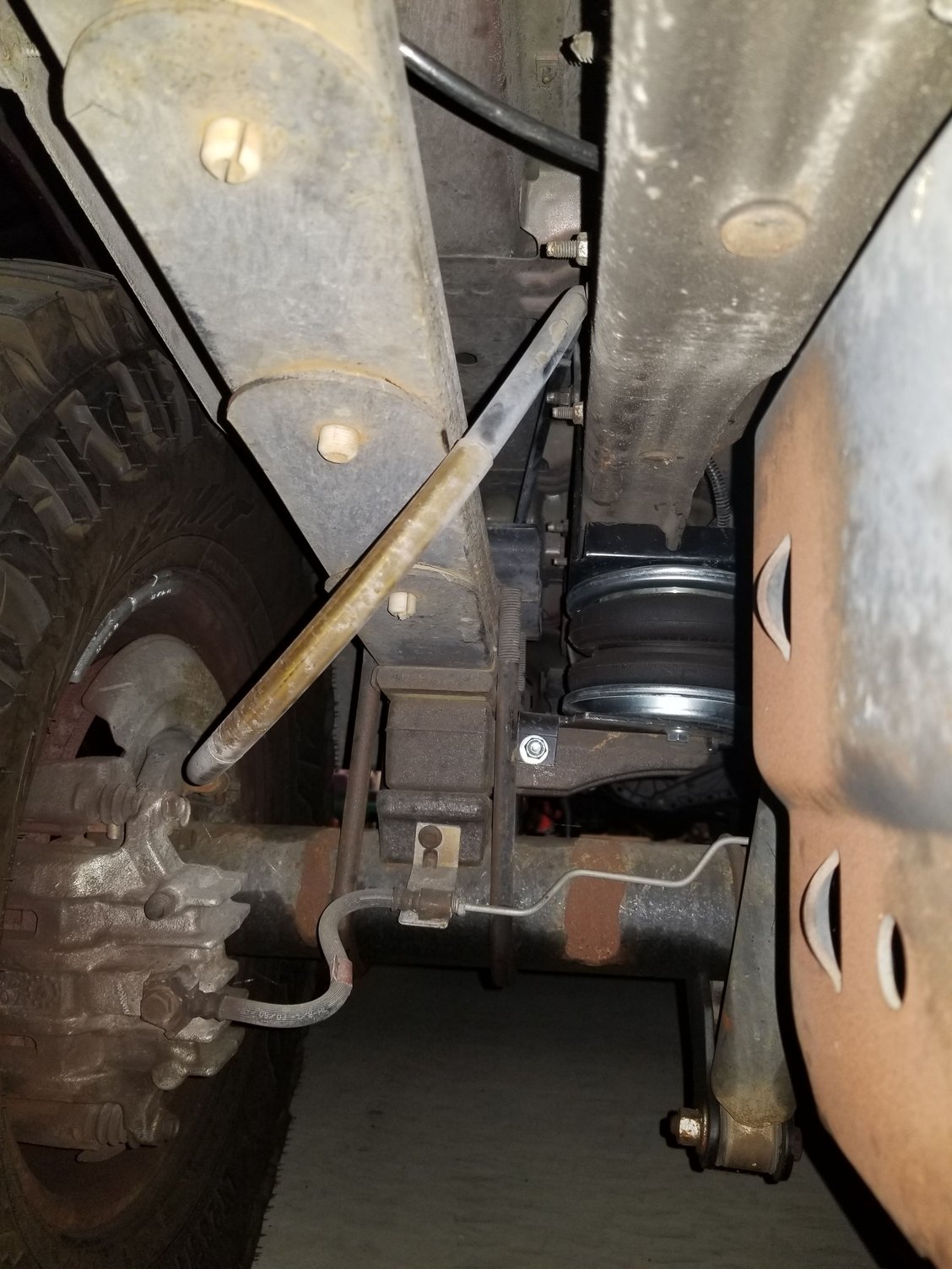

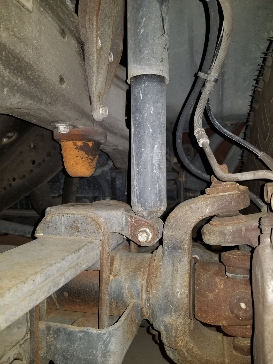

looks like your suspension is modded already so pics of the front and rear springs will also be required.
might as well post each of the 4 tire PSI and tire size and rating while we are at it

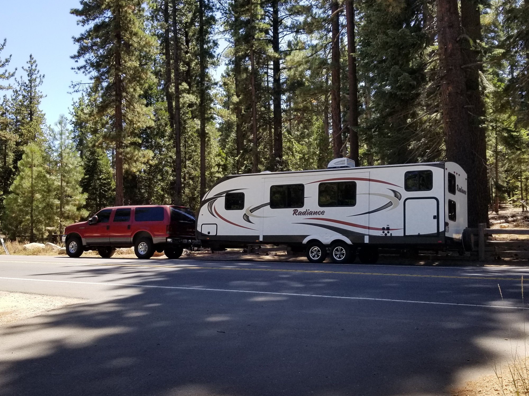

Blow up the pic of his setup, you can draw a line along along the bottom of the fender arches from the Ex front to the trailer rear and get a good idea of the weigh distribution, not the actual numbers but the actual results, from that you can see the issue isn't the front but the rear which would be influencing the caster. be great if we had caster and weights but from that pic and my experience Id say he is right at 3.25- 3.5* with that much air in his bags.
with bags it is helpful to raise initial caster to make up for not getting a caster gain from no rear sag as you get without bags. looks to me like the bags are over inflated snd he is running positive rake ( rear high )

FP & FD = 23.5"
RP & RD = 24.5"

Front PSI = 43.5
Rear PSI = 45.0

Front Driver side
Front Passenger side
Rear Passenger side
Rear Driver side

your springs and non towing ride height are dead on and the suspension looks nice and original.
in the pic you posted it looks like you have the air bags inflated do the rear is at least an inch higher the the front.
try this. when towing inflate the bags so the vehicle is level or 1/2” to 1” lower then the front
