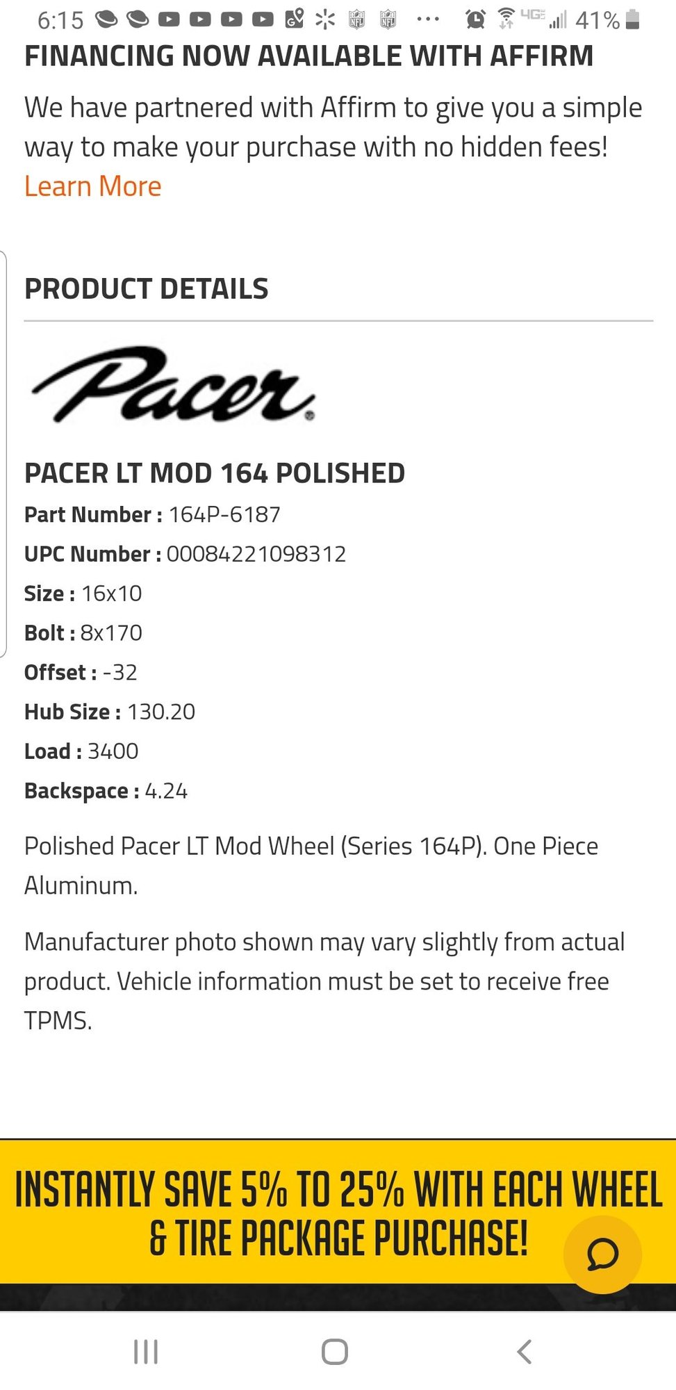

What kind of modifications are required if any when running 16x10 with -32 offset wheels on stock suspension with 265/75/16s? Also how far past the fenders are my tires going to stick out? know it shows a picture of a 5 bolt wheel but they are indeed 16x10 8x170 with -32 offset

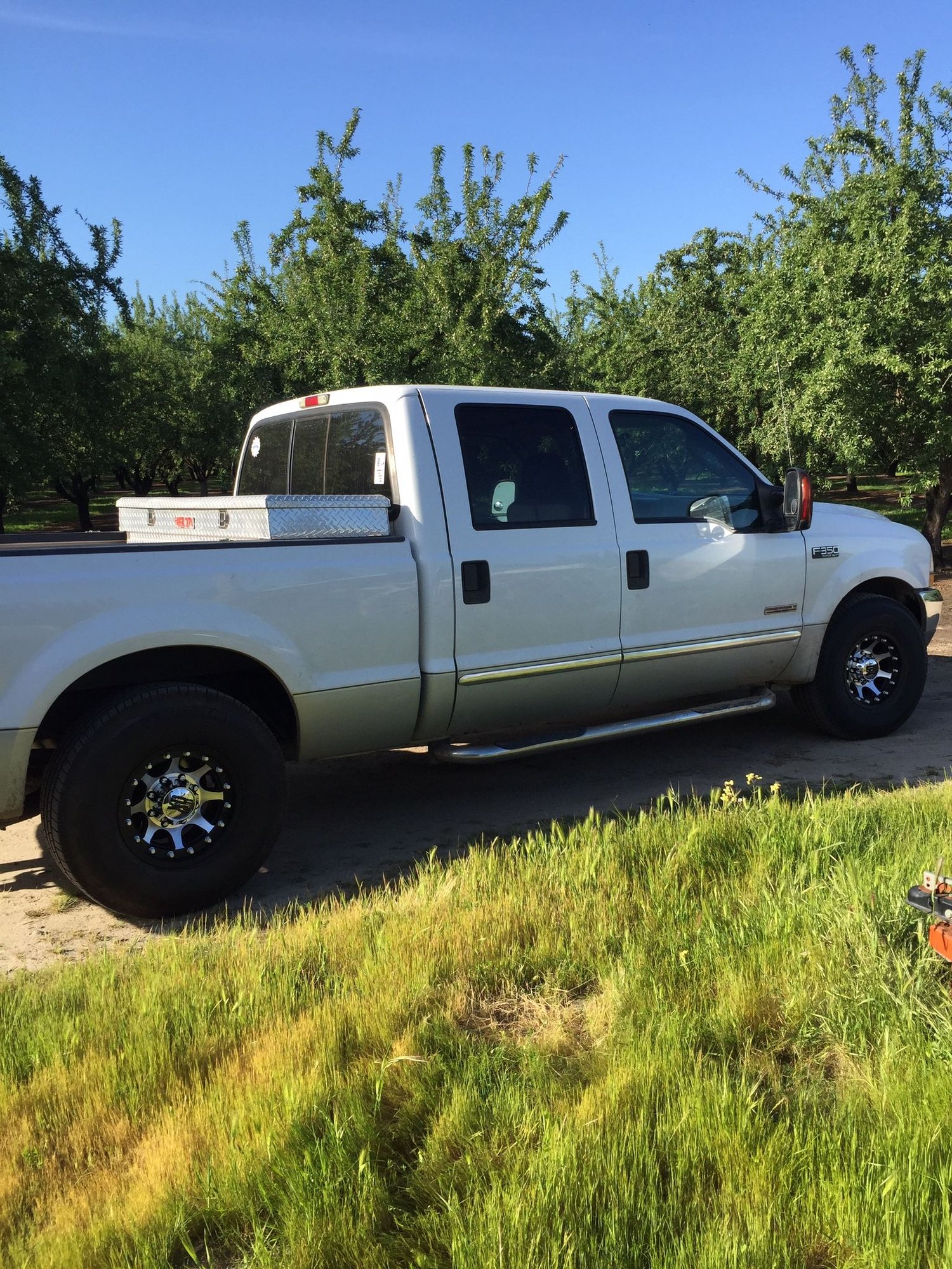

You’ll be fine , I have a Michelin 285/75/16 on , the Tire kind of balloons at first but wears in real nice , it brought the truck up a little for clearance .
