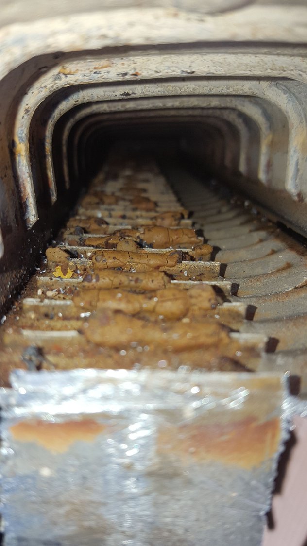

Well, I got the correct radiator last week and installed it without the t-stat. Filled it with water and radiator flush only. It's been driving just fine. I'll drain it this weekend and depending on how nasty it looks, I'll flush it again or fill it with coolant. Any recommended brands/types (green vs yellow)? I've dumped too much money into this pit, so I'm not spending $31/gal for Motorcraft.
BTW, I cut the old radiator in half and what I found was pretty nasty.
