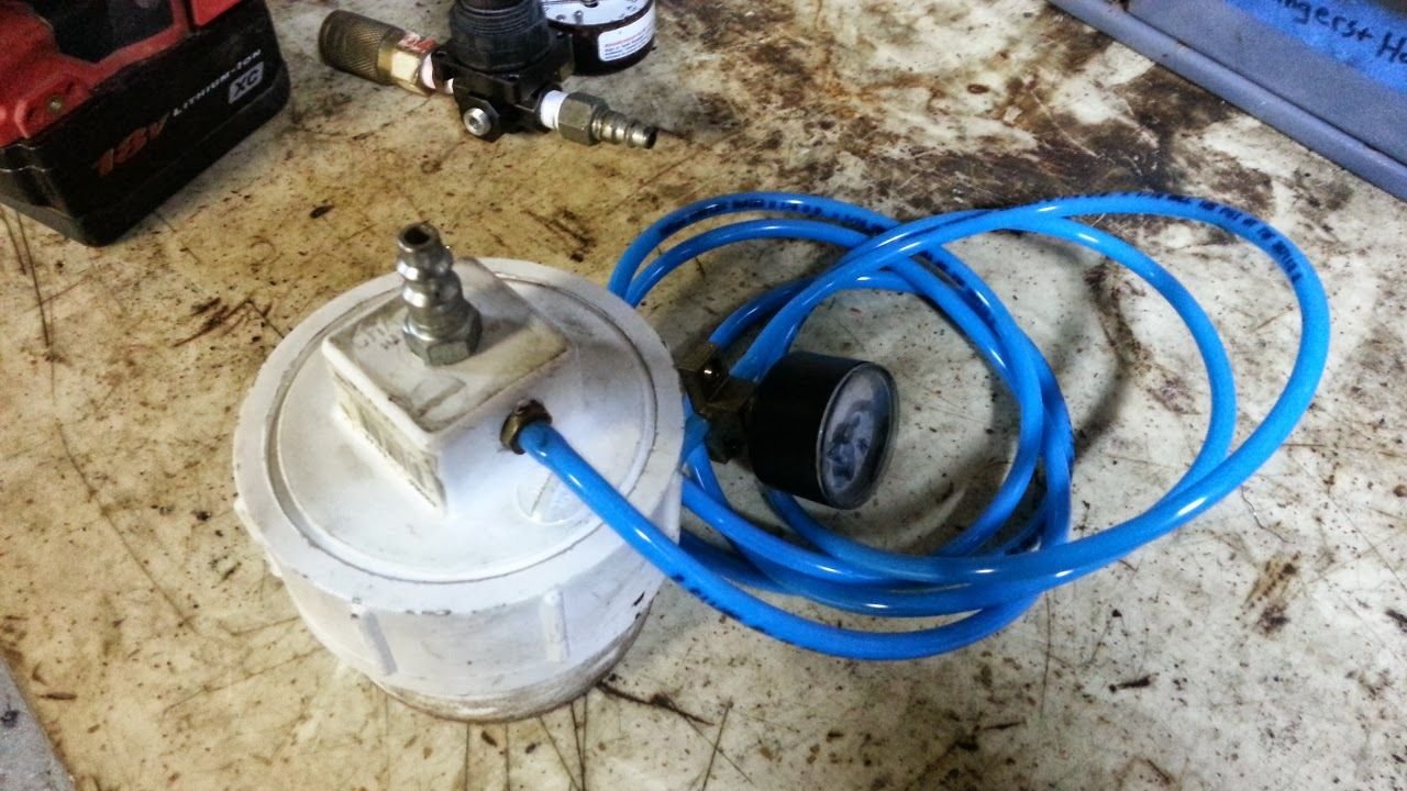

I think you need to pressure test the system installed in the van. I made a simple boost tester out of 4" PVC fittings that I clamp in place in the intake tube instead of the filter elbow and pressurize the whole system. It's easy to miss a misaligned boot or bad connection while your slipping it all together. It could also be the little o-ring on the V band seal between the collector and the turbo outlet - that one can be a bugger to keep in place while you're putting it all together. I just clamp this in place, install teh air hose (regulated to whatever pressure I want) and pressure the system up. You'll leak some air through the motor (open valves, etc) but it will build pressure so that you can spray soapy water onto the fittings and connections and see if you have a leak.
As for boost numbers, you won't see anything at idle, and little to nothing while you're free revving it up in the driveway. You kinda need to have a load on it to build boost, so who knows, it may also be that there is nothing wrong.
