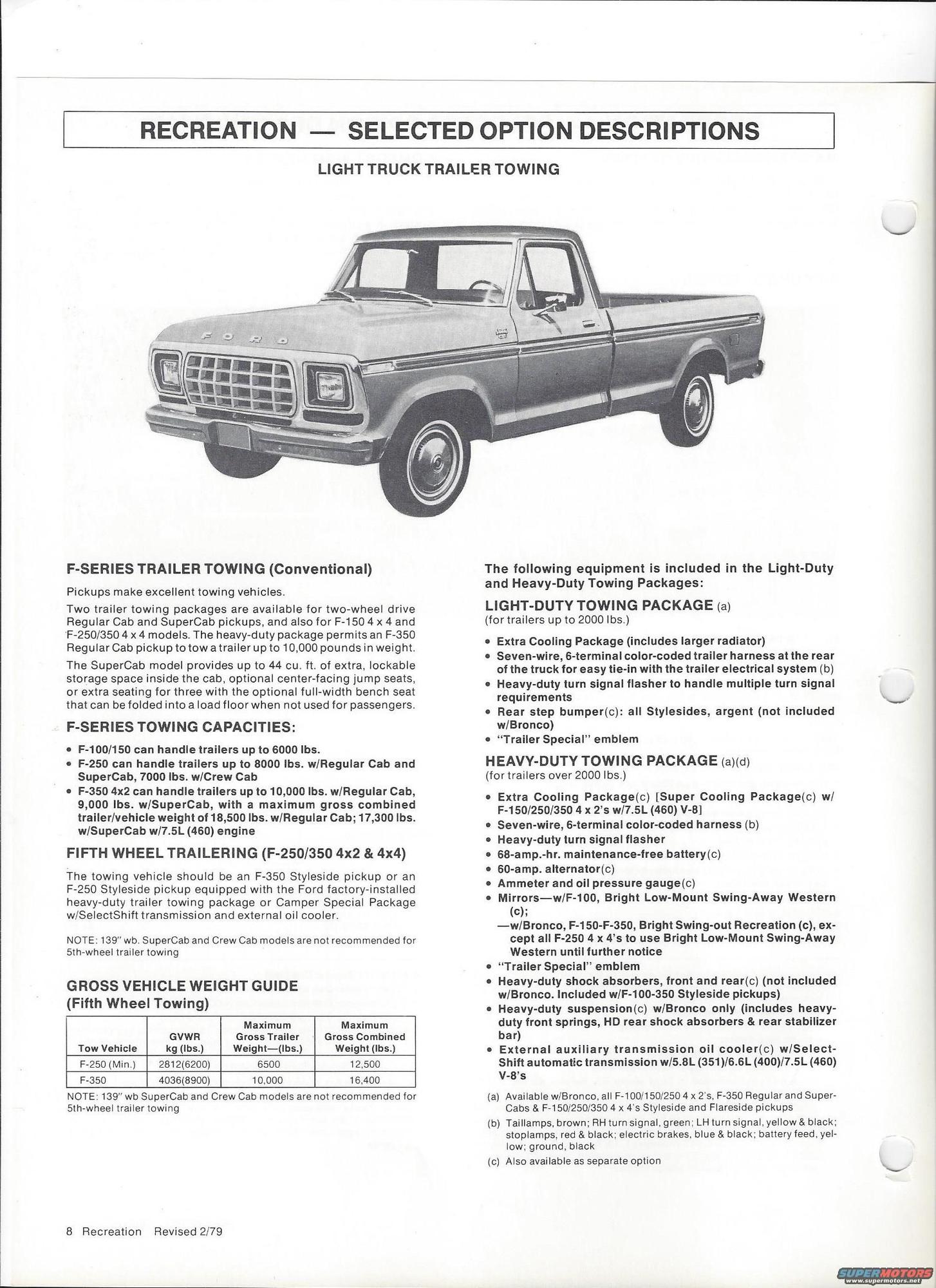

Well 100 square bales at an estimated 60 to 80 lbs a piece for roughly 6000 to 8000 lb. Or a Farmall H est weight 3875 lb is no slouch weight to be towing and do not forget to add in the trailer weight itself back there. I am sure your 1/2 ton feels it. Look at the above chart, you might be over loading the truck in the 1st place.
Remember that putting a trailer back there and then load it , and that shifts the weight to the rear axle and lifts or lightens up the front end weight. Therefore you feel it in the front steering and front braking ability.
Are you loading the trailer properly? Like most of the weight over the trailer axles? You could invest in some rear F250 springs, a rear sway bar, quality rear shocks. Maybe some over loads leaf springs too? Do you at least have a trailer with elec brakes and a brake controller in your truck? Might help some.
Remember that the 74 F100 had a GVWR X (see above chart for your wheel base)_ versus when the 1975 F-150 was introduced; this truck was designed with a heavier GVWR (over 6,000 lb (2,722 kg)) and maximum payload. Good read here and some discussion before it turns in to a bla bla bla.
