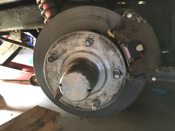

I have a 1953 F100 with a front disc brake conversion, but I have no idea where the hubs came from. Could someone please tell me how to repack the wheel bearings on this hub. Thanks.

You will need a face spanner wrench to unscrew the grease cap
Amazon Amazon
(make sure of the pin size) then remove the calipers, spindle nut, etc. Hub should slide right off.

After much trial and error, I determined that the "cap" is bolted to the hub with two small allen-head screws. I was reluctant to apply too much torque to the allen wrench for fear of stripping the heads of the screws. I applied heat - no better. I allowed it to cool - no better. Only when I decided that if all else failed, I would drill the allen head screws out with left-handed drill bits, did I apply enough torque to actually remove the allen-head screws. Then the "cap" could be pulled straight straight off. After removing the "cap" the rest of the procedure was the same as any other repack. Your answer about unscrewing the "cap" with a spanner was completely wrong. The "cap" does not unscrew from the hub!

Wow, you are literally looking at the hub and can't figure out how the cap comes off. Then you post a bad picture of the hub and ask for advice not mentioning the Allen head bolts. You get a recommendation that it may be screwed on. Then you mess with it and get it off which you could have done in the first place. Then you turn back to fte and bust the chops of the only guy who offered a reply? I will patiently be waiting for you to ask another question. Maybe your chops will get busted!

Had you provided a clearer close-up picture I'm sure it would have been very evident to the most casual observer. Actually, I did consider socket head capscrews but I thought I'd give the screw-on cap a shot
