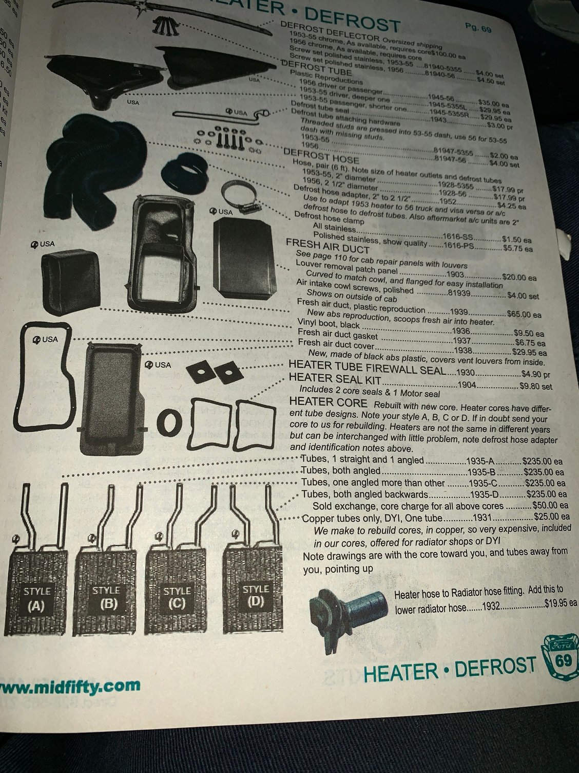

MidFifty $235!

Thanks guys I will avoid Mid Fifty unless as a last resort . Between the exchange and their shipping policies I would be getting close to $500 . I will see what my local guy can do first .

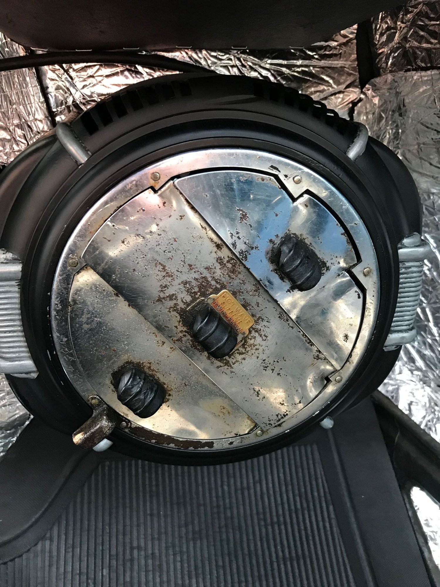

I found a new core from a Honda Civic fit, $28.

Wow what year of truck do you have and what heater ( mine is a fresh air ) and what year civic ?

Hot Wave heater, 15 Civic I think. I looked at several years for the closest fit
