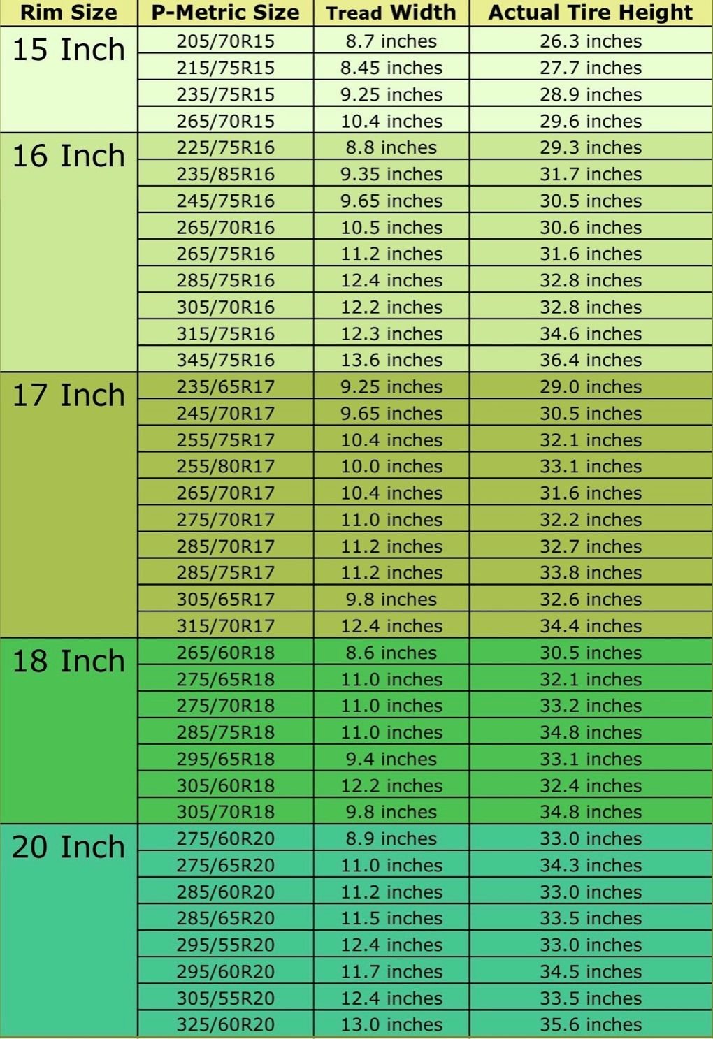

Don’t know if this will help you but it was in a thread I read a while back and thought it was pretty helpful.
