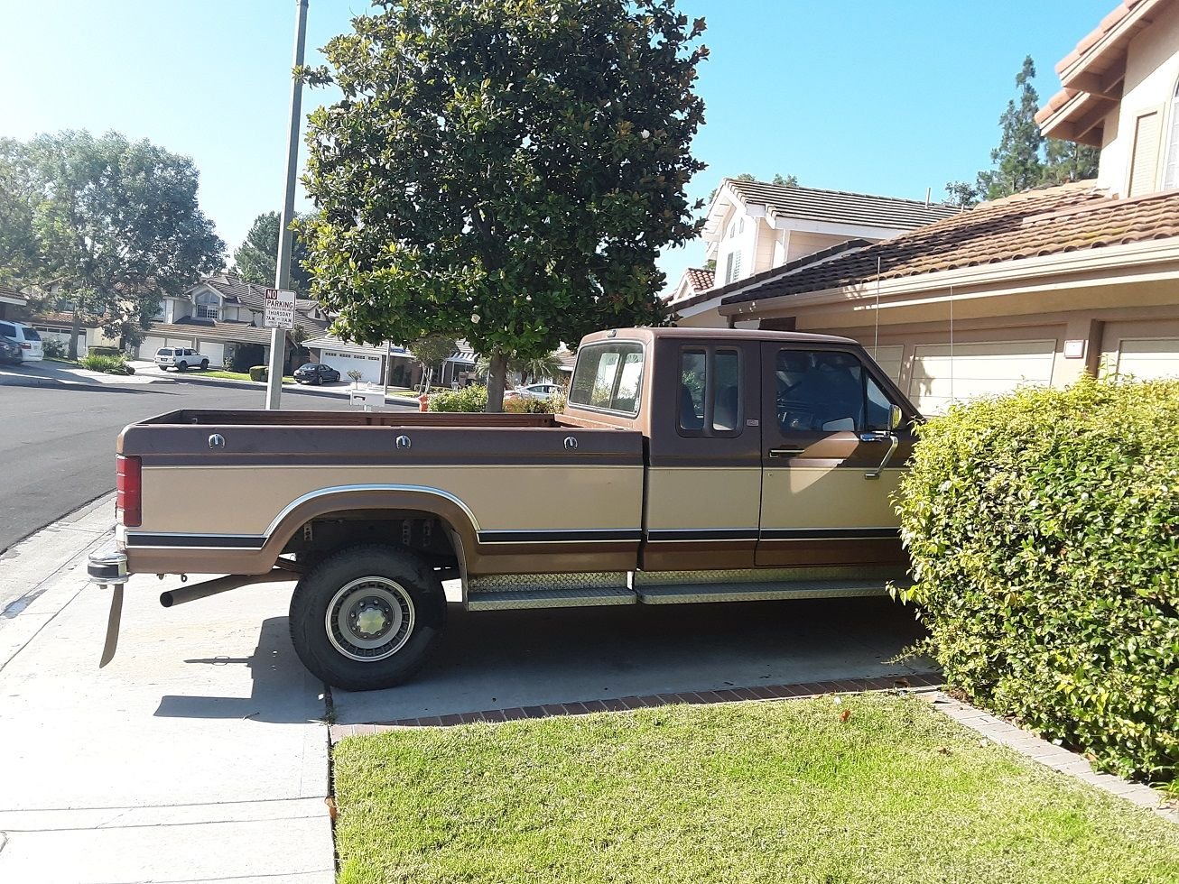

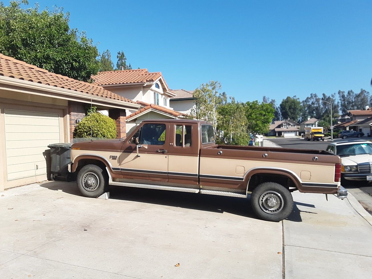

Thanks for the replies. Here are some pics of the truck. Not seen in the picture is the huge bumper winch which shows it's deep redneck heritage.

Nice clean looking truck, you did good. Looks like you are a Mercedes Diesel guy also?
As the herd gets thinned down you will find less and less of these trucks in the JY`s. We
are dry now as far as any Diesels in the yards around here in northern NV. When I do come
across one, I grab the IP`s and Injectors for cores, have a couple Intake manifolds. That wire
screen over the intake under the Air Cleaner, I grab those if in good shape. Might help keeping
nuts and bolts from being dropped down the intake. Those are NLA as far as I know.
Check the Bell housing for the Rubber Boot for the Clutch Fork. Those are NLA as far as I know.
I have found 2 good one`s.
If the Core Support is good, pull it. I have found one good one so far. When they have their 50%
sale I grab any good doors, Whole door for $25 - $30 with everything, can`t beat that. Finding a
good door not dented up from PNP by then moving them around with the Fork Lifts is difficult
some times as well as Fenders. Grab the Hinges with the door, if it is separate they will charge
for the Hinge. Just have to check PNP.com or row52.com for stuff coming in, row 52 when you
sign up, they will let you know what comes in via E-mail.
This your first Ford Diesel? More will follow you home. Can`t have too may parts or stuff.
Does it have a Goose neck Hitch or 5th Wheel set up? I see some brackets behind the R/R wheel
against the frame. I just removed mine so I can pull the bed for a 38 Gallon fuel tank install. One
bolt was so rusted going up through the bed I had to use a cutting torch to cut through the bracket
to get to the Bolt.
The way you are parked hanging over the Side Walk. my Bro in Law lived in Livermore, Ca. There
were some snooty neighbors on their daily afternoon walk, would turn any one in for blocking the SW.
And a ticket could be issued.
Happy Truckin.
Charlie
