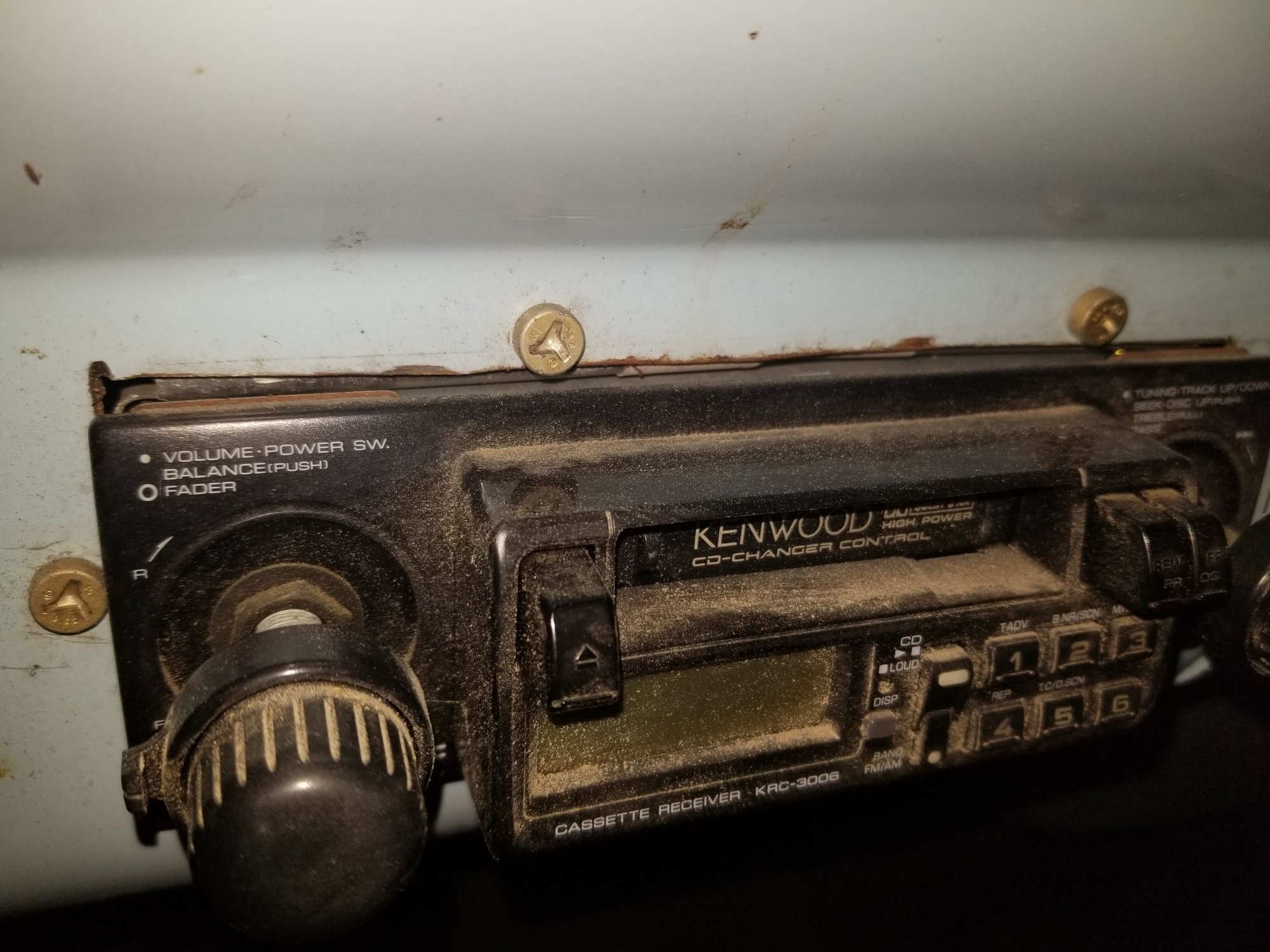

Thanks for pointing that out, that's something else I'll have to consider. Theres a small kenwood radio in there now, hopefully the last owner didnt cut the dash out for it and used the original holes, I'll need to check that out.

If there's a Kenwood in there it's cut. The stock radio uses some small holes that's it.

Dash has been cut for sure, see the 3 holes in the parts catalog pic where the face plate attached.
1964/66 F100/1100 radio same as 1966/77 Bronco. But Bronco's used a different speaker arrangement.

This is correct. The 'factory' radios used three approximately 1/2" holes on 3" centers.
I don't know how Ford handled radio installation when these trucks were new, i.e. were radios installed at the factory or were they supplied for the dealer to install? Perhaps NumberDummy can clarify. I do know if you purchased a new truck with no radio there were no holes in the dash from the factory. If you later went to the dealer and purchased a radio kit a drilling template was included.
I am not aware of any vintage am/fm radios that fit this three holes arrangement. There may have been contemporary am radios that did.

Dealers drilled the holes in the dash. The only available radio in the US was AM with no push buttons. Canadian assembled trucks used a totally different AM radio with push buttons.

Thanks everyone, this is why I really love this site. A small detail like the 3 stock holes is something i wouldve never thought of prior to purchasing a radio. Sometime I'll pull the old radio and see how bad it was butchered, and maybe I'll get lucky and still be able to make the stock radio work with what I've got. I'm going to try to pull the current radio this evening.

What a bummer.... finally got to look at it and the dash was definitely butchered pretty good to make the kenwood fit. Luckily everything else on the truck is in mostly great shape, but that still blows.
And I guess it does have a cassette player, dont know why I thought it didnt.

That really wouldn't be that terrible of a job to replace the steel. It would be worth it to me. Especially if you were putting a stock radio back in, it would pull your eye from any imperfections from the welding job.

True, that's hopefully what the plan is. I do have a leg up in that I work at a sheet metal shop and luckily know a few guys there who are damn good at welding. This ones going on the to-do list for sure.
