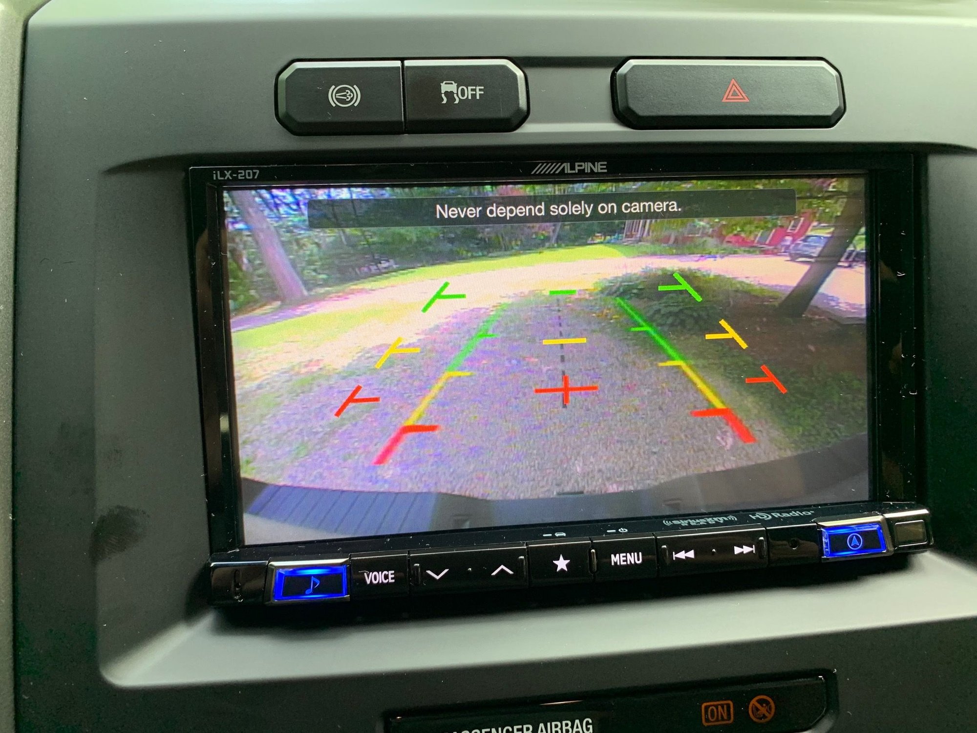

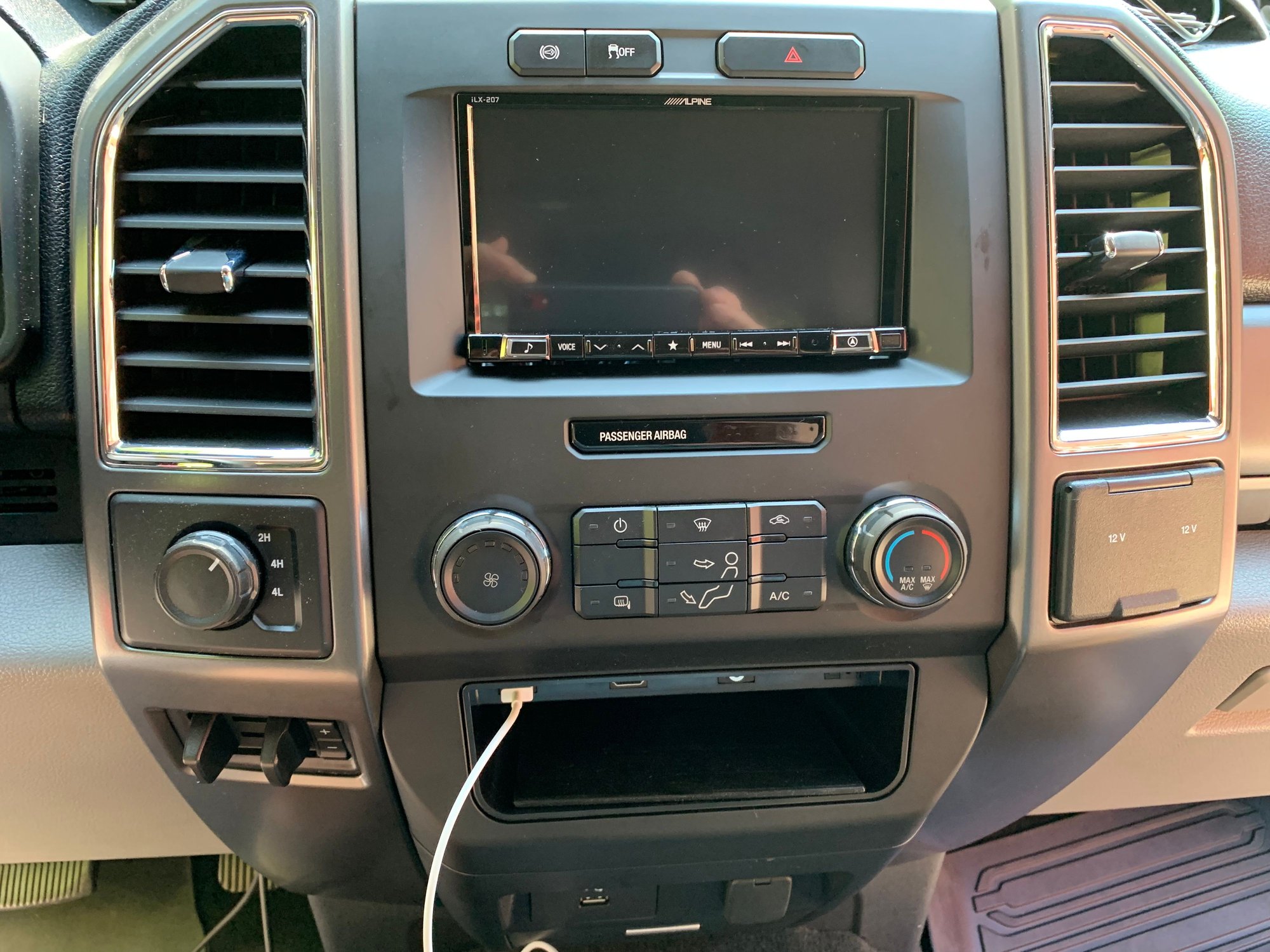

And suddenly my base XLT 6.7L is not so bad...

Originally Posted by HST
What did that cost? Mine is the base and I would love to upgrade but not if its too expensive.
I have around $850 in it - Alpine ILX-207, Alpine KTP-445A (amp), Maestro FTR1 dash kit, Maestro ADS-MMR interface, SXV300 Sirius XM, ant-sat1 adapter cable, fm adapter cable. Speakers & Subwoofer will come later, but it sounds great now and very happy so far. I bought parts over 4-months and finally spent the time prepping the cabling (probably 4 hours) and installing (another 4 hours). The camera did not work and was troubleshooting that until i checked settings and found it was off by default.
Old Aug 11, 2019 | 09:51 AM
pickncrew's Avatar
pickncrew
Joined: Oct 2007
Posts: 211
Originally Posted by edjunior
Is that fully integrated with Sync?
Yes, check out the maestro sight and enter truck and it will tell you what it is compatible with. When you install the ADS-MRR interface you program it to either work with sync and no sync.

Couple more pics -
