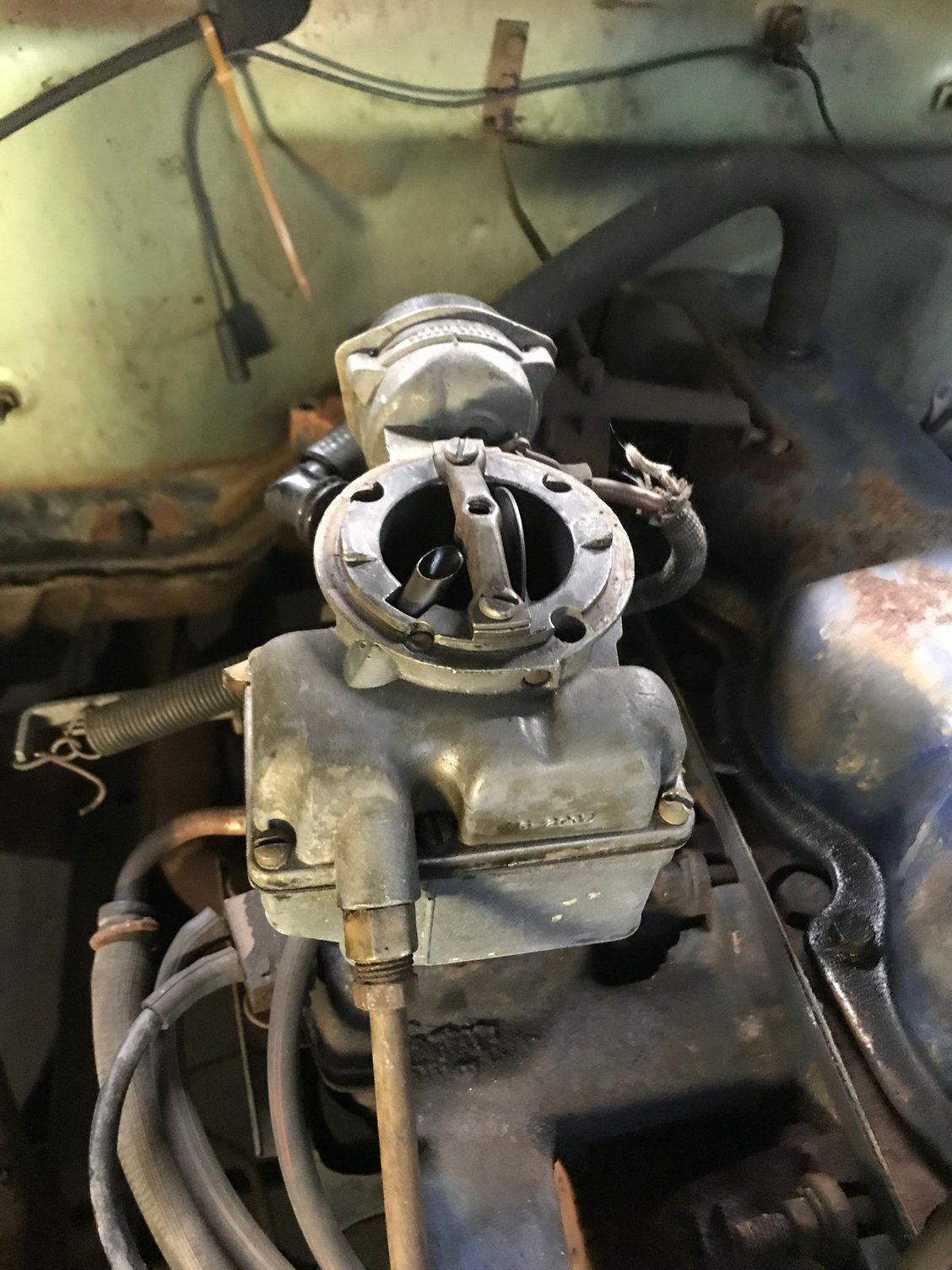

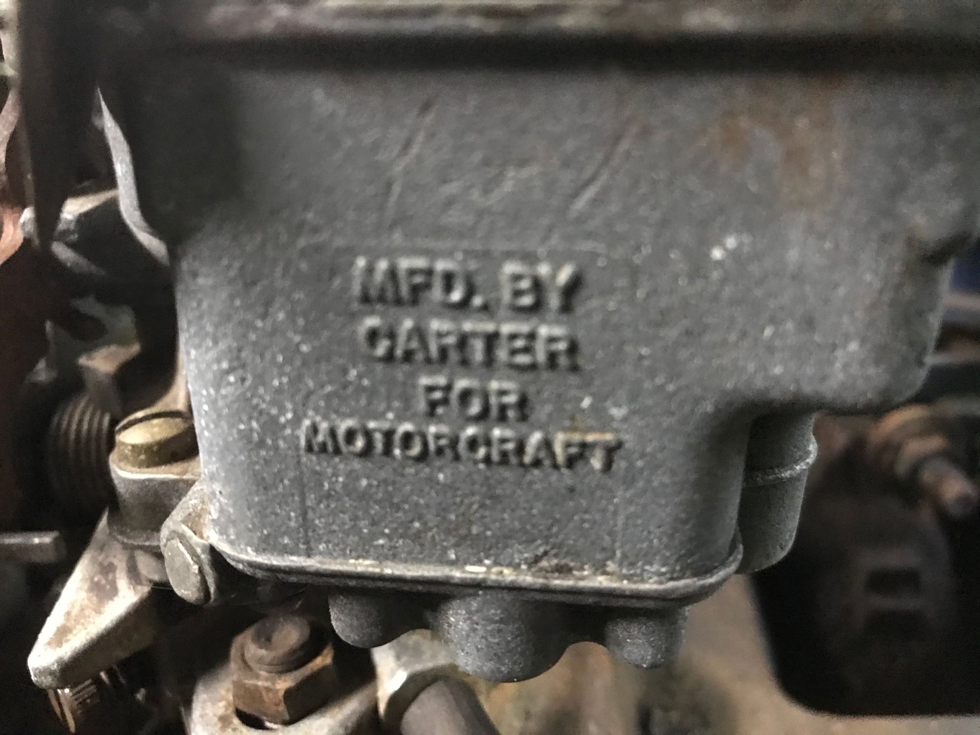

Sorry if this has been posted but I’m new to the page and need some help. I’ve got a 71 with a 240, original cater carb. It’s just been rebuilt and runs good. After driving it a while and it sits for about 30min it’s really hard to start. I’ve got to pump the pedal several times and then it runs. After it starts I can cut it off and it will start right up every time, but when it sits for a bit I have a hard time starting it again. Any help would be great.
Carter carb single barrel
work that has been done:
new carb rebuild kit
new fuel pump and filter

Welcome to the forums. Sounds like it is heat soaking and boiling the gas out of the carb. Typical on these old trucks.
The second issue could be from a float level just a bit too high. When it shuts off, it dribbles fuel and floods the engine.
Remove the air cleaner and when you shut if off(after a long drive), watch to see if you see a light fog coming from the carb. That would be fuel dribbling down into the hot engine. Try adjusting the float down just a touch.
The heat soak issue is a bit harder to fix. A heat isolation spacer under the carb would help keep it cooler. Maybe have just put an electric fuel pump on the truck to reprime the carb before a hot restart.
