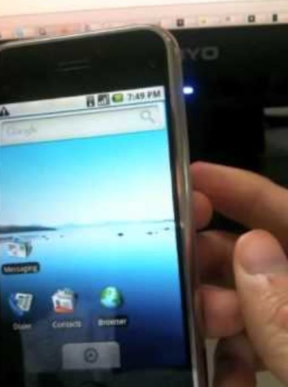

Have Samsung s9 (android). Old job gave me a iPhone once years ago, and plugged it in computer and reprogrammed android on it as its OS lol.
