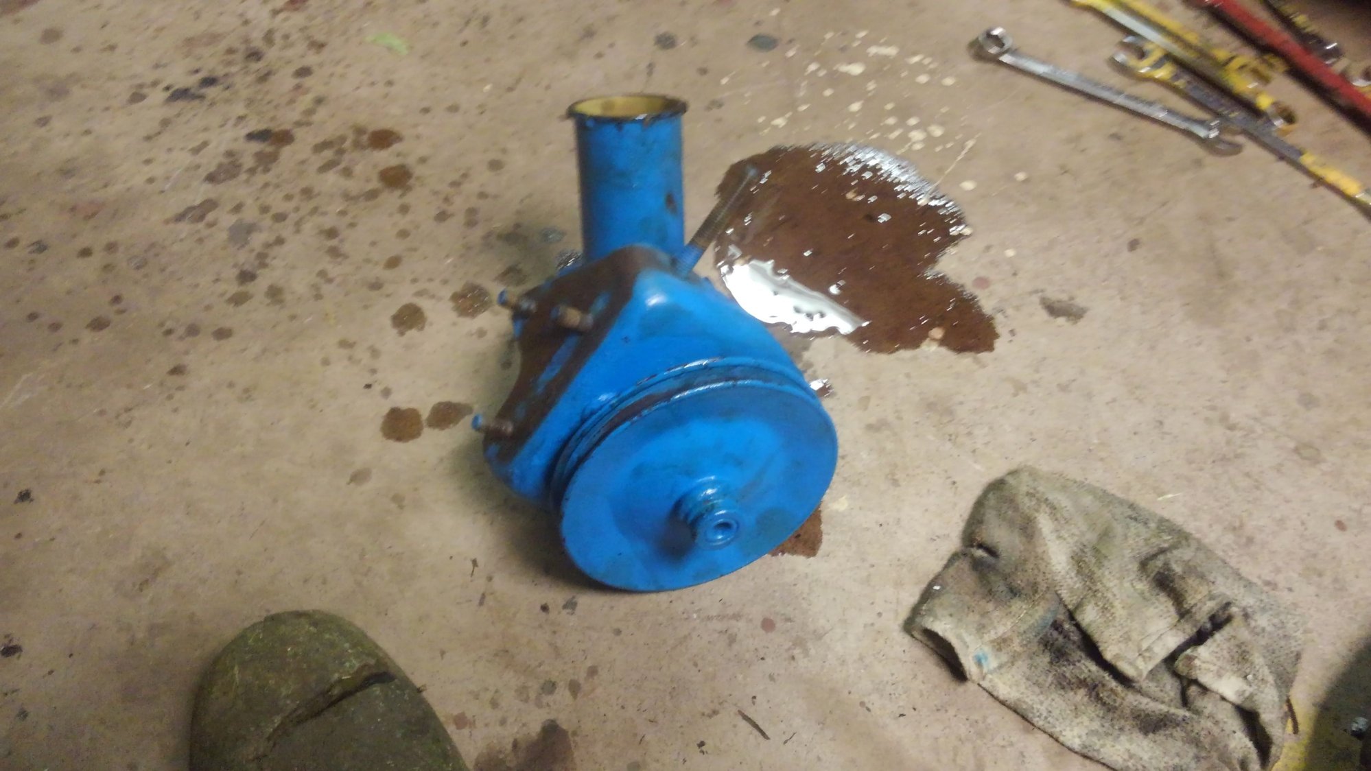

What's the trick to removing the power steering pump pulley?
78 f250 4x4 400.

Rent or borrow tool from parts store if you don't plan on ding several. Works great.

Make sure when you put the pulley back on the new pump, that you don't put it on backwards like I did. Still works, but it is gonna be a PITA when and if I have to pull it again.
It will probably help to put the pump back into the bracket when pulling it off.
