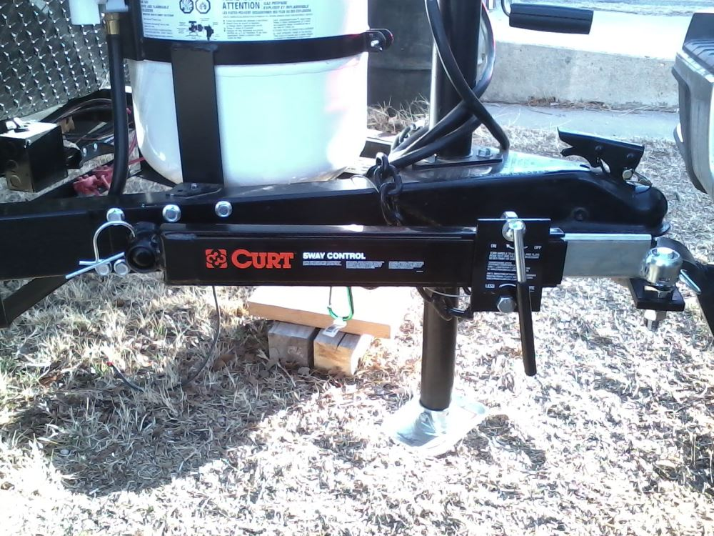

You can buy a friction style sway control and use it on any hitch. As long as it has the little ball on it. Just have the ball mount installed on each receiver for each truck(or do you use the same receiver?).
If it's nose heavy, then a WD hitch is needed. The sway control can still be used.

I looked at your hitch online. There are a few variations. I think yours uses pins for height adjustment?
If you use bolts, you could have a plate made to match your hole pattern, then have the ball mount welded to it and use the friction control. Just a thought.
