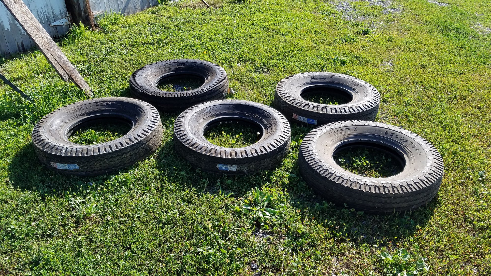

Hi Eric, I already have 5 NOS tires I want to use on my truck. I have 16s on it now, that's what it came with, with snow grips. But they are a bit cracked and not safe for the highway, but will be fine around the place in the winter for plowing. I would rather find another set of rims for my "summer" tires!

Nice set of Firestone Transport 110s. And a Goodyear spare. Period correct. Stu

Yeah, those are cool tires. Firestone must have sold a million of those.
