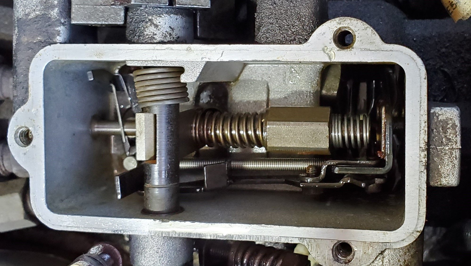

After Covid and 2 cycles of “C” I got back in my 91 F250 Banks turbo (no waste gate), e-pump. This started out as see post #1 on my last outing, now, no start. Fuel to pump, yes, but nothing when repeated cranking with loosened injector tops.
The FSS didn’t sound to healthy cycling the connector, so I pulled the cover and I discovered what appeared to be a Petri dish run amuck! The slide bar was frozen closed, nothing moved. I started with Brake clean, then penetrating spray following with a week of transmission fluid soak. With everything freed up I installed a new FSS
Couldn’t find much, but did over at here. “Diesel bug is a general term for a host of fungi, bacteria and yeasts ready and willing to inhabit your tank, whether by transfer from infected fuel or by colonization from airborne spores. Around 147 species have been identified living in infected non-bio diesel fuel, but the new fuels bring a whole host of new organisms to join the party – over 1,400 at the last count
I shocked both tanks with BioKleen.
How long has this been going on? I purchased this vehicle in 1991…😊 and have never open the cover. The big question is, what is this? And what the best magic formula to rid my vehicle of this plague. I did change my rear tank back in 2019, so the front is suspect. Killem has been recommended somewhere on this site.
Jammed open
working

In retrospect, 2 years sitting in storage has allowed one or more of the 1400 variants of bugs (fungi, bacteria and yeasts)to be allowed to grow in the fuel system and stick the upper linkage in the "off" or deenergized position. Checking the main solenoid did make noise, but it was not crisp sounding.
Cleaning out the top (see thread #12) freed up the mechanism and after burping the system it started right up, with a few minutes of surging. Started up with zero glow plugs. Of course its 90 degrees here this morning.
I still probably have something growing in my front tank. Will try more shocking treatments and home testing for growth, before replacing 33 year old tank..
Use it and save yourself grief. I wonder how many other "no starts" have this same symptom and fix??
