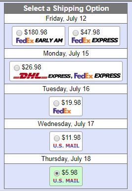

Well, I wuzgunna order them parts, until I saw how slow and expensive RockAuto would be to deliver them.
Dang, 8 days!
Dang, 8 days!
yeah good prices but their shipping does suck, and one Issue I have is that when I want to order more than 1 Item the 2nd or 3rd item is never in the same Whse so it makes for additional Shipping... sometimes I think they are Scammerz... but I do order a lot from them and most the time with USPS shipping it's pretty quick even if they say 8 days I often get parts within 3 or 4 days...... YMMV
I'm on a fixed income so I gotta save pennies when I can and I would rather buy the same stuff from RA than get Raped by Autozone or OH Really even IF I have to wait
